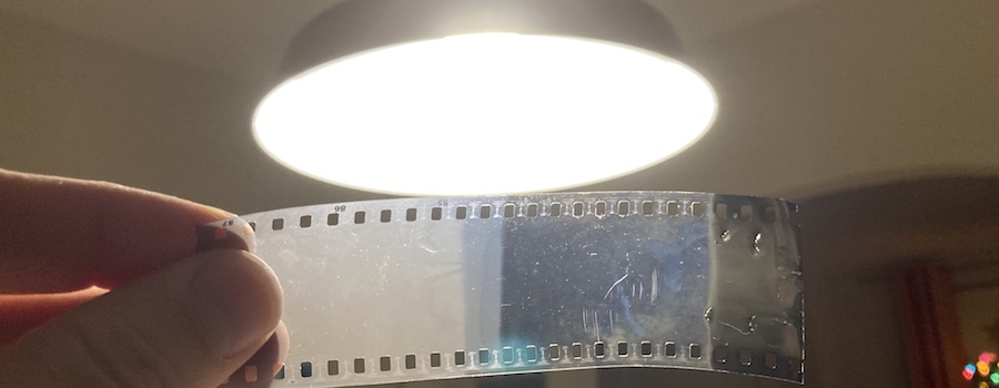

What I got was a milky cream color of somewhat uneven looking distribution. I can see there was a fingerprint on the emulsion that prevented bleaching that section from working as well. I then put it into some fixer and it cleared down almost completely. However it left a brown stain. So the staining has nothing to do with the second developer.
The pH is still alkaline, I don't have a meter so I don't know what the pH is. But it still feels slimy to the touch, so I guess above 9 somewhere.

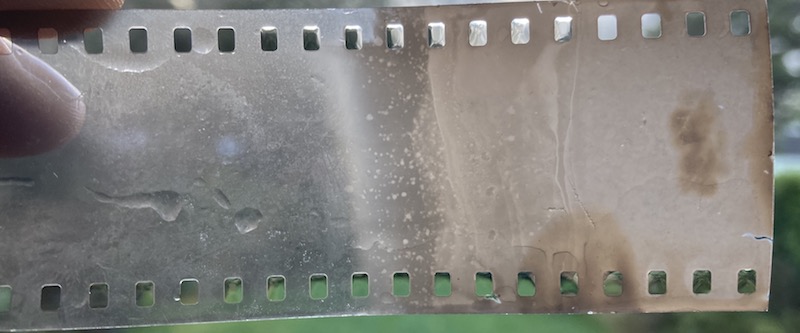

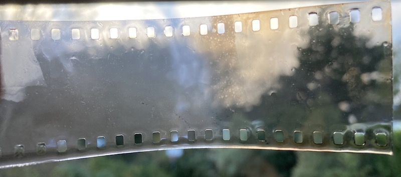

Here's what I got. The right hand side is the bleached part. First pic is before fixer, second is after fixer. The mottling is at the border of where it was immersed and that part wasn't fully immersed.
This of course doesn't prove it's going to work for a whole roll of film, or frankly if it will work in a sealed tank. I suspect not. But it might work.

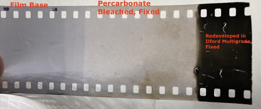

Thanks for the good info. Well, that film was completely black and at 120 degrees F it was able to clear it entirely. I assume, hopefully correctly, that there is no other active ingredient doing the bleaching. Isn't its ability to fully bleach out a fully black section of film evidence that it is strong enough? It seems to work exceedingly well in my experiments. Here's another section of film, run in a completely newly mixed setup as I described above. Starting temperature 120F, no attempt to maintain temperature. Ending temperature 108F.

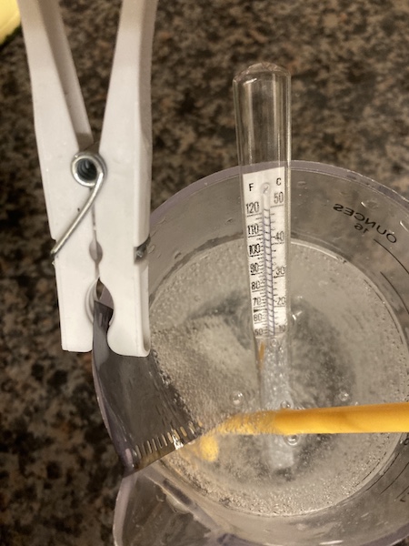

Here's the setup:
After 20 minutes of bleaching this is what I get:
I then redeveloped the tip of the film in paper strength Ilford Multigrade developer and it reblackened down fully. All of the film was then fixed. This is what I got (sorry for the different lighting. Compare film bases here):
Keep in mind that this is the end of a previously developed film and so the end of it is pretty beaten up from handling and having been in a waste basket for awhile. You can see at least one of my fingerprints. The brown stain is definitely not that bad and I think actually might be kind of nice in slides. Having now experimented with this a bit, I am starting to think that the stain is actually silver oxide. If that's right, then it seems to me (I'm not a chemist!) that the free silver being broken down from the halides by the peroxide is recombining with the peroxide to form silver oxide. If that's right, then it seems to mean that I need to add more vinegar to start with, to hopefully occupy more of the free silver before it can react with the peroxide.
Additional notes from further experimentation
  1. DO NOT AGITATE This really seems to reduce the bleaching
  2. Insert the film more or less right away. Do not wait for the bubbling to stop. It seems most active at the beginning and all other factors unchanged, waiting a couple of minutes makes it not work as well.
  3. Make sure the vinegar is mixed and all the stain remover is mixed in. It can be hard to see because of all the bubbles.
  4. The film will cover in bubbles. Do not attempt to remove them, they seem to be a good thing. Agitation or rubbing with a stir stick to remove bubbles seems to reduce bleaching.
