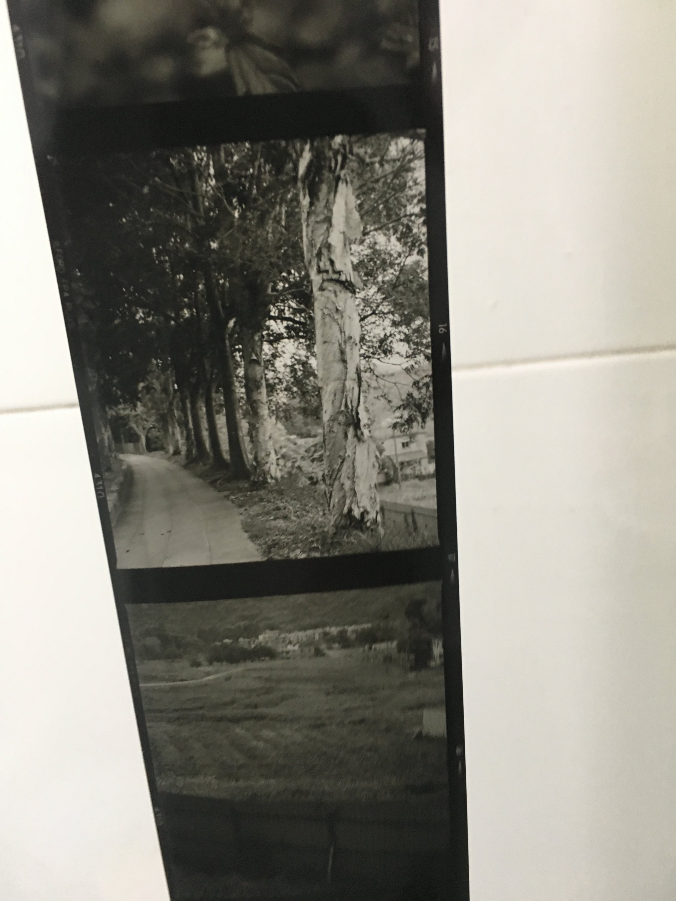

I have had success with 3% hydrogen peroxide bleach with citric acid and silver nitrate added. But it works at 38C IIRC.

Very interesting and thanks for the insightful clarification. Interestingly, when using copper sulphate bleach in reversal, we get into a very similar situation. After the bleach step, there are two silver salts in the film - undeveloped silver bromide and rehalogenated silver as silver chloride. In a separate step, similar to the nitric acid step you suggested for peroxide bleach, the bleached film is treated with 2% ammonia solution to fix out the chloride. The fixing step leverages the fact that silver chloride is significantly more soluble than silver bromide in dilute ammonia solutions. In case of peroxide bleach, a short bath in dilute thiosulphate might do the trick as you said though it might also remove some detail in the highlights. I've used copper sulphate bleach on several films after learning about its use in reversal processing from @Athiril and it works quite well except that it is very slow at room temperature.
This is worth a shot... @falotico, thanks for the idea. I may try a very, very dilute mix, e.g. 1g/L sodium thiosulfate and see what happens.
