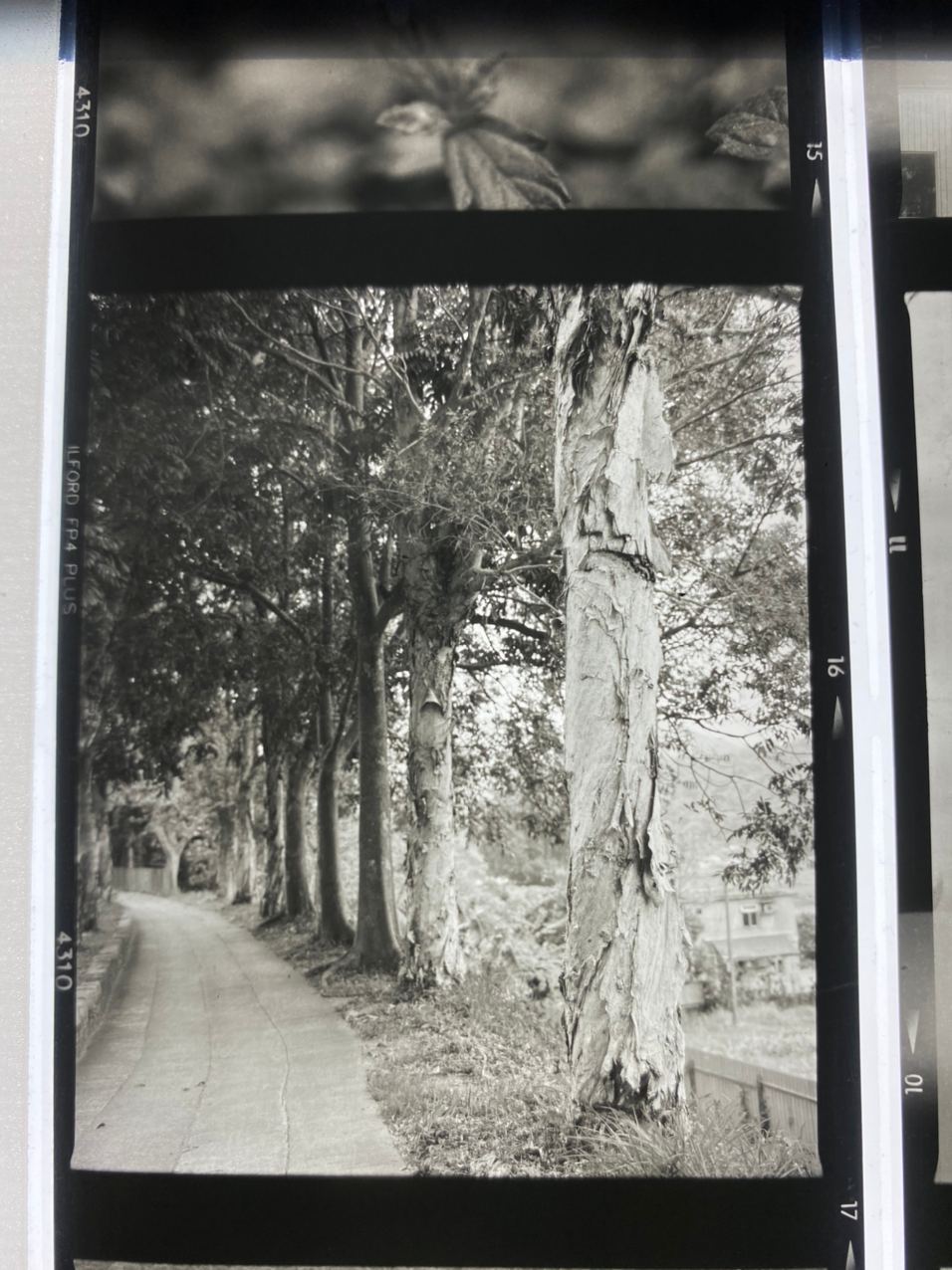

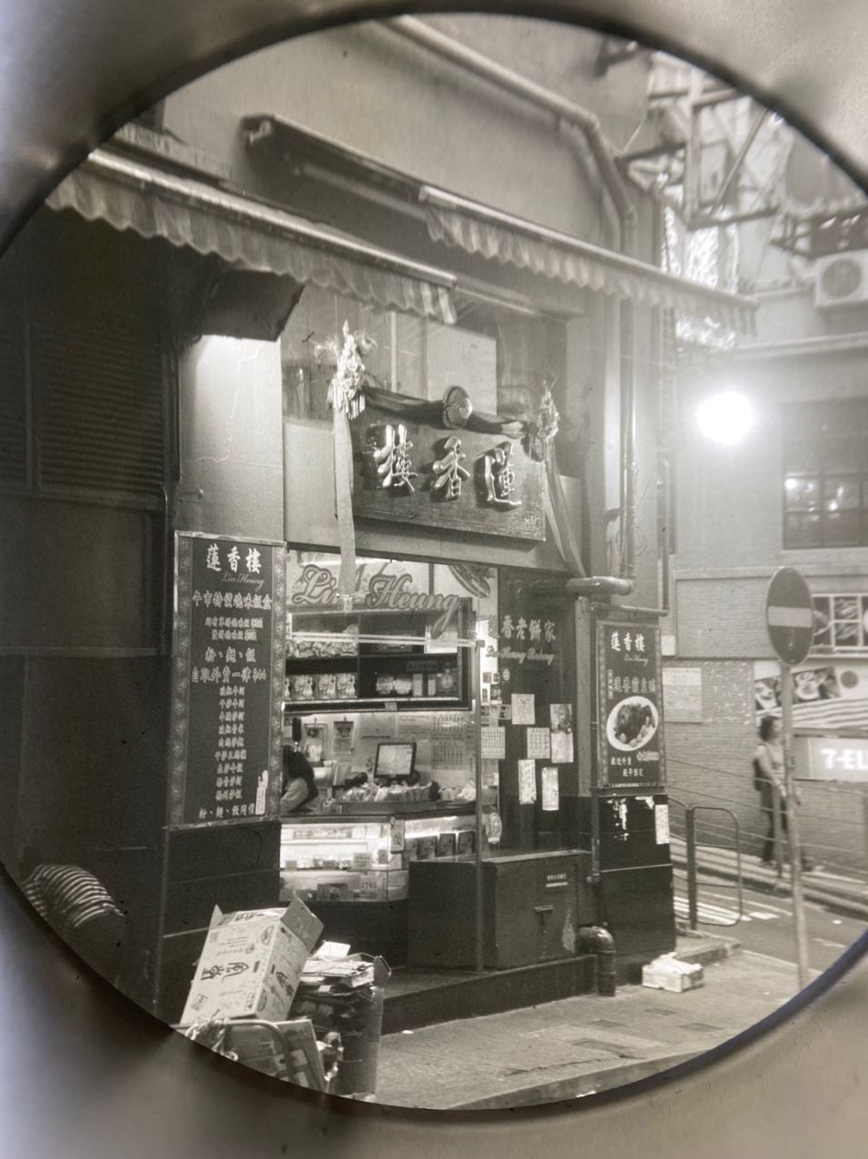

I checked my reversal and apparently there is only minimal staining and emulsion damage. Beginner's luck maybe :whistling:
It's getting hard to buy hydrogen peroxide here in Hong Kong. Maybe I will get some percarbonate detergent to try instead.
Those look great. That stain color is much better than the sort of green/yellow I am seeing. I would be fine with that! I've started to wonder if what I am seeing is chromium getting stripped off my Nikor 35mm film reels. They appear not to be stainless. That might be why I didn't see it at first.

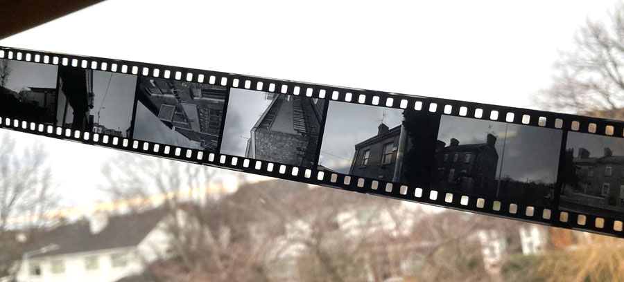

Well, Fomapan 400 works really, really well with this bleach. My daughter shot a roll yesterday and we developed it as a reversal. Here's the results. This is a gray as heck Irish morning in January, so keep in mind the backlight from the sky is pretty minimal. But I put it up there with a color backdrop to show that we got no staining, very good highlights, and very good blacks.
This is:
  • Fomapan 400 at EI400
  • First developer: Ilford Multigrade 1+5, no solvent, 12 minutes @ 20C
  • Second developer: Ilford Multigrade 1+9, 8 minutes @ 20C
  • Bleach: Week old bleach 300ml/21ml, 4 mins @ 40C
Another weird thing to report: After sitting in the window for 2 days, because I left it hanging to dry and was annoyed and didn't take it down, the ADOX Silvermax has _lost_ the staining. I don't know if it was the heat from the radiator, the UV light or what. I've now hung another stained roll there to see what happens.

Hey they look really nice! Yea I noticed Fomapan 400 works great for reversal processing when I was using a depleted Microphen to optimize a reversal protocol. I'm glad you got the peroxide bleach to work. Would be interested to see how other films behave (i.e. Tmax, TriX, Rollei, etc). I would stick to your current method and just change the film stock as the only parameter. Obviously this is only a suggestion, so please proceed if you have time/and are interested in testing it.
Thanks! Yes, this film works super well.
