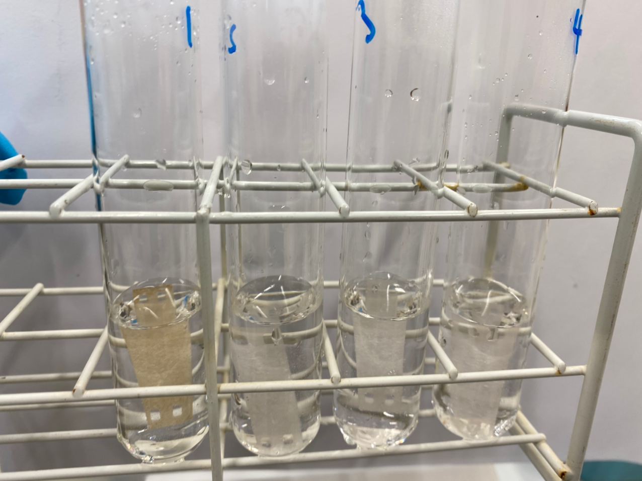

Some update on my EDTA experiment:
I added various amount of EDTA to the phthalate-peroxide bleach. Interestingly this seemed to increase the rate of bleaching and reduce staining. Blistering is also reduced.
Here is the formula I used:
Hydrogen peroxide (35%) 95.2ml/L
Potassium hydrogen phthalate 7.15g/L
I split the bleach in four and added EDTA disodium dihydrate to reach following concentrations.
1. 0g/L
2. 0.55g/L
3. 1.1g/L
4. 2.2g/L
pH was adjusted with NaOH to pH5
I developed a piece of Lucky SHD 100 in HC110 with sodium carbonate added. Bleached the developed film for 10 minutes at 38C. Fixed in flexicolor fixer and then washed and dried.

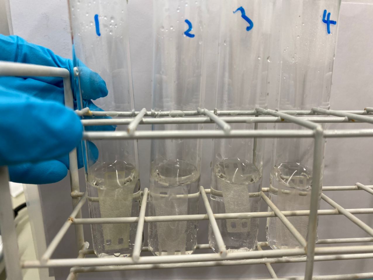

This is how they looked after bleaching for 5 minutes.
And this is how they looked after bleaching for 10 minutes.

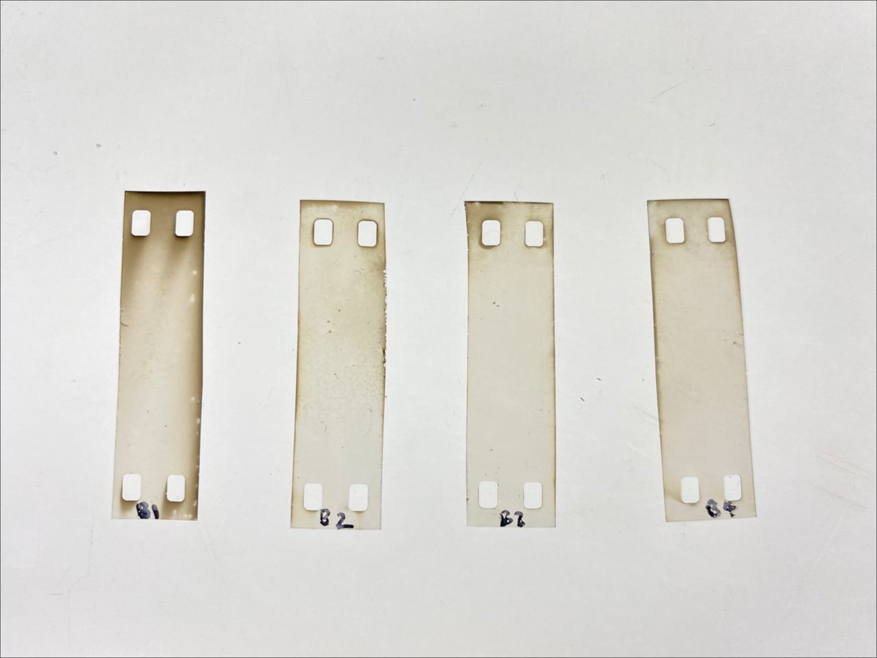

This is how they looked after fixing and drying.
Interesting results! Looks like the ugly brown stain was also cut down by the addition of EDTA. Last strip, one that used highest amount of EDTA in your experiments, looks the cleanest.
Also interesting is the role played by PHP. Apart from acting as a pH buffering agent, is it also working as a stabilizer for peroxide?
I see some stain-reducing effect of EDTA on acetic acid-peroxide bleach too. Hopefully we can formulate some usable peroxide bleach with EDTA or HEDP.:D

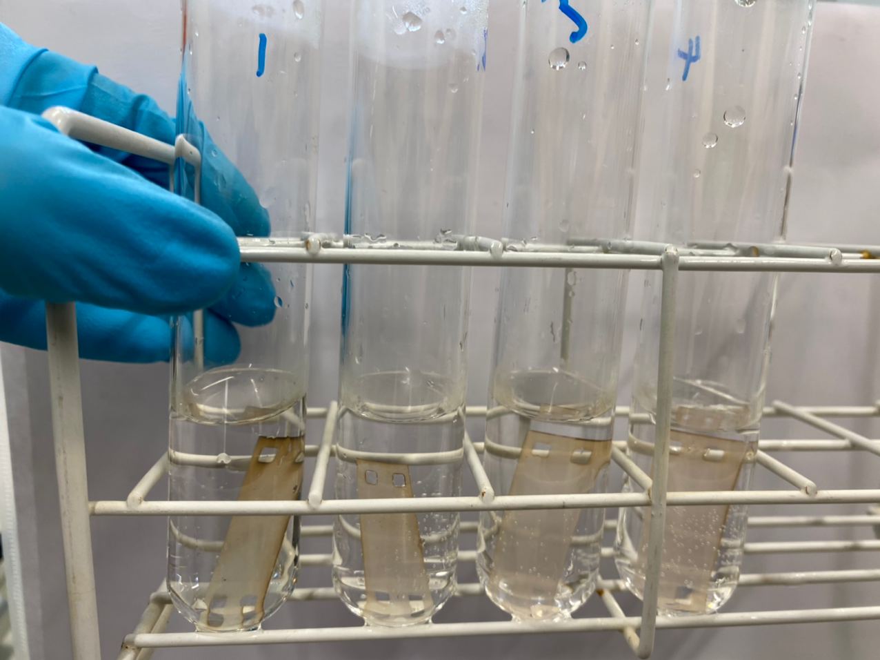

This formula works much slower, probably due to lower hydrogen peroxide concentration. This is how the film looked after 5 minutes of bleaching
After 10 minutes
After 20 minutes

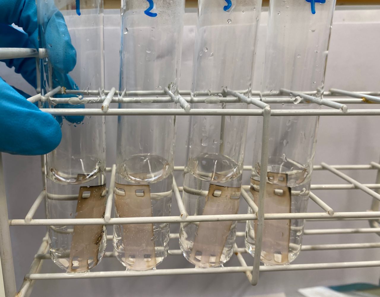

I stopped the bleaching at 20 minutes. The film was fixed, washed and dried. Brown stain was observed on all film strips.
They look really bad and I tried increasing the peroxide concentration to 3%. The result is much better in term of staining. I will post the result later this afternoon.

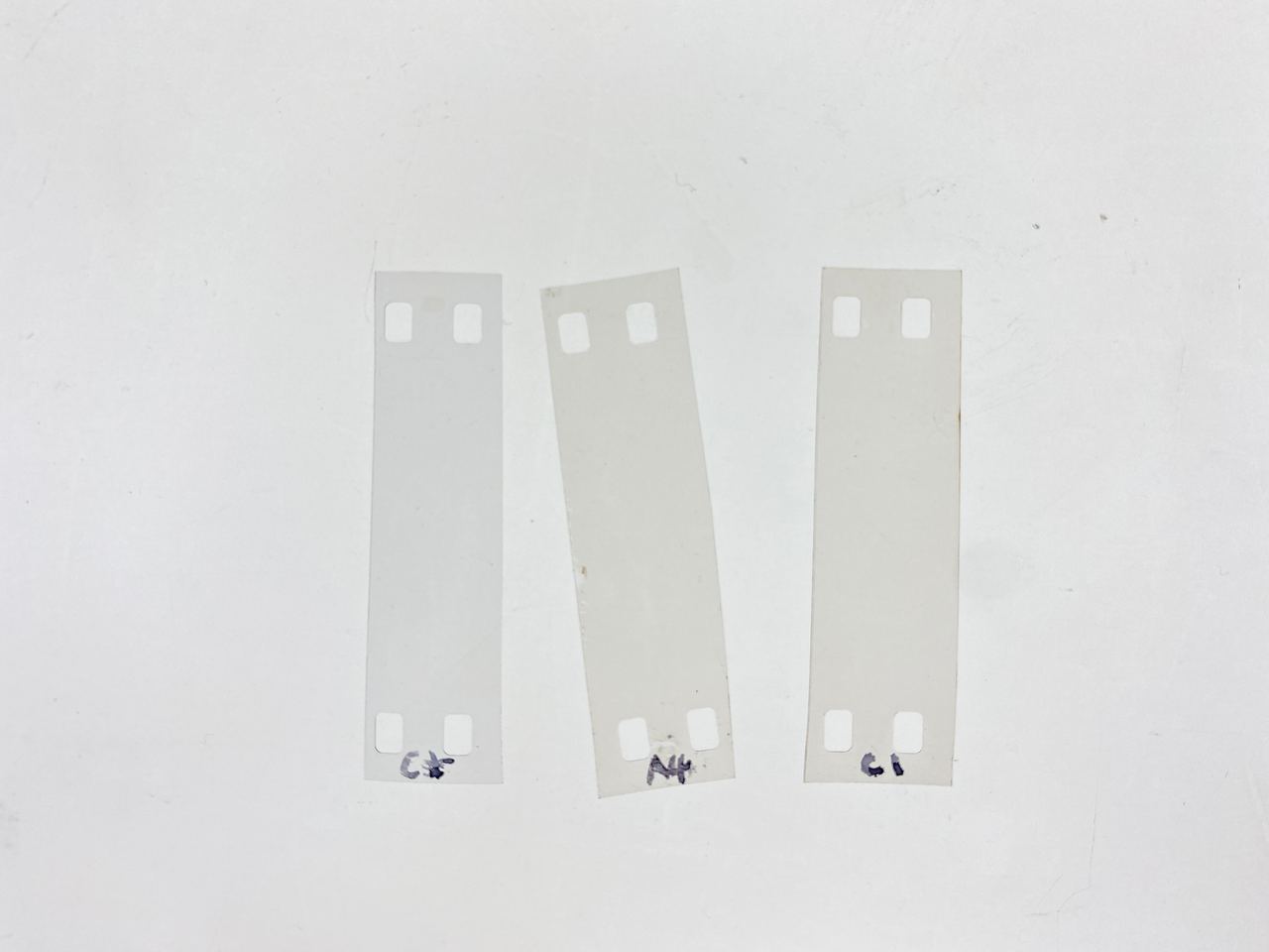

This bleach works much faster and it appears to complete bleaching in 2 minutes. Here is how the film looked after 5 minutes of bleaching.
After 10 minutes
Fixed, washed and dried.
I bleached a strip of film with dichromate bleach for comparison. Looks like both peroxide bleach cause slight sepia staining.
From left to right: dichromate, EDTA-phthalate-peroxide (2.2g/L EDTA), EDTA-acetic acid-peroxide (3% peroxide)
