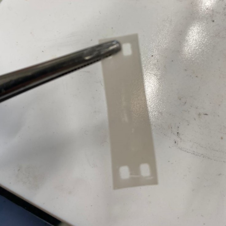

The bleached strips were milky in my previous test and that's why I fixed them. I thought it was undeveloped silver halide but if the film bleached with peracetic acid bleach without EDTA did not turn black in second development, something else may be happening here.
Film strip after bleaching. It turned clear after fixing.
Ah you fixed them, right. Well the possibility remains that the sodium hydroxide I have is not pure enough since it's just from the hardware store. It may have nothing to do with EDTA. That's why I was thinking if you had time to check against your setup you could help control for anything wrong with mine. It definitely bleaches _differently_ with the EDTA in the bleach. The bubbles sort of flow together instead of one at a time.

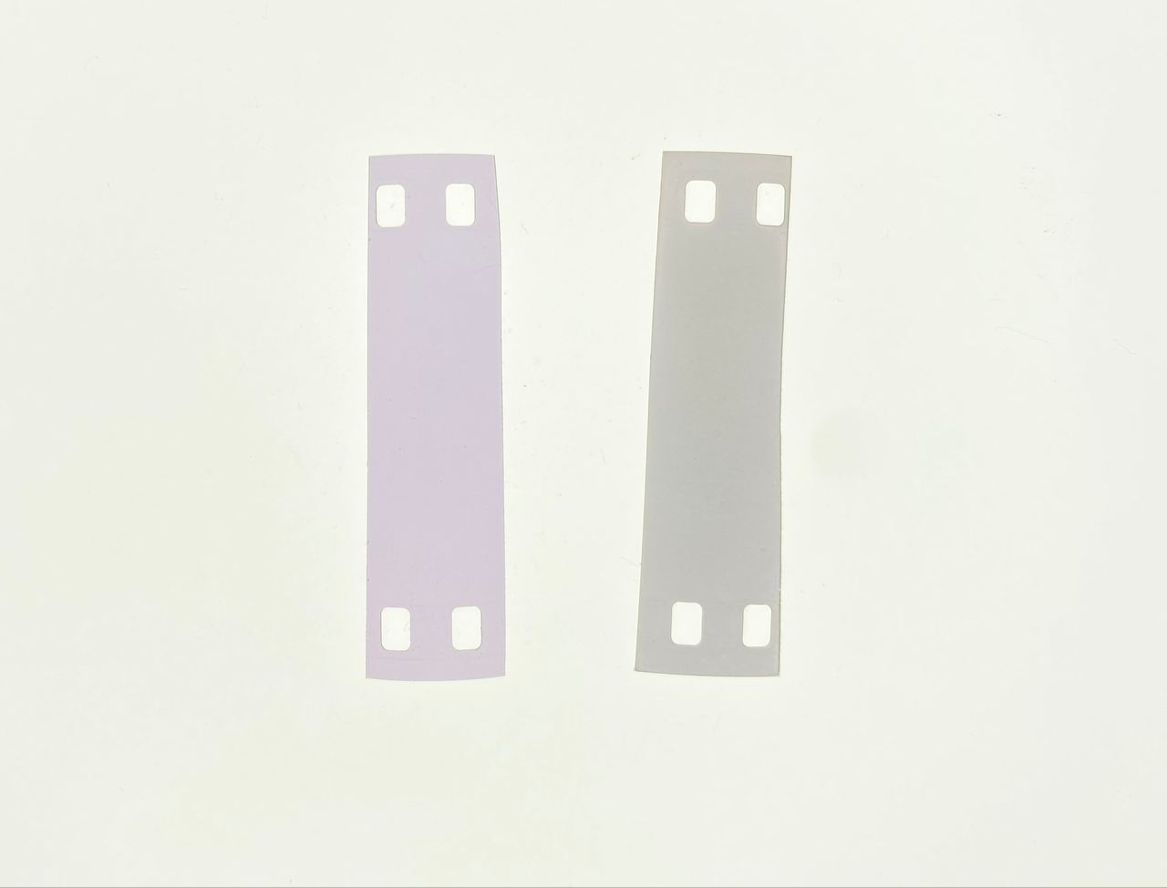

I tested a strip of ilford pan 400 and it did darken in second developer! I also bleached a strip in flexicolor fixer for comparison.
(Left: fixed only. Right: developed, bleached, second developed and fixed)
I measured optical density of the film strip.
Developed, bleached, second developed and fixed film 0.52
Fixed film 0.29
I have no idea what caused the darkening. Could it be some sort of re-deposition of developable silver compound back into the emulsion in the bleach?
Could be an issue of first developer not developing the highlights fully. Did you use a halide solvent in your first developer?
I added thiosulphate to the first developer. I am still trying to figure out a proper developer formula and development time.

That looks OK! I agree with Raghu that’s just not long enough in the first developer. Nothing like the problem I’ve had. I think it’s that my hardware store NaOH must have carbonate in it. If you develop longer in the first developer I think this will bleach down and redevelop clear! That’s encouraging actually.

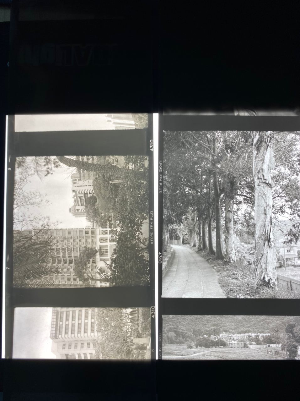

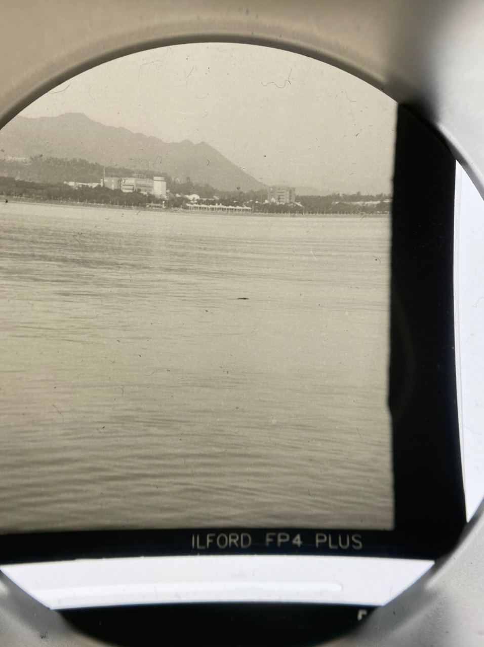

I developed a roll of ilford FP4+ with a new batch of EDTA-acetic acid-peroxide bleach. The reversal was sepia stained and flow marks/ incomplete bleaching was observed. There seems to be some blistering too but I'll have to check it with a loupe after drying to confirm.
I suspect low agitation is causing problems here. I got lazy and only agitated a few times during bleach. I did constant agitation in the phthalate-silver nitrate-peroxide bleach I tested years ago.

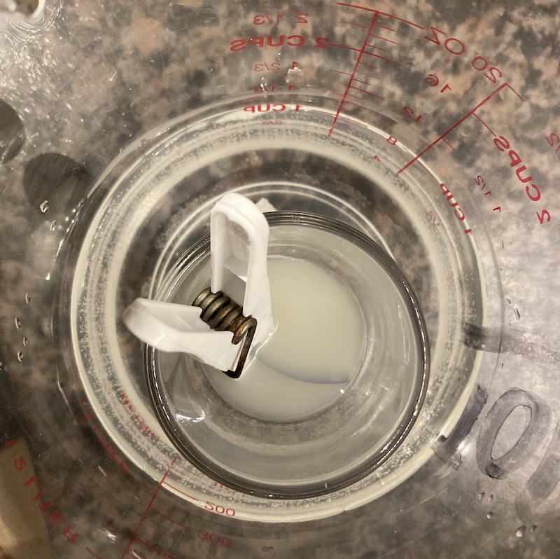

Here's a shot showing the milky color of the bleach with the zinc sulfate in it. It definitely got a bit milkier with the bicarbonate added as well. The laundry pin is holding the film submerged vertically in the bleach, which is in an outer bath to help maintain the temperature at 30C.

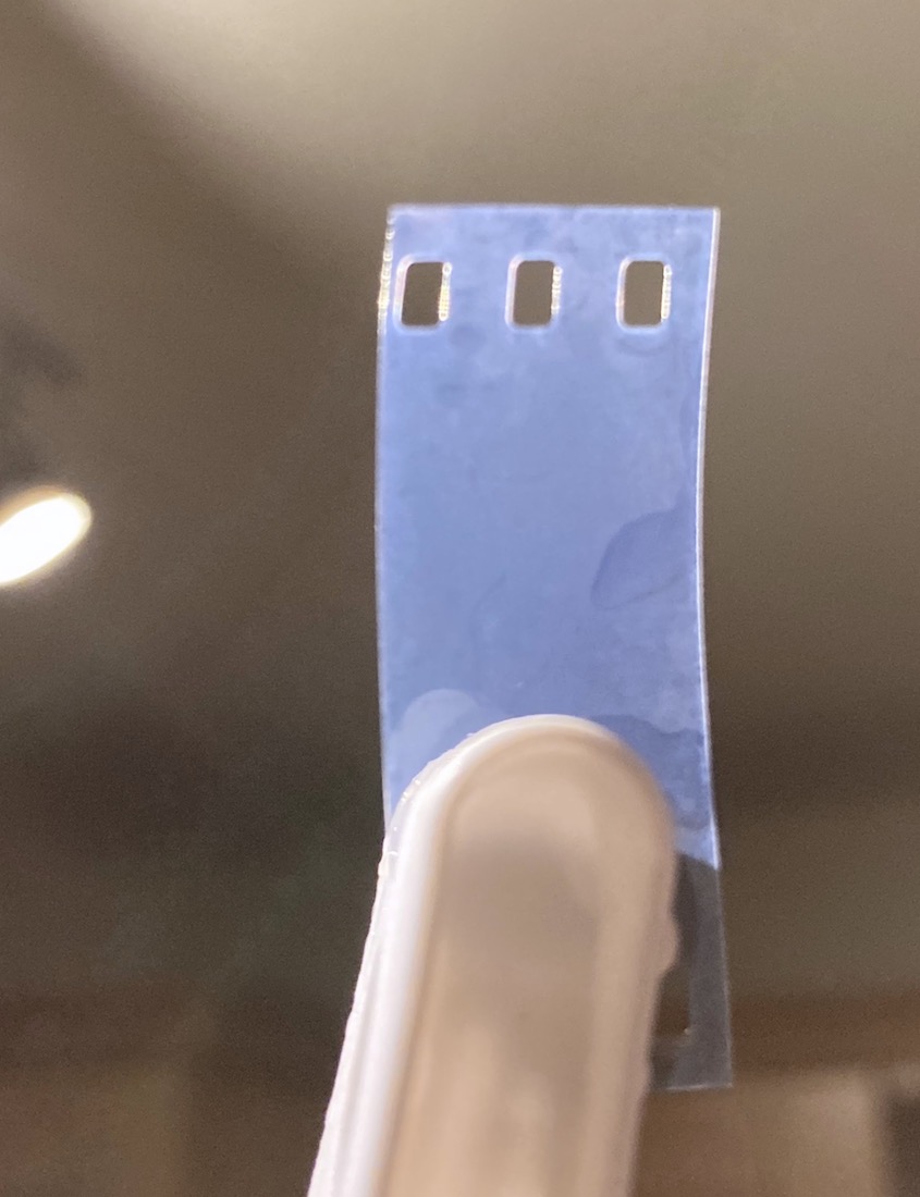

This is the film after bleaching, before redevelopment. The spots are water spots, because it was not yet dry, obviously.

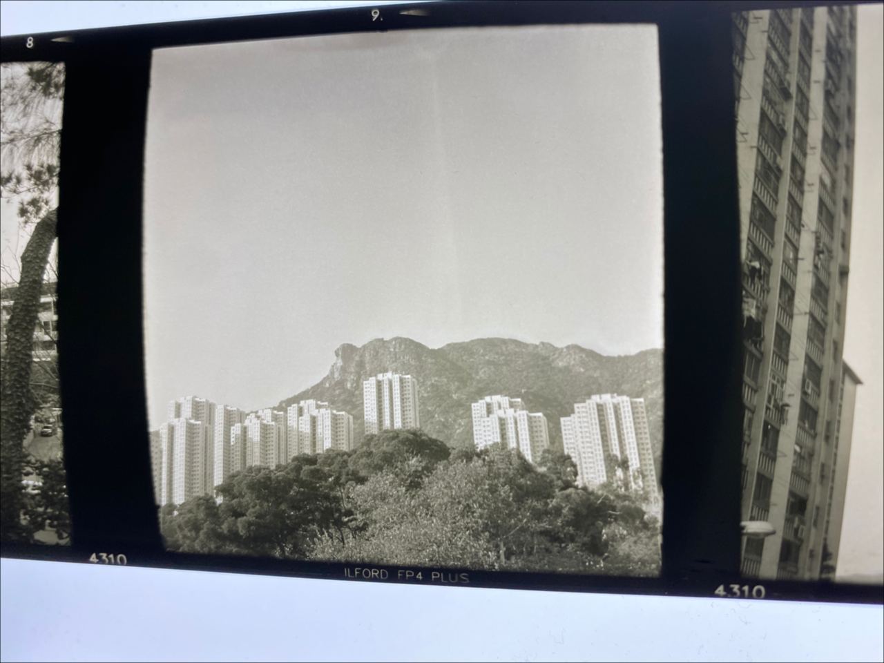

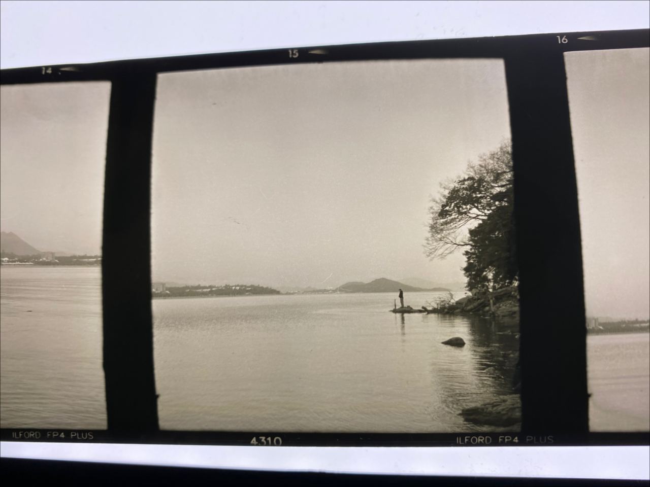

Here's after redevelopment and drying. I think it could have used a little more time in the bleach.
How does the staining compare to your citric acid bleach? Were you able to look at them with a loupe and see what the blistering looks like? I wonder if a drop of Photo Flo would interrupt the flow marks?
Citric acid bleach appears to produce less staining and better Dmax. I have no idea why the bleach can affect Dmax. Maybe the acetic acid bleach can actually bleach-fix as the Konica patent suggested?
The flow marks look really bad in acetic acid bleach. I might try adding some Photo-flo next time.
(left: acetic acid bleach, right: citric acid bleach)
And here is the blistering
