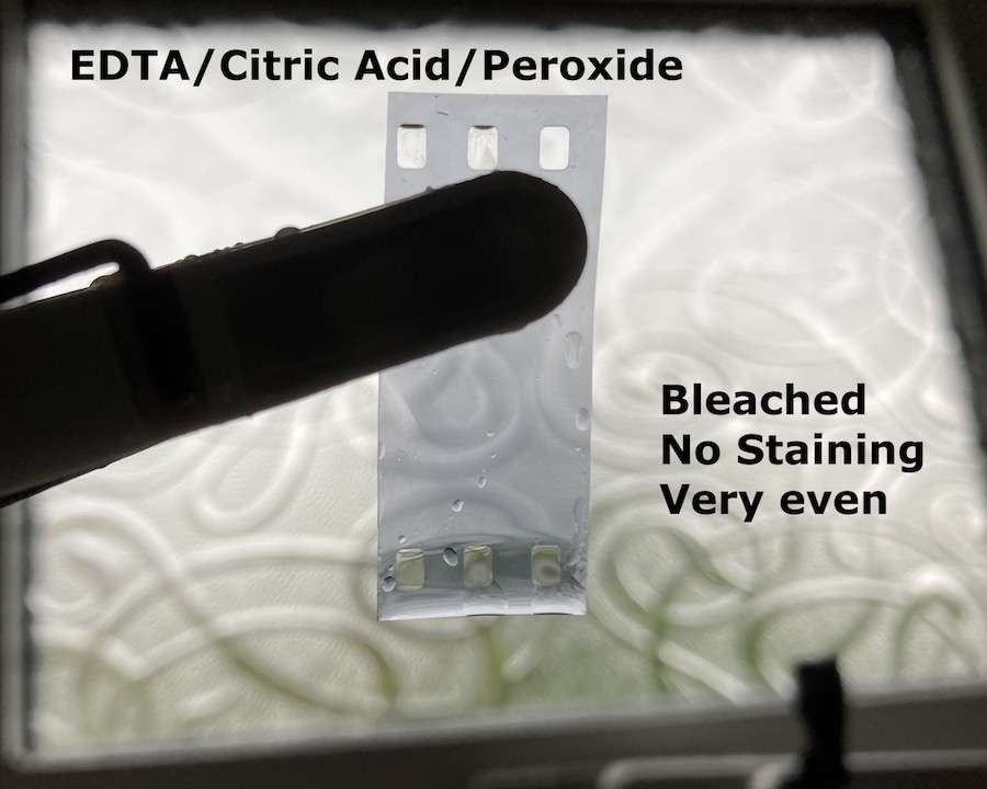

I tried an experiment today that looks very promising! No staining, good times, clear bleaching. This was with ORWO N75.
This is the bleach that is looking promising:
  • Hydrogen Peroxide 3% — 20ml
  • EDTA free acid — 0.5g
  • Sodium bicarbonate added a bit at a time until the EDTA dissolves. pH finishes at about 7-8. Guessing it's a few grams. I just targeted the pH.
  • Citric acid to pH 4. Guessing like 0.5-1g. Again I just targeted the pH.
  • Bleaching to completion 7.5 mins @ 25C!
I will try to get better precision measurements tomorrow but this is the best thing I've tried in the last few weeks. It's not from a patent, it's my attempt to do what made sense to me from all the reading and research. I will look at the emulsion damage in a loupe in the morning.

I did some further experimentation today with the EDTA/Citric acid bleach. I tried various mixtures and various pH to see how that affected things. Here are some observations:
Emulsion Damage
  • So far I have not seen any blistering on ORWO N75 or Fomapan 400. Fomapan 400 doesn't show any even on the more aggressive bleach, though.
pH
  • As described in several of the patents, pH has a big effect on bleaching performance. It appears that you can use the pH to control bleaching performance.
  • The bleaching speed also seems to have a big effect on staining. The very fast chain reaction that sometimes happens seems to leave bad staining. Raising or lowering the pH seems to help. The bad chain reaction seems much more likely around pH 5.5.
  • pH around 7 took about 15 minutes at 20C and was very even and clear, no staining
  • pH around 5.5 took about 5 minutes at 20C and both stained, and unevenly bleached
  • pH around 4 took about 10 minutes at 20C and was reasonably even and clear, no staining
Bubbling as an Indicator
  • If the bleach is working well, there is a slow, steady release of bubbles from the surface of the film
  • If it is bubbling heavily, something is probably not right, and staining or emulsion damage will likely result.
Temperature
  • Seems to have less of an effect on speed and staining than pH. It does have some effect.
  • Raising the temperature can get the reaction started sooner, but seems not to speed up the whole bleach time in the same proportion for some reason. It also risks worse staining and uneven bleaching.
  • Somewhere about 25-30C is probably the sweet spot. 20C works fine.
General Observations
  • I am so far unable to clear the leader in the same way with this bleach that I was with the acetic acid/peroxide bleach. I suspect this is because this bleach is not also a BLIX. I will try to run it on some fixed film to see if that makes it run totally clear.
  • The amount of EDTA I am using seems quite high. I will try to back it down to much less.
  • Today I found that the total _amount_ of citric acid, bicarbonate, and EDTA appears not to be significant. It seems to be the ratio and pH that makes the most difference. I am sure some minimum amount is needed, but after that it seems to not matter. I was able to use the same bleach and just dial the pH up and down with citric acid and bicarbonate to no ill effect that I can detect.
Here's the measurements I started out with today:
  • Hydrogen Peroxide 3% — 20 ml
  • Sodium bicarbonate — 1g
  • Citric acid (pure) — 0.5g
  • pH about 4

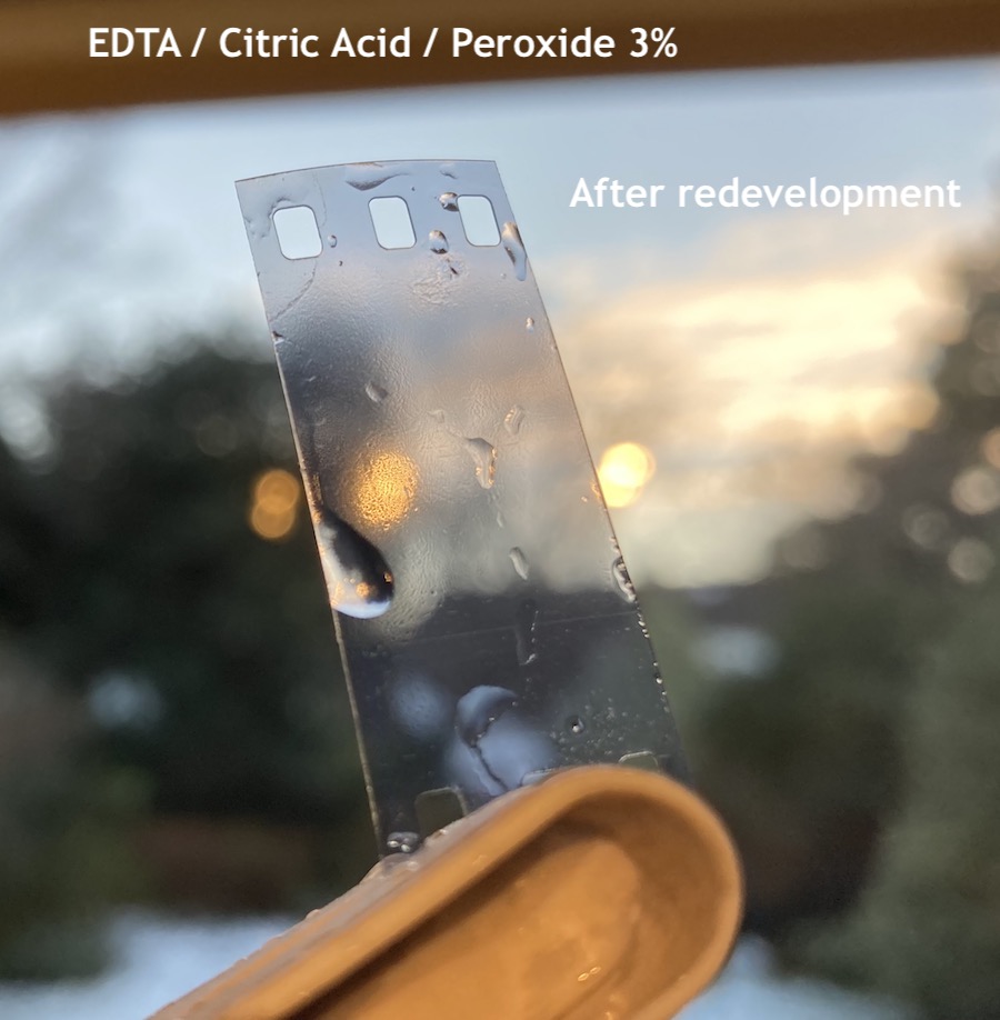

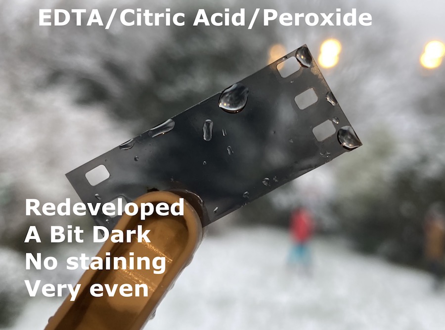

I was not able to replicate quite the bleaching performance I got yesterday, though yesterday's bleach still worked today. I then upped the amount of EDTA to 1g total and sodium bicarbonate to 2g total and citric acid to 1g total. I believe I could have maintained these ratios but used less of all of these.
Here are some photos of what it looks like bleached, and then how dark it was after redevelopment. Since this film had not been fully fixed, I am guessing the lack of fixing action in the bleach accounts for that. I will try with fixed film.
Ah, not too bad, though. 7 minmutes is OK. Did the bleaching action work just as well?
The bleached film strips look identical to my eyes.

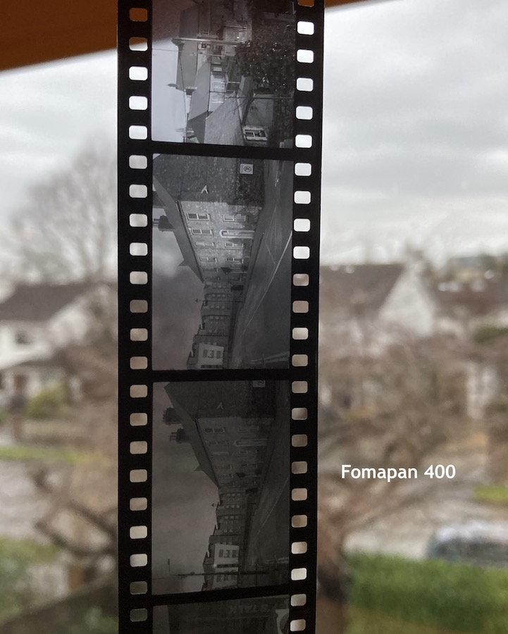

Looks good! Interesting that Fomapan 400 works nicely for reversal, I'm not sure why the company itself doesn't promote it. Anyway, what calculation are you trying to do?
In 35mm, it has a gray base (similar to that on Tri-X), so the Dmin on slides would be higher than desirable. Kodak has never recommended Tri-X still film for reversal processing, either.

Thanks! Yeah I had read about needing to get to pH 8 to dissolve it. Originally I had mixed up a solution of it and used that but it's annoying that way because of the extra dilution to the H2O2, since this bottle is 3% peroxide solution. So it's better to add the EDTA and then the bicarbonate. I see what you means about being complicated to calculate. I remembered titration from high school years ago so that's how I ended up doing what I'm doing. Sounds like that's not a silly way to do it. That's probably a good enough lesson on its own :smile: Thanks for the help
Well I tried a little snip of leader from a roll of Agfapan APX-100 (original) that I developed over the weekend. The bleach from yesterday was still good and cleared it in about 6 minutes at 17C. It's drying now so that I can see what emulsion damage there may be. It's a bit scratched, so findings may not be definitive.
But, I was encouraged that the bleach did not die over night. The pH 8 bleach I made died overnight as I had theorized that it would.
Also, I forgot to say this before, but in order to get the Fomapan 400 to clear in this bleach (vs the acetic acid bleach) I had to use a first developer with 1.5g/L sodium thiosulfate. I believe that this is a pretty good indicator that this bleach does not do much fixing. Certainly less than the acetic acid bleach does. And I think that will mean better Dmax. I will try to figure out if I can run a few frames for real this weekend. Will depend on diluting down the 12% peroxide that arrived last week and if the deionized water I have is clean enough.
Well folks, this bleach works very well, and solves all of the problems we've seen with other bleaches except emulsion damage with some films. I have run a roll of Fomapan 400 in it today and obtained good results. I decided to write up a Photrio resource for others to benefit from here, including the full, working formula with all amounts including the citric acid.
https://www.photrio.com/forum/resources/b-w-reversal-bleach-—-hydrogen-peroxide-edta-citric-acid.448/
Here's the roll I developed today:
