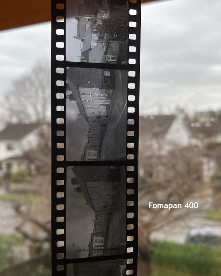

Here's the roll I developed today:

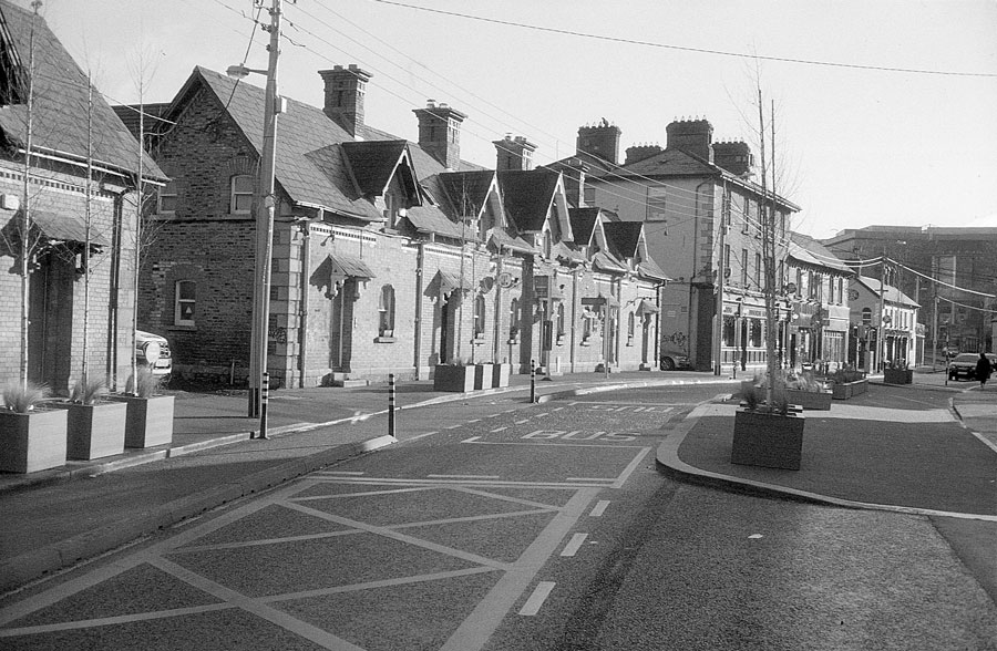

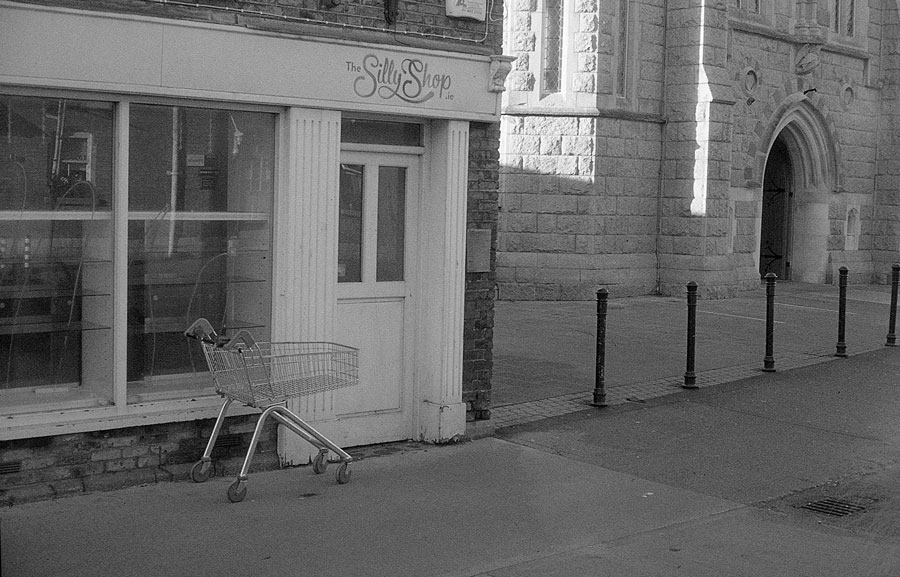

Here are a couple of frames from that roll that I posted on the Resource.
These are Fomapan 400 at EI200, Ilford Multigrade 1+5 with sodiudm thiosulfate 1.5g/L, peroxide/EDTA/citric acid bleach, Ilford Multigrade 1+9

…The citric acid/EDTA bleach is also a blix but quite a bit weaker. I was seeing more or less box speed on Fomapan 400. You still get some emulsion damage, though quite a bit less. It looks like you are shooting 6x12(?) though so you may not notice :smile:

Sorry if that was not clear: there is no reduction in speed from the Citric acid/EDT bleach. Fomapan 400 is not a 400 speed film (per Foma's own datasheets), so shooting it at 400 is a ~1 stop increase. Also keep in mind that the developer has much more to do with speed increase than the bleach. However, the bleach can make the speed worse by blixing too much and leaving you with a thin negative. Leaving it in the bleach too long in the acetic acid/peroxide bleach will take quite a lot away. The unpredictable nature of the bleach speed is also very annoying.
The leftover yellow "staining" from the acetic acid bleach is not actually staining, as discussed earlier in the thread. It's fine grains of silver that get evenly deposited across the film. This is why it doesn't clear with a sulfite bath. The EDTA and citric acid in the the bleach we formulated on this thread chelate that silver and prevent it from re-depositing on the film. You still need to use a sulfite bath with this bleach to get rid of the actual staining.
Peracetic acid _can_ damage the emulsion, but the majority of what you see is damage from bubbles of oxygen splitting off the peroxide when catalyzed by the silver and then tearing the emulsion on the way out. The faster the bleach goes, the bigger the bubbles are that form and the more damage, within reason. So slowing it down a bit actually produces better results. Also, chelating any free silver as much as possible before it has time to further catalyze the breakdown of the peroxide seems to help a lot. The acetic acid bleach is worse at this. Stabilizers for peroxide also help from the patent literature. HEDP is recommended as a peroxide stabilizer in the Konica patent. I began testing with this but have not revisited it.
In your negatives you are definitely seeing some emulsion damage. But because they are so big you probably don't see it on scans. Do a detailed scan and zoom to the highest resolution and you will definitely see it. Some films do better than others. Temperature seems to have very little impact from all the testing I did. Which is further reinforced by the fact that none of the patents out there talk about temperature as a controlling factor in emulsion damage.
