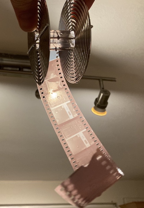

I have a question about the inspection part, since I am new to this process.
When I did my Foma-film, and bleached as per instruction, I could see a faint image on the film-strip after bleaching.
The resulting final images were ok after the second developer (a little dark, perhaps, but very very usable).
When you bleach by inspection, what exactly are you looking for?
Totally uniform (cloudy) negatives with no visible traces of an image?
I would likely try this again (I kept the hydrogen-peroxide + vinegar solution in a bottle here), but it would probably help to know what to look for during bleaching. :smile:
Also, the first development-phase, is the point here to "develop to completion" almost, or overdevelop -a lot-, for the bleach to clear/brighten the final image enough for the second developer to create as normal negatives as possible?
Depending on how you're looking at your film, you might see a faint negative image (film base and whatever is behind it as dark, milky halide as light) or a weak positive (light behind the film, so the halide is seen as blocking that light). Either way, the bleached film leader (assuming 35mm) should be as clear as fixed-out, undeveloped film of the same type.
Like @Donald Qualls says, with light behind it at all you should see a positive image and the leader should be totally clear. Here's what ADOX Silvermax looked like when bleached fully, and before re-exposure. It has a reddish pink cast. Fomapan 400 is yellow/cream.
See that the film leader is still wrapped around the reel and that it's totally clear. Note that if you did not develop long enough in the first developer, you will not see a fully clear leader and that's one way to know. With this bleach I usually bleach in normal room light the whole time, and you start to know what the film looks like when it's bleached without having to unspool it. Usually the last place to clear is between the sprocket holes. If there are still darker spots there, keep bleaching.
Regarding first developer, you want to develop long enough to give clear highlights, but not enough to start giving general fog, because that would reduce density all over the image. I have found that a clear leader after bleaching is a good indication that it has been developed long enough. You want to develop just long enough to do clear it, maybe a little extra. For me, with this bleach, that gives good results.
This bleach has a reasonably strong fixing action so I found it mostly unnecessary/undesirable to use much solvent in the first developer. The Fomapan 400 does not need it and can't really handle it. Silvermax does need a bit, but it blisters too much to use in this bleach, so not worth thinking about.

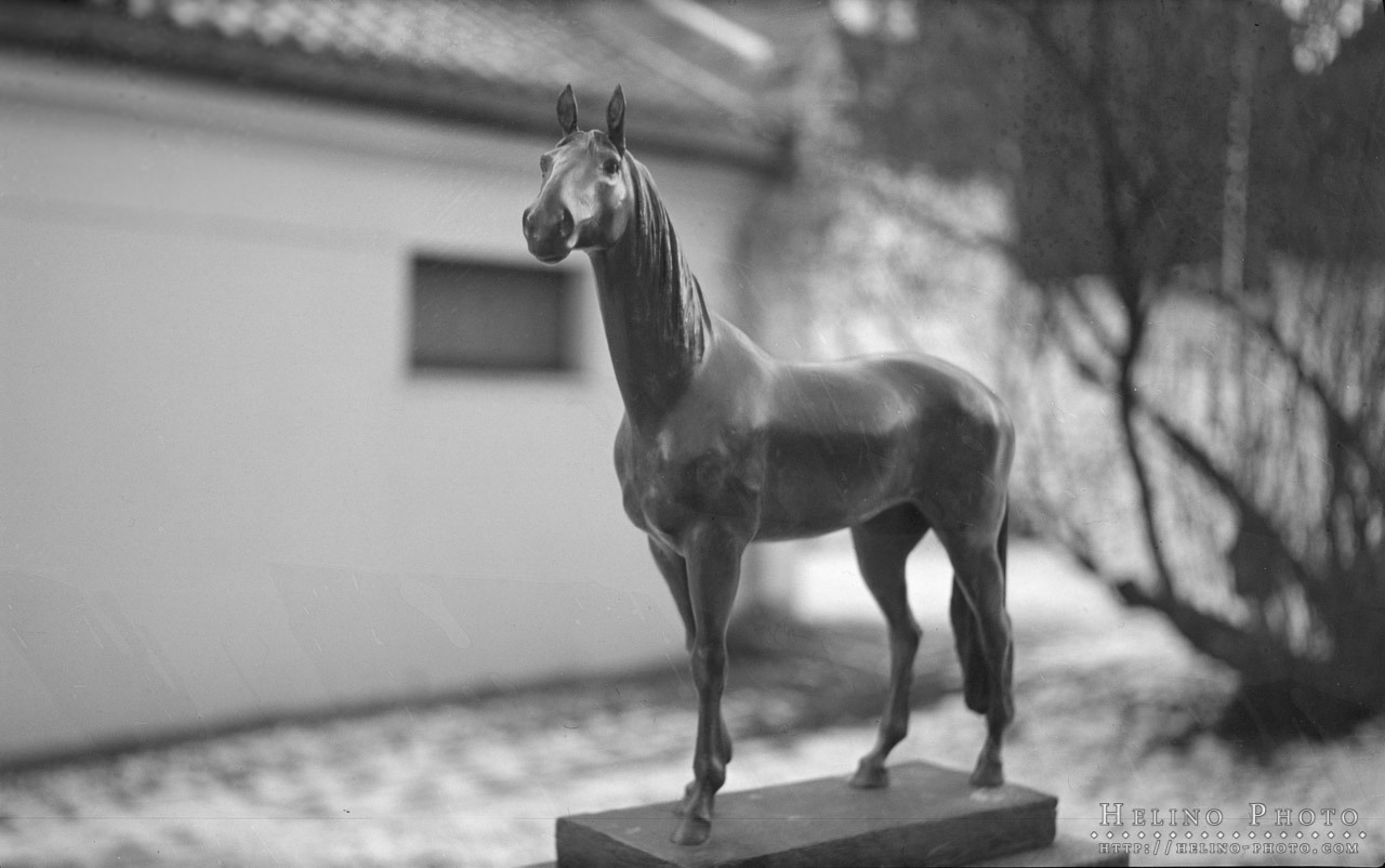

That actually looks pretty good to my eye. I haven't done a bunch of reversal, but it looks like you've gotten rid of the silver image. Fogging and redeveloping is what will finally tell the tale.

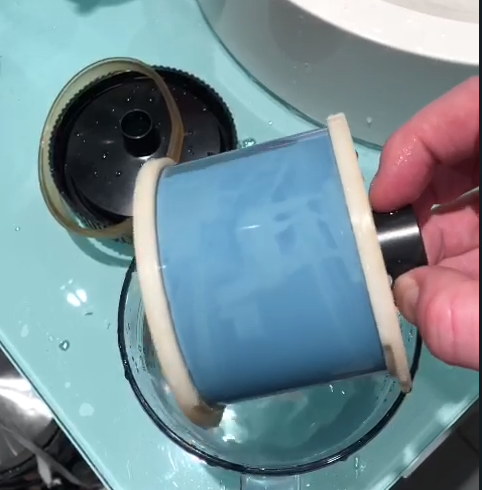

That looks reasonably good. But, is that a positive image or a negative? It looks like a negative still? Did any part of the film end up nearly clear?
Not 100% clear, a little dark, this is a screenshot of a video I did, where it basically just hangs in the shower in a well-lit bathroom.
And here is the resulting positive scan of the redeveloped horse statue-image from the bleached photo above, as it would be displayed by a projector.
Mind the mess on the film, I managed to actually drop the thing onto the bathroom-floor while drying (newbie mistake), the clips suddenly let go as I was inspecting it.
A scan is perhaps not the best representation though because it is so easy to adjust and correct it.
But, as a process, it does give very usable images, when it works, (I tried the same on some expired Kodak Tri-x 320 from 2011, kept frozen, shot at box speed in contrasty sunlight and they were almost black :D )

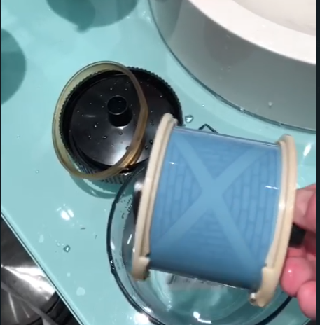

(another part of the video)
This shows that this is a "negative image", but it is explained why, below this post:

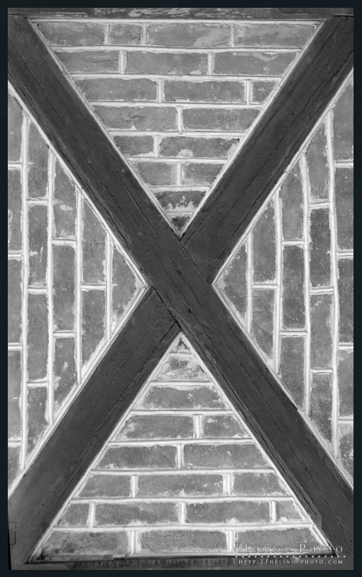

The resulting (positive) scan after exposing it to light and redeveloping:
This is a correct representation, with dark wood, grey brick and bright mortar in between.

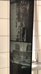

It is strange that it does look like a negative image on the roll, the photo on the roll is taken after i had bleached it, and was rinsing it, before exposing it to light under a bulb, and then develop it a second time.
What you're seeing that looks like a negative in this view is the dark space between film layers (light limited there by the halide and the reel) as the darks, and the undeveloped halide as the lights. Hold that film up against a light background, and it'll look like a positive, with the halide blocking the transmitted light according to density.
That's must be it indeed.
I did not film that part of it, but it must be the case, all the while I actually ended up with positives in the end :D
You can see more or less the same thing with some developed and fixed negatives, held in a strong front light against a dark background (and this is exactly what happens with a tintype or black glass ambrotype): the silver image (black in the negative) will appear light against the dark background due to scattering light. With ambrotypes made on clear glass, you can lift the glass and see the negative image, or put it on the velvet backing and see the positive.
Here, it looks like a negative because it's the darks that are still white, so to speak...
@Helinophoto That looks like you got very good results, I'd say! Given how good the shots look without any real backlighting to speak of, I'd say the process worked quite well. 120 Fomapan 100 should be pretty nice, too, as the base is clear. If you want a clearer highlight (I don't think you need it from what I can tell), you could try adding another minute to the first developer and see if that changes it. Given my experience with Fomapan 400 and this bleach I'd recommend not adding any solvent to the first developer.
Thanks, yes..........Oh I see I forgot to actually specify the dev, I used HC-110 dilution B all the way here.
