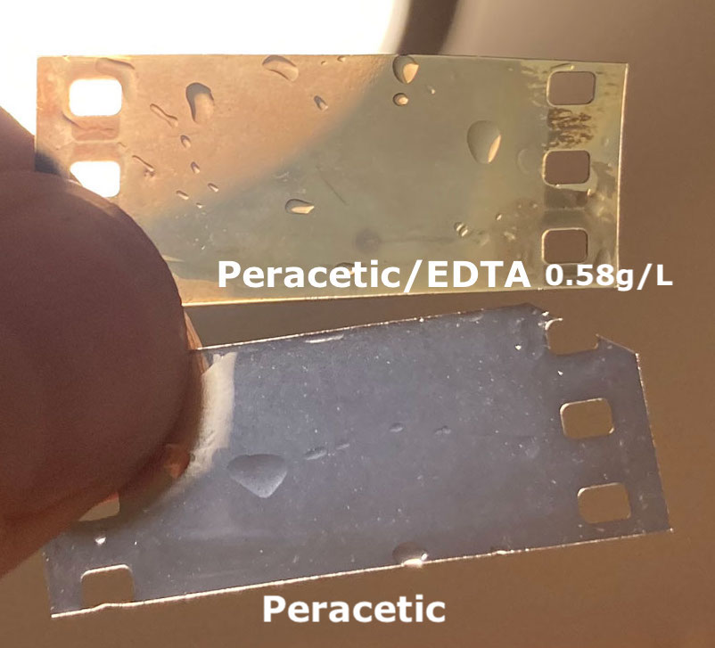

I bleached and fixed a stained film strip from previous experiment in flexicolor chemical. The stain was removed. I guess this support the theory that the ugly stain we encountered is elemental silver.
In the results you presented, more EDTA used in the peroxide bleach less is the stain. May be EDTA is able to sequester the silver ions trapped in the gelatin and thereby prevent the reformation of silver. You may want to increase the concentration of EDTA further and see if it can completely inhibit stain formation.

Well I had some disappointing results today. Having the free acid EDTA instead of the salts makes it so much more complicated than just dissolving the EDTA into the bleach.
I first attempted to mix up a 6.4% EDTA solution using sodium carbonate to get the pH up high enough to dissolve it. I could not get it to completely clear, so I filtered it and then tried this solution with just peroxide (20ml 3% peroxide, 2ml ~6.4% EDTA solution) to see if that worked at all. It did not: no bleaching to see in 10 mins. It might work with more EDTA.
I then started with some of the seasoned peracetic acid bleach I had been using and used 20ml of that and 2ml of the 6.4% EDTA (carbonate). If I haven't screwed up calculating, with dilution I think that works out to 0.58g/L which is a tiny bit more than the lowest concentrate sample that @kentanghk tried. I compared this to the existing peracetic acid bleach to see how it performed. At room temperature (20C), I bleached a small piece of Fomapan 400. When fully bleached in about 3 minutes, both looked reasonably clear, but I could see sort of "flow" outlines on the EDTA sample, just like @kentanghk saw on the lower concentration samples he tested. When I redeveloped the samples, the original bleach sample was clear, no staining. The sample with EDTA turned quite dark!
I thought maybe this was the same thing I saw with percarbonate: maybe it's forming silver carbonate, which is light sensitive and thus darkens when redeveloped. So I decided I had better get some NaOH instead. Since I didn't have any on hand, the only thing I could get on short notice (i.e. today) under lockdown was to get Caustic Soda from the hardware store by my house. This is labeled as being only sodium hydroxide. The MSDS for this brand only lists sodium hydroxide. I then mixed up a 6.4% solution and tried again. This had no problem clearing fully.

What I got was the exact same problem. I used tap water to mix it and so there is a possibility it's a small amount of chlorine from the tap water. Or more probably the caustic soda I got also contains sodium carbonate. I would have thought that it would require labeling if so. When I washed the bleached film, a bit of black came off in the water, almost looked like remjet. When I put it into the developer, a bit more came off. Maybe silver carbonate deposited on the film? It was not emulsion coming off, the emulsion is still there, and quite stained.
This was about 4 hours end to end, including a trip to the hardware store. I may have a little more time tomorrow to try to use deionized water as a possible improvement in case it's tap water.
I think the photo disguises a bit just how dark the top sample is. It's not just stained.
Anyone have any better ideas about this black deposit?

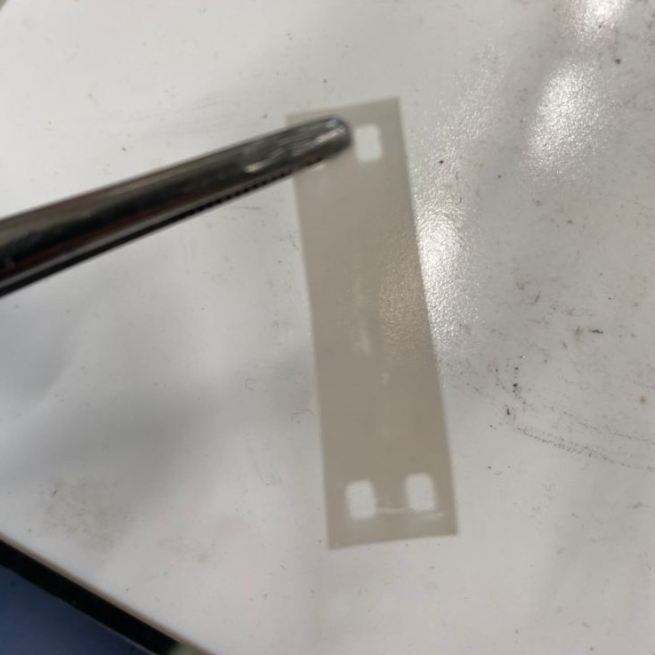

The bleached strips were milky in my previous test and that's why I fixed them. I thought it was undeveloped silver halide but if the film bleached with peracetic acid bleach without EDTA did not turn black in second development, something else may be happening here.
Film strip after bleaching. It turned clear after fixing.
