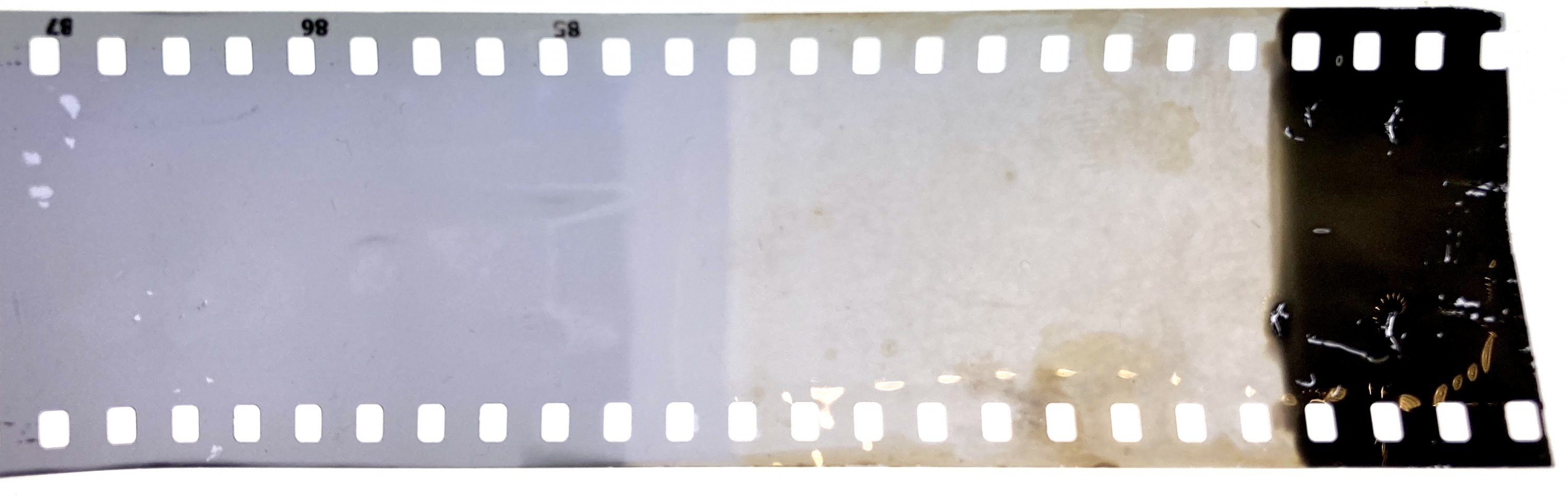

I didn't have any time today to make any progress, but here's a better photo of the last strip I posted. You can see some mottling for sure. I will need to play around with that a bit before I put any photos in there. I will also next run a clean, undamaged piece of film, which should give clearer results.

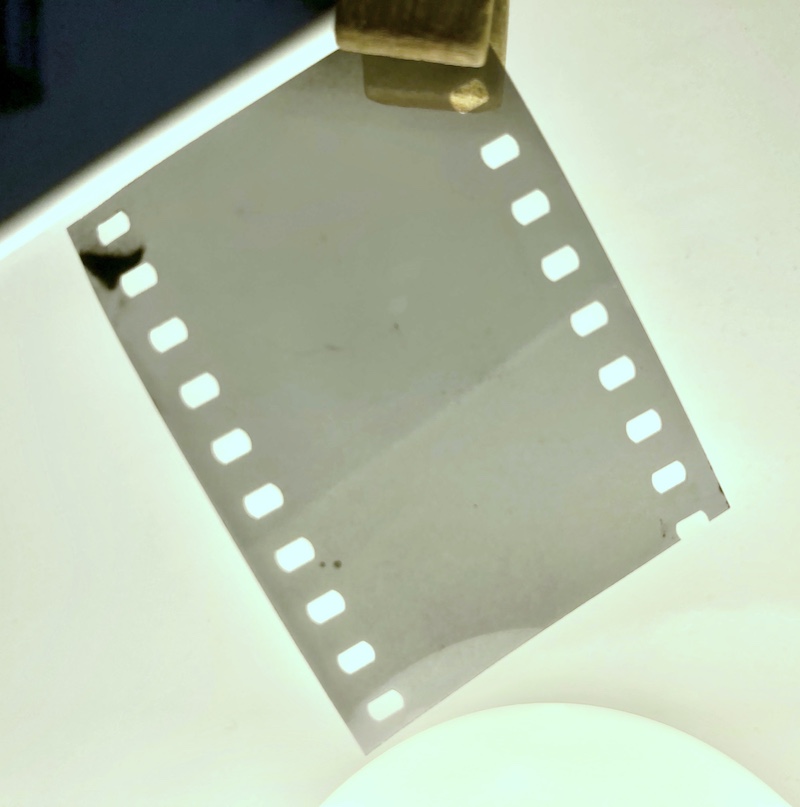

Without a proper light table it's pretty hard to get good photos. But here's the piece of film I was talking about in the last post. This is ORWO N75, hence the cine sprocket holes. It's impossible to get the white balance where you can see the faint gold color. It basically looks like a clear piece of film. Without scanning it I am not yet sure what the surface looks like.

Well I tried a roll of about 6 frames. There is some kind of rehalogenation happening and the film came out mostly black, despite having fully bleached. I coud see a faint positive after reexposure. Guessing there is chloride in there in an amount enough to screw it up. It's not on the MSDS.

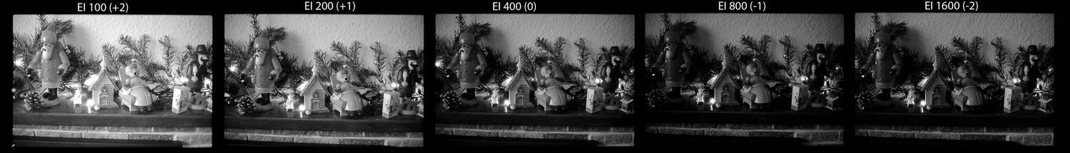

Looks like I may just be talking to myself at this point, but here are the results. Not a great photo, but this was a test! :smile: These the first two images are from the scanner, in grayscale mode. To show the neutral gray of the reversal, the 3rd picture is a photo of the slides on a makeshift light table. I think they are a little dark in general, which implies that an experiment with thiosulphate in the first developer is a good idea.
I normally shoot this old Fomapan 400 at EI200 and it looks like in this process it's about right at EI200 (+1). This was not a brightly lit scene. It looks like EI400 is still pretty reasonable. The film is grainy and the Ilford Multigrade Developer does not reduce the grain! But I am pretty darn happy with how it came out. There is no emulsion damage that I can spot in detailed scans. This film is 10 year old bulk rolled Fomapan 400. I think something isn't right with the EI1600 exposure, but it's kind of irrelevant.

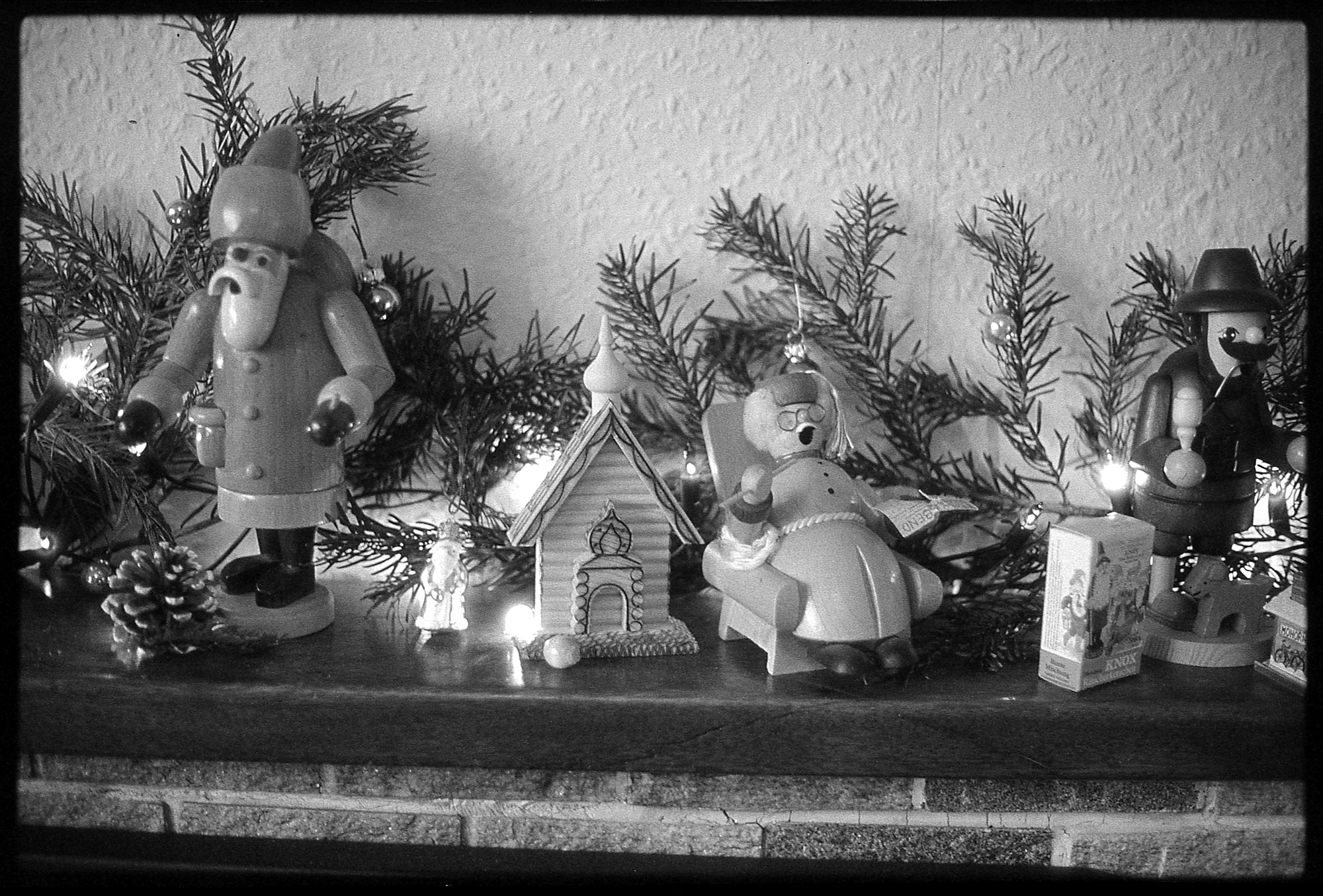

Here's a detailed scan of the +1 exposure (click the thumbnail):

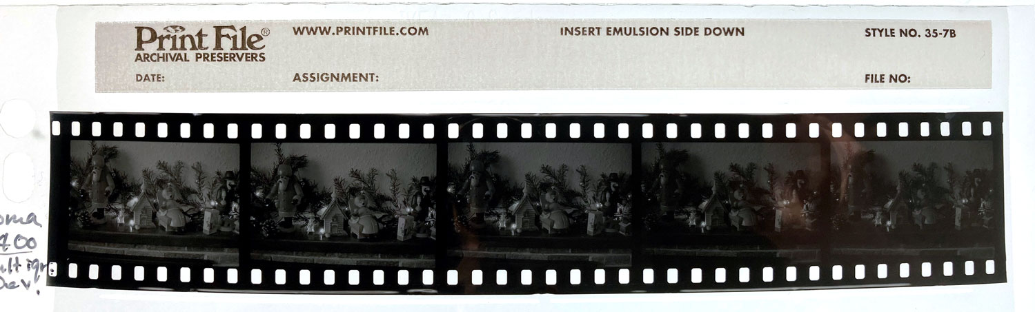

Finally, this is the photo from my iPhone of them on the IKEA lid/light table:

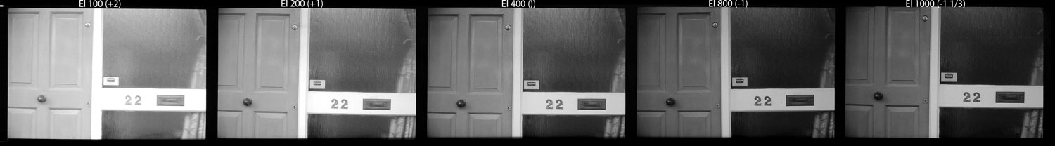

With proper density, Fomapan 400 seems to work very well up to EI 1000(!), which is the top speed I tested. That's pretty surprising for a film that struggles to make EI 250-320 in most common developers.

This is a scan of all 5 images that I shot with this film (I did a couple of scenes, but just posting this one). They are scanned together so that the contrast and brightness are equal.
400 or 800 are about right here IMO.
I think the ideal EI is between 200-400 for this film and if one goes higher than that slides look darker but with corresponding loss in shadow details. If at this EI you're getting light slides, then you're probably overdeveloping and/or fog is too high.
