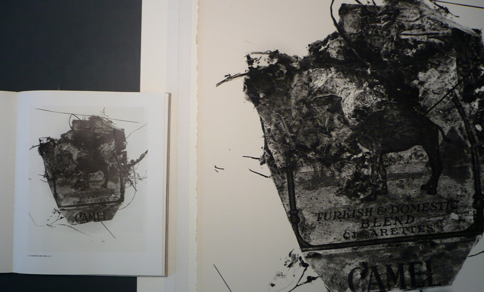

David, the Penn Small Trades series were done almost exclusively with Arches paper. I had a short email discussion with a friend of Penn's at the time these were printed. He said that the studio used to look like a laundry when they were sizing sheets with gelatin, sometimes 2-3 layers with drying in between.
Davec101
Jul 29, 2005
1,216
Cambridge, U
Thats interesting you mention that, just yesturday i was looking at some Arches Aquarelle and thinking about trying some as I remember seeing this paper used on some of the Penn's 'Street Findings' series, the paper is quite easy to identify as it has a heavy emboss in the bottom corner. Quite of few those prints are single layer on Arches and have a good strong black (see attached). Anyone used it before?

David, I just made a small palladium print about a week ago on Arches 90# watercolor paper. I acidified in oxalic acid. It printed extremely well, no anomalies.
On the same day I printed the same neg on Stonehenge, also acidified and had great results.
The only comparison I coud make btw the two is that Arches is slightly slower and has a slightly less warm color than the Stonehenge (which is known for a warm tone with Pd).
