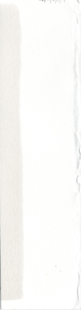

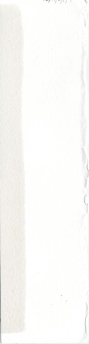

Have just today had some clearing problems with cot 320. What are you guys clearing this paper with? At the moment my clearing method has been.
5 mins citric acid
5 mins EDTA-Disodium
15 mins Hypo Clearing Agent
15 mins EDTA Tetra
It has been working fine for the last couple of weeks however the last few prints have not cleared properly. I have attached a cut sample of what is left after the clearing cycle above. This area was covered with rubylith tape and should obviously be clear. Am going to try a new developer and ferric oxalate to see if that is the problem tommorow. Any other ideas?
5 mins citric acid
15 mins EDTA Tetra
David,
I'm only using HCA with great success.
Periodically I make a clearing test, similar to yours, blocking to UV light a small area of the emulsion.
Curiously I never had any clearing problems with this or other papers.
Do you add Oxalic Acid to the Ferric Oxalate sensitizer ? If not, one of the possible answers can be there.

Hi Manuel
I get the powder bottles of Ferric oxalate from B&S which i am sure have a small amount of oxalic acid in. How much OA are you adding to a 25ml bottle of FO?
I will try 3 baths of HCA tommorow to see if that helps. The water that comes out of my taps is quite alkaline so it seems to need more clearing other people. The majority of the prints i make have rubylith around the negative to create a clean border, so there is no getting away with uncleared prints!

I think 40 minutes of clearing is significant overkill. I do 5 minutes in citric acid, 5 minutes in EDTA+sodium sulfite, and 5 minutes in hypo clearing agent (or Permawash). I do make sure that the baths are fresh; prints clear completely.

Hi Manuel
Hi again David,
Im order the metals and FO in powder from B&S and I always add OA to the sensitizer as follows:
-100ml H20
-27 grs FO
-2grs OA
I don't suppose B&S add OA to the ready made solution of sensitizer.
Other way of helping the ferric oxalate go into solution is to add EDTA Tetrasodium.
This, and to give full development will for sure help to solve your clearing problem.
What developer are you using ? Plain PO solution ? Do you check the developer PH regularly?

Yeah am using plain PO. I made a new batch only 4 days ago, i have ran out of PH strips but it should not have gone alkaline in such a short space of time. I spoke to B&S and they said they dont add oxalic acid to their FO any more. So maybe will give that a try tommorow with some fresh FO. For 25ml i guess one adds just a pinch, like half a gram?
Davec101
Jul 29, 2005
1,216
Cambridge, U
Okay it was fog, i have been switching around digtal negative systems and the masked border was not providing enough uv blocking so i doubled up with rubylith and that solved it. Phew...
