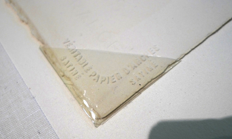

David, as promised here are two images I've made from Penn's prints at V&A.
I'm not sure if it's a paper mill standard procedure to use the emboss on the mesh side, if it is, those images were printed on that smooth side.
Thanks for these, so you think these two prints were on the mesh side? The Arches paper (Satine) is the single layer 'Camel Pack' is it not, and from my recollection the 5 Moroccan Women is the multi-layer on BFK.
I am going to see them again this Thursday to have another closer look.

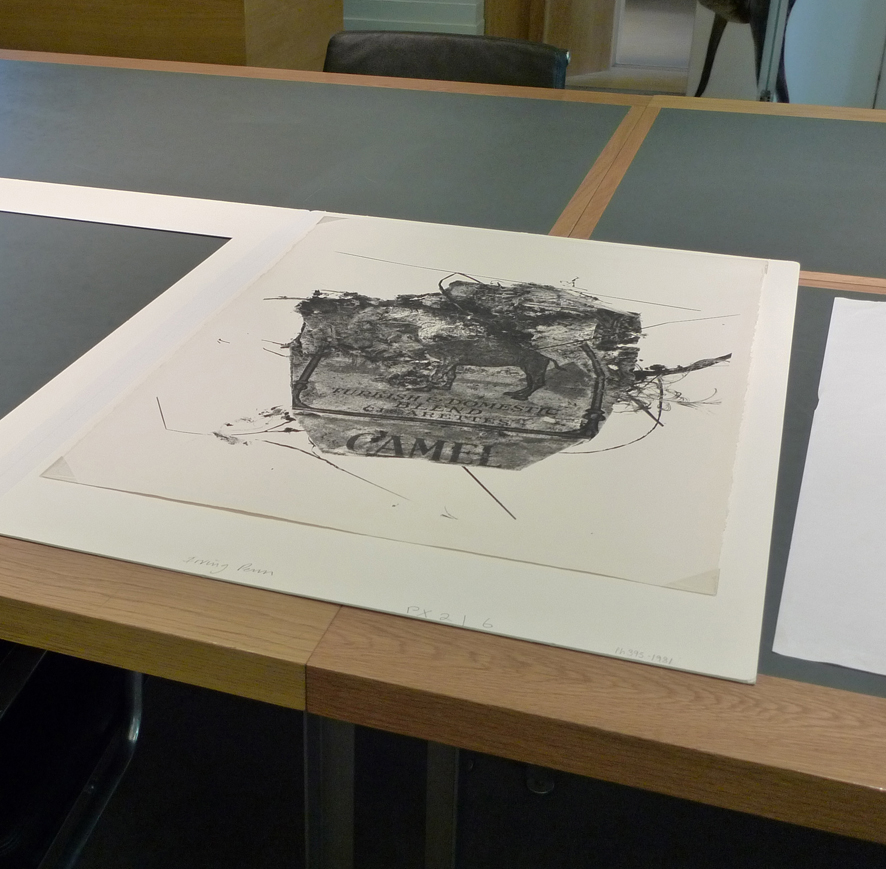

Yes David, you're absolutely right, that embossed Arches corner is from the "Camel Pack". Sorry for the mistake.

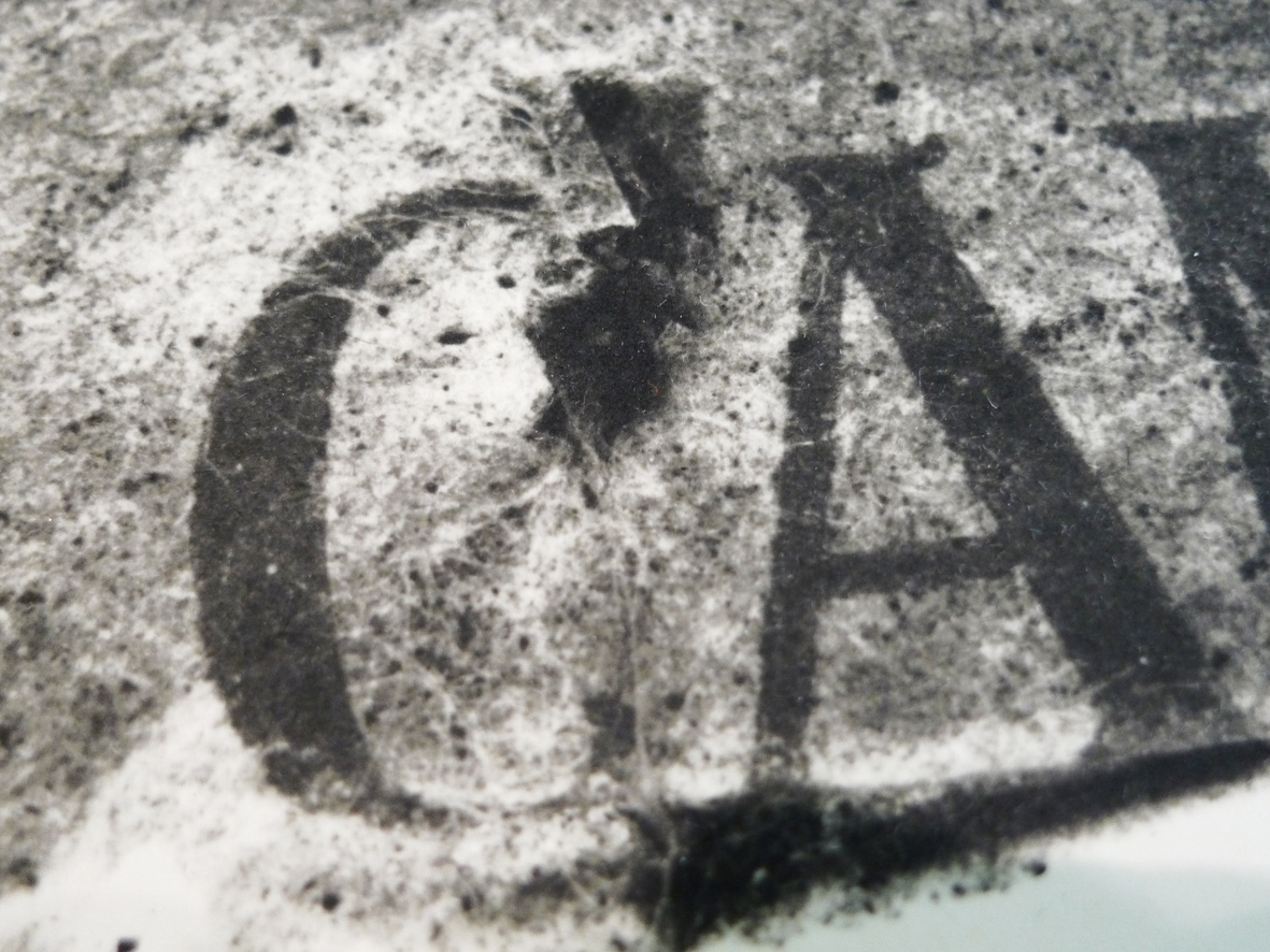

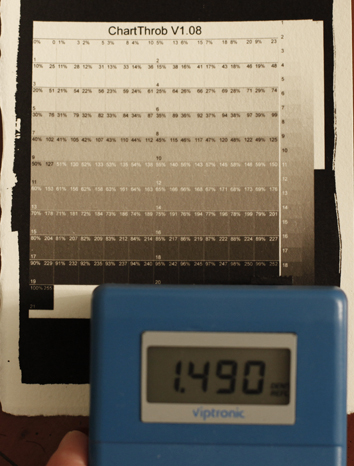

Yes i did acidify and did not size. I was waiting for dry down before posting some dmax results, see attached. If i can achieve this consistantly with a single layer i will be happy. This was on the mesh side of BFK Rives 270gsm white. The texture and tone of the black is by far the nicest I have come across, however i do believe the brush has played a part in this too. Will order some more sheets today to make sure this is repeatable.

Concerning the dMax measurement.
Can you notice any difference on your densitometer readout if you turn the paper 90 ?
I'm asking you this because with my Heiland densitometer I'm getting differences if I turn the print.
Perhaps is caused by the different reflection behavior of the textured paper.

Regarding dmax readings, if i were to move the paper 90 degrees there might be a variance of maybe +/- .01- or .02 but nothing drastic. I have two reflection meters a Viptronic and a Barbieri that I get calibrated each year. For important tests I initially make sure the readings correspond with the calibration tablet that came with each unit first then take a number of readings from the same area and note down the average.
