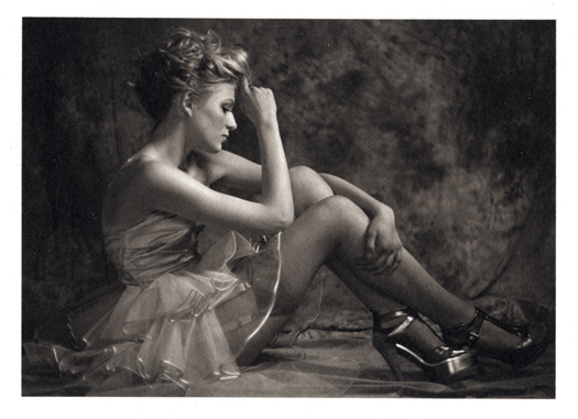

Keith, having tested many papers you might be able to shed light on the main problem I am experiencing with some of Penn’s papers. Its started to creep in the new batch of Platine too. If you look at the attached scan you will see this slight speckling, the paper is BFK Rives (acidified/humidified) and is rod coated. It’s as if the sensitizers is not being absorbed properly, this is also the case when using a few drops of tween. I suspect printing a second layer might resolve this however it should not be happening. Other than the speckling the image looks good for a single layer print. If i could solve this it could make the testing easier.
Thanks

David, is there any color to the speckling? I had a problem very early on with a sheet of Fabriano that had a gold-ish speckling, and it turned out I could see this in the paper itself before coating using a loupe.

It looks white to me. Cant see any problem with the paper before i coat.

David,
I had exactly the same problem with the last batches of COT320.
I've tried to understand that phenomena, looking at those prints with a microscope. The emulsion looked as it has not been absorbed by the inner paper fibers.
Until those problems showed I used almost exclusively the rod, but afterward I gave priority to Magic brush (single layer) and that speckling issue disappeared.

+1 I'd agree with Manuel, try the brush. I've never encountered white speckling with brush coating.
I initially had big issues with clearing. And when I used 2% acidification, I would get some sort of reaction inside the paper while it dried. If I looked at paper backlit, I could see a heavy grain-like pattern shadow. It showed up even with the completed prints, but only when back lit. Odd, but those problems are behind me now.

Thanks Manuel for the suggestion, I shall give it a try tommorow. For ten years i have used glass rods. If it works i would prefer to lay down a nice smooth first coat with a rod then touch up using jiaban brush if i could get away with it solving the speckling. I think Kenro Izu uses just a jiaban brush and has created some of the finest platinum prints i have seen. You can see him coat here http://www.pem.org/izu/process.html, the paper he has there is Platine, some years ago though.
[EDIT, having looked at the video again it could be one of those really expensive wide 'Da Vinci' sable brushes!! ]
Out of interest can you get the richardson brush in 4 or 5 inches? I dont want to be using a small brush for 34x27" prints.

Having had a good look back at some old post on APUG and Hybrid regarding coating issues it seems that the overriding opinion is that what works with one paper may not necessarily work with another.
I think the key issue is having the knowledge to be able to adapt ones method to certain papers, so I thank you all for your suggestions. Am going to try and find a nice brush to work with to see if that solves my speckling issue with Arches and BFK papers.
