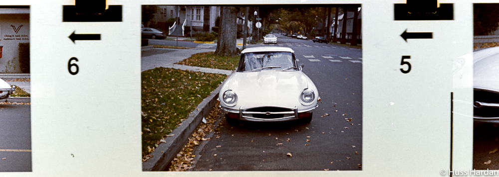

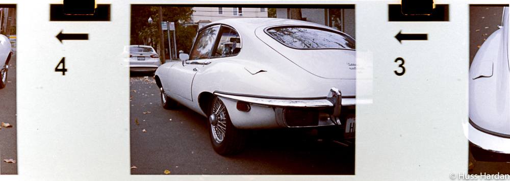

Just developed my film. This cartridge of Fukkatsu was a-ok! So I'm thinking/hoping the previous bad experience was a dev error.
Rollei A110, Fukkatsu 400
I have two Rollei A110s. Ridiculously well made over built cameras. Superb lens with zone focus, AE exposure.
They feel very solid and well made.

That's too bad. I have two, one in perfect condition, and the one I used in the pics above has a dent/gash on one corner where the previous owner dropped it onto concrete! Still works perfectly.
It would be cheaper to buy another one than get it serviced. But it is nice to fix things.
Really nice pics on the Fukkatsu 400!

Thanks! And yes about watching stuff. I was watching a 3D printed grip for a Pentax LX, when the seller then offered it to me at half price.
@Huss theyve come out really nice. Very sharp and lively.
Thanks! This was my second cartridge from the batch, and the first one was terrible so I have to think the shop messed up the developing.
Sigh of relief as I have a bunch left!
