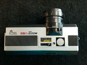

No one's mentioned the Pocket Fujica 350 zoom- I've only run a few (expired) rolls through mine and have only had one developed so far, but definitely sharper than a point and shoot.

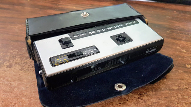

Found this online at a local estate sale for $20 CAD (~$15 USD) so I decided to grab it although I think a zoom model may still be in my future. It's in really nice shape.
When I was a kid my 110 camera was a Kodak Ektralite 10. This is way better spec'd
Kodak Ektralite 10
25mm f/8 fixed focus
1/125 or 1/250 mechanical shutter speed
Built in flash
Kodak Pocket Instamatic 50
26mm f/2.7-17 scale focus lens
10s - 1/250 electronic shutter with auto exposure
Flash cube, cable release, and tripod sockets.
Definitely has some weight and subclub.org says
"Some describe it as frighteningly sharp."
So that seems to fit the bill! Assuming I can find a battery...
