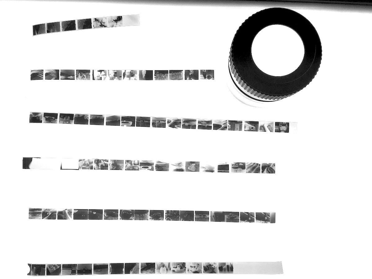

Thanks for the explanation. I shot my first roll of cut Kentmere through my Minolta 16ii with disappointing results. Not very sharp at all plus other issues. I didn’t use any add on lenses so I tried to shoot at high f stops to maximize DOF.
