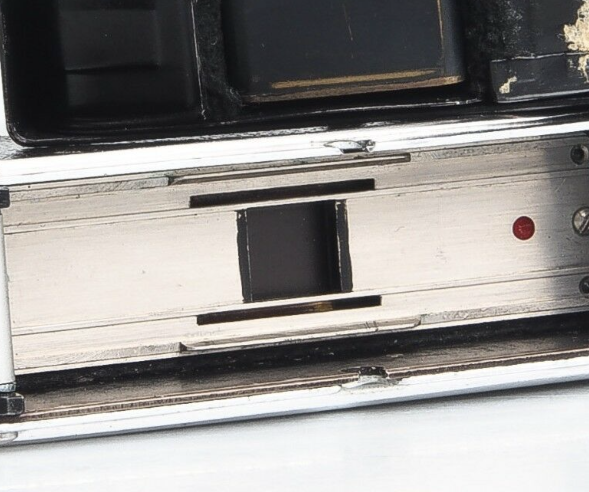

Theres a number of 16mm cameras that need double perf and sadly some of those are at the top of the line models.
Mec 16 does and i think minicord does too.
Good pickup, thanks for the corrections. Looks like indeed, the film drive of the minicord uses both sets of sprocket holes. The sad thing about cameras that use the double perf 16mm is the opening is not much bigger than Minox (which expects film with no perfs.) 10mmx10mm vs 8mmx11mm.
I'd probably restate that the cameras with some sort of cam to space the frames can use the single perf film.

I dont know whether they used the double sprockets and the pressure plate to hold the film as tight and flat as possible. Mec prided themselves on the extremely high quality photos it could take, plus the lens was a focusing f2 rodenstock so it was a beast of a machine in specs (and size... its huge)
I dont think gami did tho and they were regarded as the ultimate 16mm cameras so im not sure how they did it but i think the italian military were quick off the mark with using subminiature cameras in modern warfare and surveillance so a lot of money was thrown at the problem.
