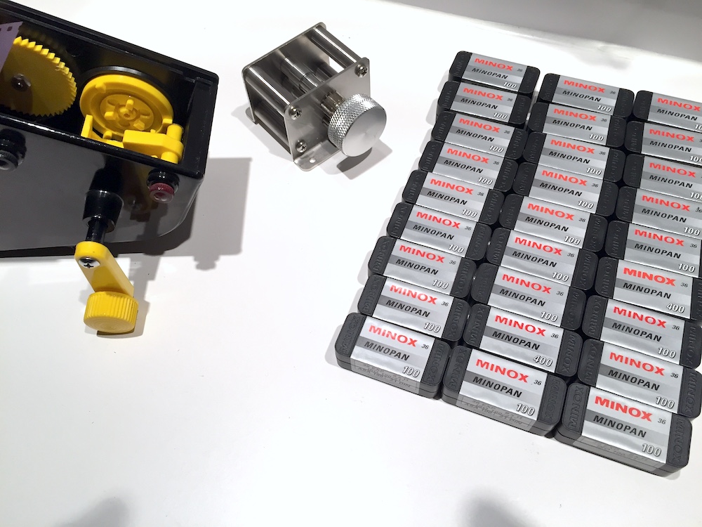

I posted this in a Minox thread, but, from what I recall, the manufacturer of this splitter makes a 16mm version. I did not get the 16mm version, because I have 200ft of single perf negative film, but if I ordered it again, I'd get the slitter that makes one Minox strip and one 16mm strip. This one makes two Minox strips from a single 35mm width.
First, with that many Minox cartridges, you must be REALLY wealthy.
And do you recall where you got the slitter? Was it a Jimmy Li model?

Yes, Jimmy Li model splitter. Got it this year so he still has the parts to make them.
