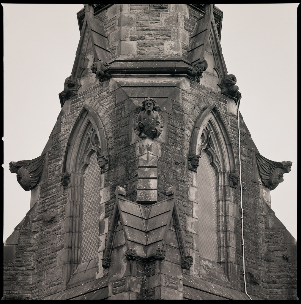

I have many 120 rolls of Copex Rapid stockpiled. Thus far I have only developed them in the recommended SPUR Dokuspeed SL-N. It would be nice to have a cheap, reliable alternative that comes close to its performance, as it's a very expensive developer: works out at about £7.50 a roll, which is a bitter pill to swallow! The results are hard to fault though:

These look great!

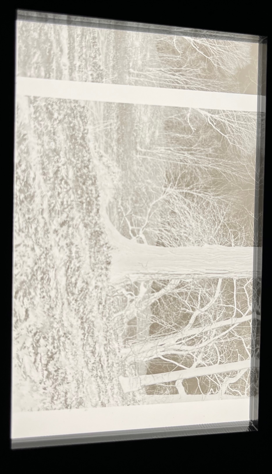

Just shot a roll of Copex Rapid in 120 and developed it in Caffenol CLCN. Just like the CMS 20 I developed in the same mix, the negatives came out alright but very thin. Anyone else have that experience? They scanned ok (though my fixer is clearly shot and I'm going to have to re-fix the roll) but it'd be nice to have a bit more to work with.

As you can see in the table of my post : https://www.photrio.com/forum/threads/agfa-copex-rapid-advice-please.196303/post-2633147
The instant coffee weight is not the same, the timing is not the same and the agitation scheme is not the same.
Oh, yeah, I should have been clearer. I definitely followed the instructions here for each individual film: https://photochemical.wordpress.com...t-developer-for-adox-cms-20-agfa-copex-rapid/
Possible issues I can see:
1. I used Arm and Hammer washing soda, which isn't totally anhydrous. Perhaps it needs to be increased a bit.
2. I shaved a smidge (about a minute for the Copex) of time off because my water was at 21c. I wouldn't think such a small amount would make a difference, but you never know.
Other than that...maybe I used the wrong instant coffee (Folgers Classic Roast) or my ascorbic acid isn't as pure as it claims?
The difference is quite a bit and the resulting pH will be too low. You need a pH in the high 9s to fully activate the developing agents in caffenol (mostly various forms of catechol. Ascorbic acid is super-additive with these). There is a lot of ascorbic acid in caffenol, which is obviously an acid, so if you don’t get the right amount of sodium carbonate, you will definitely have a pH that is too low.
The usual correction is 7% per degree C.
Hmm...I just popped some into the oven for a couple of hours, and it wound up losing almost exactly 10% of its weight. I'll add 0.5g next time and see how that works!
Ok so I overdid it a bit there too. I'm going to try shooting half a roll today and make these adjustments.
