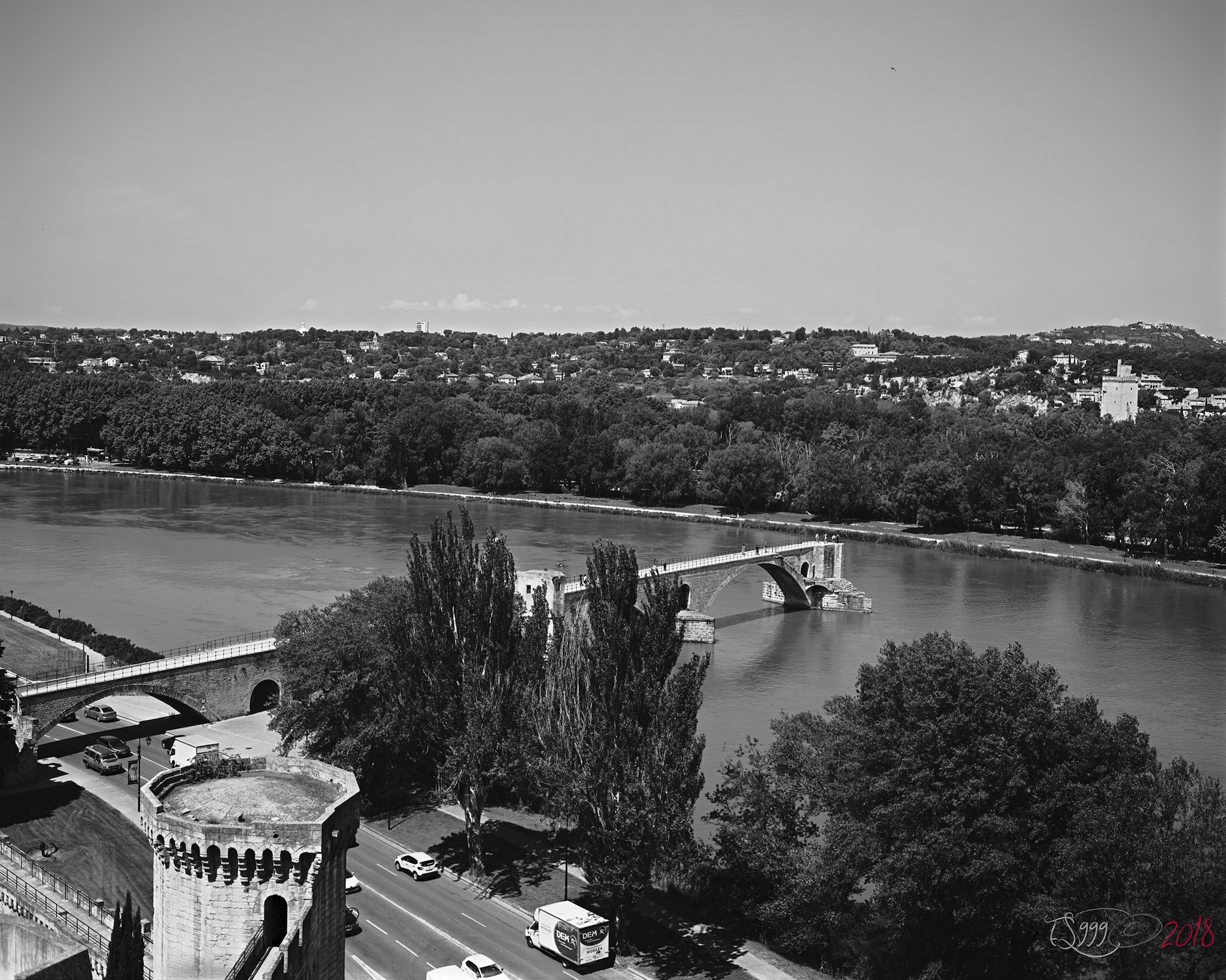

I have nearly no grain with CMS20 II and Caffenol CL-CN (or LC+CNew from Philippe May's site)
Plaubel Makina 67 • Nikkor 1:2.8/80
Adox CMS II 20 ISO film in homemade Caffenol CLCN 16min @ 20°C
Scanned with Plustek OpticFilm 120 at 2400dpi with Silverfast AI Studio
Avignon • Vaucluse • Provence • France
Caffenol CLCN
500 ml Filtered Water
5gr Anhydrous Washing Soda
1gr Vitamin C
6gr Instant coffee ("Winny")
60 sec. slow agitations then 3 times every 3 minutes for 15 minutes, fixing 60 sec.
