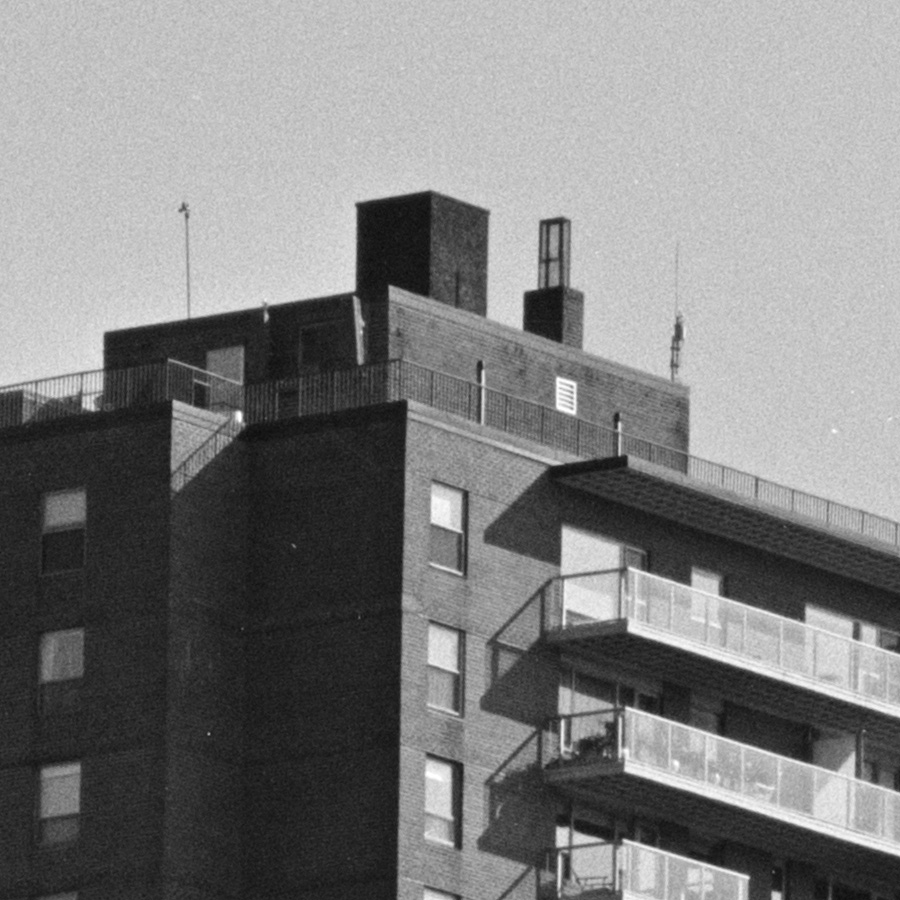

Full frame of a scan with my 'new' A7rII:
100% crop from that single-frame scan (this is with a Micro-Nikkor 55/2.8 AF) at...I dunno, 5400dpi:
And then with the PK-whatever extension tube, resulting in something like 8000dpi, oversharpened to accentuate the brick patterns, railings, etc:
Not unreasonable to think that more detail could be squeezed out of that with a bit higher magnification.
Ok, just because I know you all are soooooo interested...I picked up a super cheap M42 macro bellows and whacked my old Macro-Takumar (a perfectly serviceable macro lens but not great for film scanning) onto it. I suppose the resulting magnification is something like 2.8:1?
The full frame of this would end up being around 30000x20000, and totally impractical. Also, as you can see, not worth it. 2:1 (or the above 1.4:1 with a higher-res sensor) is probably the point of heavily diminishing returns for this film/dev combo. It does resolve that railing on the roof better than the A7r2 itself, though, but only because of moiré. I don't think it's unreasonable to call this a 36-megapixel film, which if you think about it is pretty impressive.

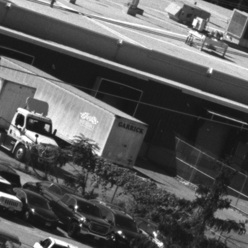

First, the full shot:

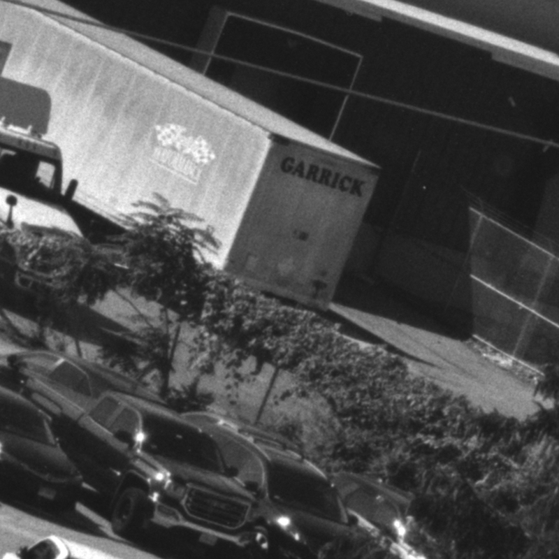

And a crop from the 1x scan, using a Micro-Nikkor AF 55/2.8 (originally 42mp, 7952x5304). Pretty impressive detail already, I think; if you apply a smidge of USM to it, it doesn't look all that different from a digital shot from the same camera.

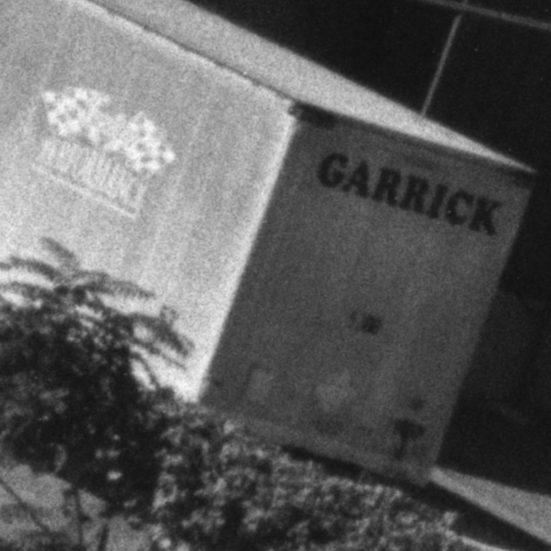

Same setup but with the M2 extension ring. I'm not exactly sure what the magnification is, but 4 stitched shots result in a 12739x8539 file, so let's call it 1.6x. Definitely getting a bit more detail in the white flag on the side of the truck, as well as the text. Not a huge jump, but not nothing either.

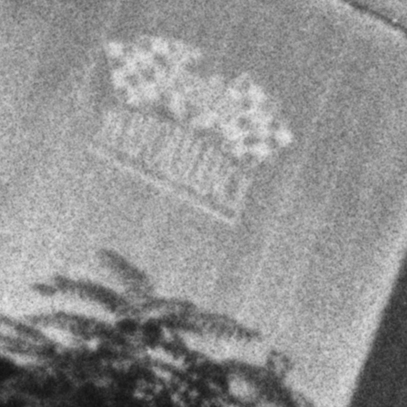

Now, with the new addition to the setup: a reversed Rodagon 50/2.8 on a Pentax m42 auto-bellows. Things are getting dicey here with plane alignment, etc, and this is pretty heavily stretching the bounds of practicality. It requires 9 stitched shots to cover the whole frame, and all of the variables in the platform-light-panel-film-holder-copy-stand-bellows-camera chain need to be perfect to make it work. Final file size was almost exactly 20,000x13,400px, so 2.5xish. 268mp! Again, not an overwhelming amount of new detail on the truck, but certainly more than on the previous magnification:

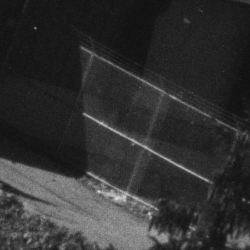

However, things get more interesting with the fence a bit to the right:
Finally, from the "ridiculous" category, I decided to have a bit of fun and use a 4x microscope optic. This is completely impractical, and it was a royal pain to even get the thing in focus with its insanely thin DoF. I'll put the previous crop and the new one side by side here so you can flip back and forth:
Did we get anything more out of it? Maybe? A tiny bit? Let's look at the fence:
A bit more! Also worth noting that even that 4x shot, if the microscope lens had better "sharpness coverage," would be a totally passable 8x12 print despite being a 15% crop of the original frame. Cool!
