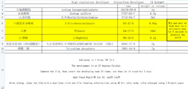

Does anyone want to give it a try?

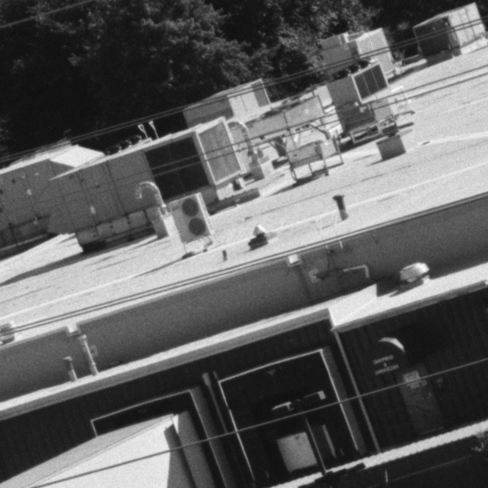

The biggest problem with both of them is edge effect. Definitely worse with CMS than Copex, but present in both. Anyone have any idea how to reduce that? Here's a relevant CMS example:

That looks like a variation on Mackie lines. I'd start by increasing agitation and commensurately reducing development time. If you're agitating every 3rd minute (as I've done with LC+C or high dilution Parodinal), changing to every 1 minute and reducing time by about 30% as a starting point should greatly reduce that edge overdevelopment.

Thanks for that, Donald. So...I think next time I might try halving the agitation intervals and reducing time by 20%, then work up from there.

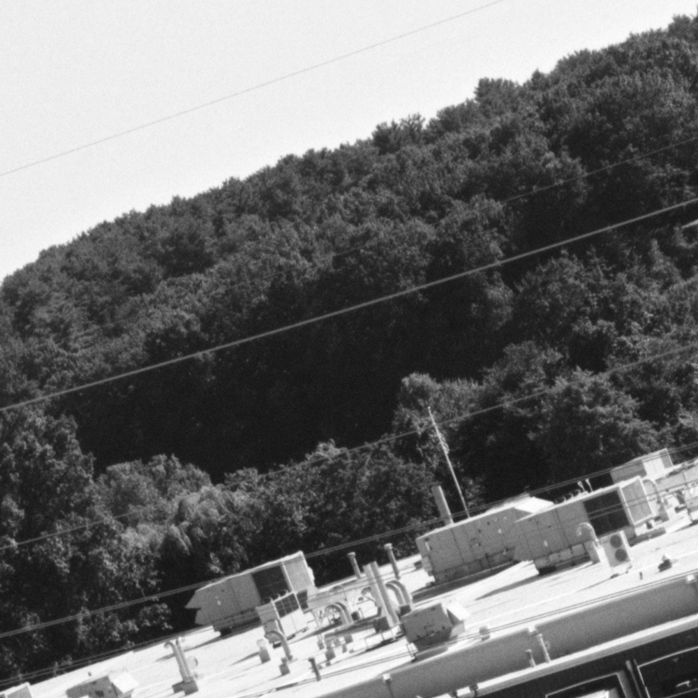

The first two are Caffenol devs, both on grey days. Not really fair, since my HC-110 roll was in sunny weather, but what can you do. Note the heavy edge effect on the first shot. I had better luck with the roll that the second shot came from, but it was still noticeable in some frames.

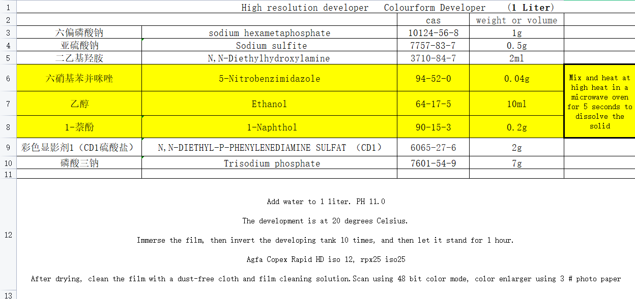

1-萘酚好像是一种彩显成色剂,在显影过程中会和彩显剂(CD-1)显影产生的副产物结合生成染料,配方里的六硝基苯并咪唑应该是抗灰雾剂,N,N-二乙基羟胺不知道是什么用途。
最后的结果应该是一层银盐影像和彩色影像的叠加,但是1-萘酚似乎是蓝色成色剂,不知道是否会对可变反差放大产生影响?
No, it doesn't have a flux capacitor. the 1st part sounds like benzo 1.4.
