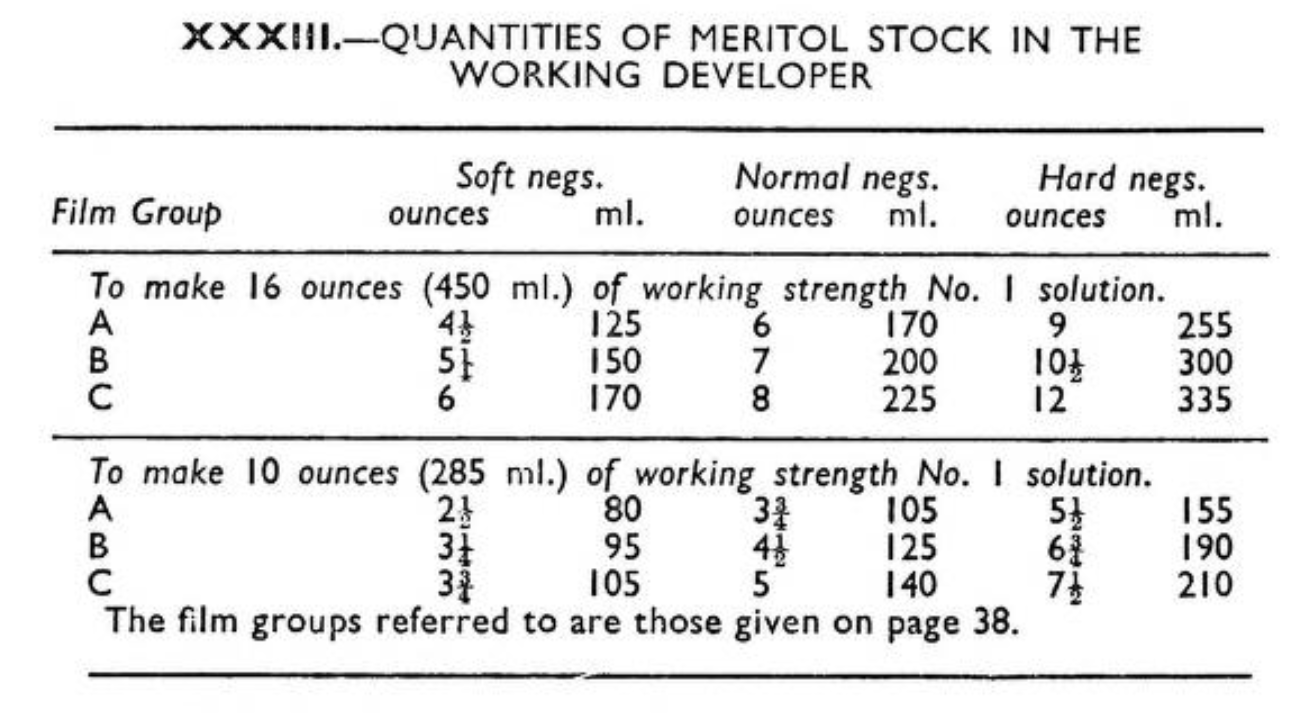

Not quite true at least with 2-bath developers of yore. Here's data for Meritol-Caustic 2-bath developer and you can see it is not one size fits all situation with this developer.
Interesting reference and a good point, I didn't respond to this part either: with divided developers like 2B-1 vs "true" two bath developers, you have as much control as you want by changing dev time in A.

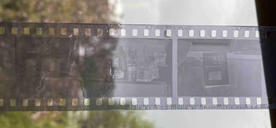

Well, I did some testing of that formula and even though it didn't go well, I'll post an update. Pleas nobody new show up on this thread, read this, and then troll me about not being successful while in the middle of experimenting.
Here's what I did
  1. I mixed up 33ml of the stock solution. Result: All the ingredients dissolve! This is a good start
  2. I used a 3:1 ratio of sodium sulfite to sodium metabisulfite.
  3. pH of the stock is 6.6, so just at the threshold for phenidone to become active
  4. There is still a small amount of development in A
  5. I mixed up a bath B from NaOH as discussed with @Raghu Kuvempunagar
  6. pH of bath B was 12.8, using 0.8g NaOH to 300ml
  7. I tested B with 20ml of carryover. It develops film like that. But very slowly. You would not get enough density to really see an image.
  8. While attempting to do normal development, I was not seeing a lot of density building on test strips, but given how much of an impact carryover apparently has, I tried with a short section of Ilford FP4+ because it's a "normal" thickness emulsion
  9. FP4+ at EI100
  10. Used 3.5 mins A, 3.5 mins B @ 20C
  11. Result: Very, thin negatives.
It may be that I needed to leave it longer in B. But what I saw from testing snippets of film was not much density change past about 3 minutes (eyeballing fixed results). It may also be that this is just not enough ascorbic acid. It actually has about 50% more phenidone than Relayer's developer. I left out the HEDP/Etidronic acid in this test. I don't know how much effect that might have.
