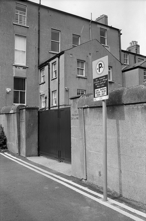

I put a roll of ADOX HR-50/Scala 50 through 2B-4 this weekend. I shot it at EI 25 because of my experience with it in 2B-1. I believe I should have shot it at it box speed in 2B-4 and would have had better results throughout the roll. However, I'm quite pleased how this turned out anyway. Here's a good frame that I liked.
Leica M2 with Leica Summarit-M 2.5/35mm. 2B-4 two bath for 3 mins A, 3 mins B @ 20C.
