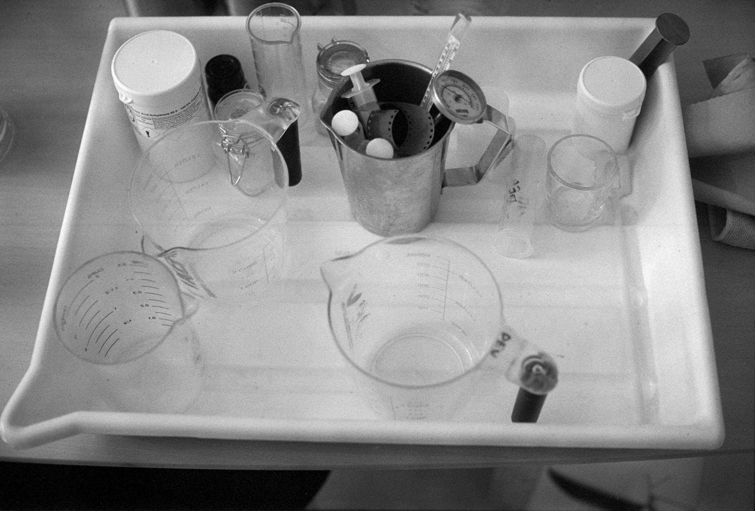

Sample Image
The following is not art, it's just a hard scene with backlighting to see how the developer would handle it.
Ilford Delta 100 @ box speed
2B-4 for 3 mins A 3 mins B @ 20C
Note that the acutance is quite good. You can read some of the tiny text on the bottle of sodium thiosulphate.
