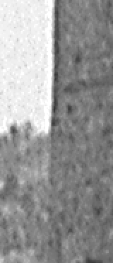

Thanks, and the advice and support are appreciated. I was just looking very carefully at the scan of that image and realized there is a noticeable edge effect happening. Take a look at where the edge of the tower crosses the landscape. The area by the sky (upper half of this crop) appears to have a noticeable edge effect happening unless I'm misreading this. The line continues below the tree line, but with a much less noticeable edge.
I may have to rescan to make sure it's not the scanner. Better yet, stick on the enlarger.

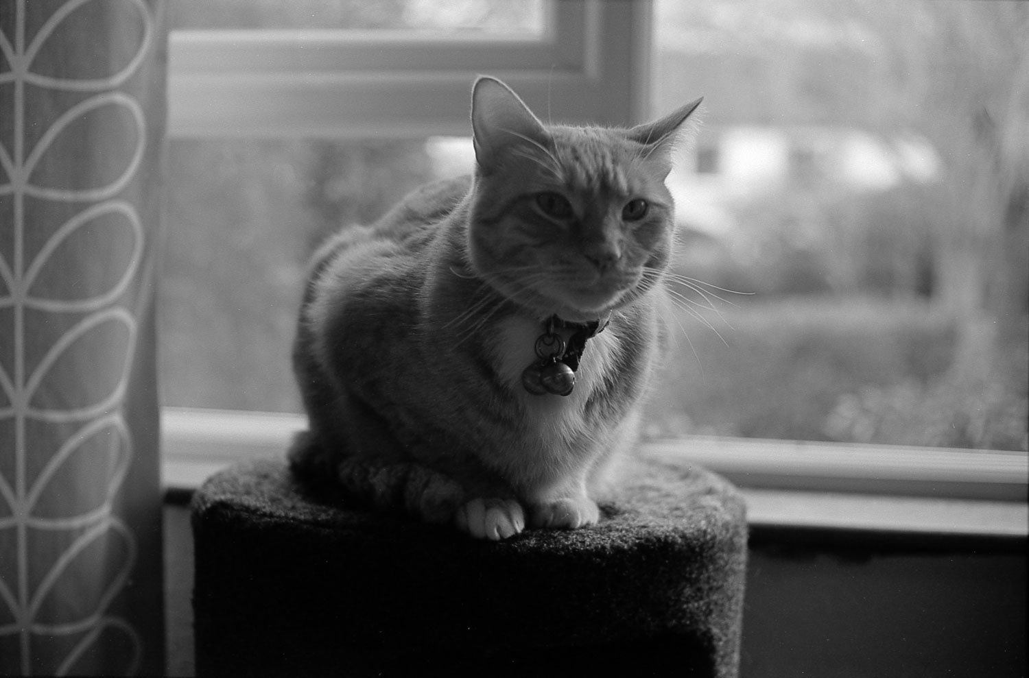

Here's a little update on this developer. The first batch is still working well, just developed some films this weekend. Here's a sample from two weeks ago, on ADOX HR-50, a high contrast film, intentionally shot with high contrast and backlighting to push the developer kind of hard. This was developed 6 mins A, 4 mins B @ 20C. I'm quite happy with the results. I think I would shoot it at EI25 or 32 next time.
I have developed a way of getting very close to a correct dev time for new films using a two bath. I test a leader clip at 4 mins, then 5, longer if needed and then always 4 mins in B. When the A time is enough to produce the deepest black it will give, that's the time I use. I don't have a densitometer so I have a light that I know I should only be able to see the filament through. If I can see the edge of the bulb it needs more time. The compensating effect takes care of getting the mid tones and highlights on track. It takes 15-25 minutes or so to get a time that will work and then I just plonk the roll in and go.
I got a decent pH meter this weekend and on Saturday I will calibrate it and get a reading to see what the actual pH instead of just from the paper strips.

Relistan have you discovered where the edge effect you mentioned comes from? The cat is saying "I hope this portrait gives me that high contrast noirish look. I have always wanted to catch a "Maltese Falcon" :D
So for goodness sake do not show the cat this portrait with its fine detail and full tones :D
pentaxuser
HAHA, indeed, that would be a terrible mistake!
Regarding edge effect: I inspected the negatives with a loupe and it looks to me like there is an edge effect from the developer, but it was accentuated noticeably by sharpening in the scan. The negatives look OK. I have, however, increased agitation in the second bath to 1 inversion a minute, with 2 at the beginning. This seems to have reduced it to normal levels while still fully developing the negative. The cat photo was developed in this way and everything looks good.
