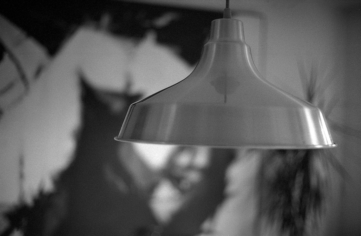

I won't post the formula until I'm happy that I've achieved that. But this is a test shot from the first partial roll I put through it. Looks pretty good. Nearly the same as 2B-1, still sharp.
This is Fomapan 400 @ 200 (how I always shoot it) in my Yashica Electro 35 GSN (which I usually use for testing). 5 mins A + 4 mins B @ 20C.
The tonal values look good. There is grain, but Foma 400 is a rather grainy film to begin with. Plus, being 35mm doesn't help hide grain.
Thanks. Yeah the solvency is about the same as D-76 1+1. But the pH is lower in bath A (about 8.0) so the effect is that it’s a little better than that. I like sharper negatives and I think it’s close to right for me.

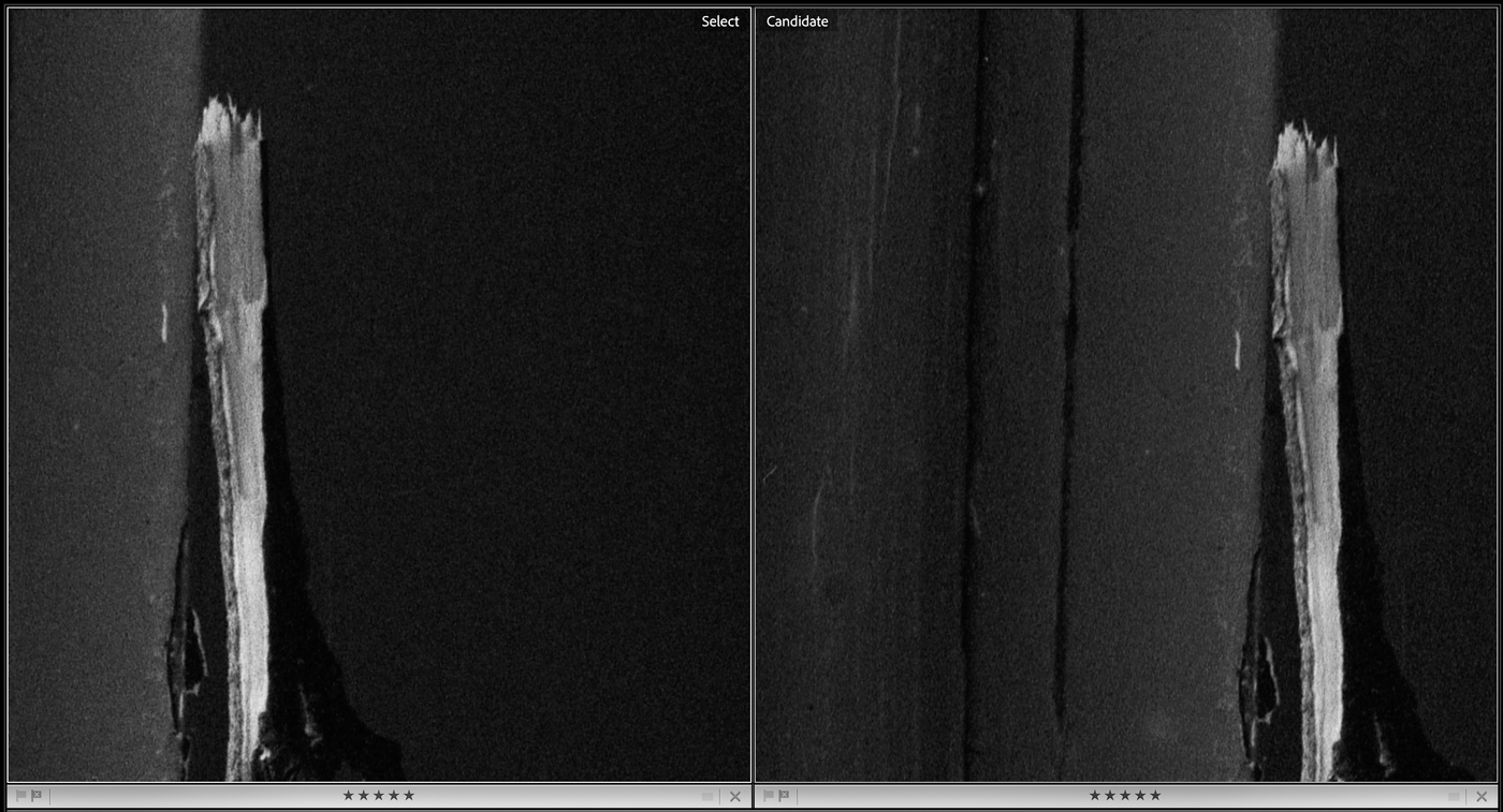

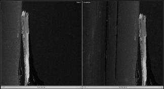

Shown here is a screenshot from Lightroom, with a 66% zoom view of two sample scans from a 120 roll of Tmax 400 (TMY), exposed at 250 ASA and bracketed +1/2 stop and -1/2 stop. The roll was cut into two pieces and one was developed in Thornton 2 Bath (4+4 minutes) and the other developed in Karl's 2B-1 (4+4 minutes) I selected the best exposure from each half of the roll to scan at 4800 dpi (the best Thornton neg was the one that received +1/2 stop more exposure and the best 2B-1 neg was the one that received 1/2 stop less exposure).
The sample shown here is from the unprocessed scans, where the only difference is that each scan was adjusted to place the highest and lowest values at the same point on the histogram. Note the handling of the high values in the neck of the bottle, the tonal separation, and the visibility of the grain. The Thornton negative is on the left and the 2B-1 negative is on the right.
The Thornton negatives were a bit thinner than I prefer, because I typically process TMY at 5.5 to 6 minutes in Bath A and 4-5 minutes in Bath B, but as both developers were the Divided type, I wanted to use the exact same times in both, for comparison.

I've compared it with PMK and Thornton 2-bath developers, and 2B-1 definitely gives a boost of film speed compared to these other two - as much as a 50% increase over box speed. But in my tests, that speed boost comes at a cost: conspicuous increase in grain, and a comparatively harsh handling of the highest values. It is definitely worth exploring for certain types of photography, especially if you need to maximize film speed, but it's not ideal if the rendering of delicate, nuanced tonality is of high priority.

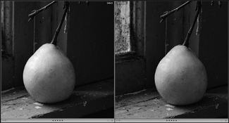

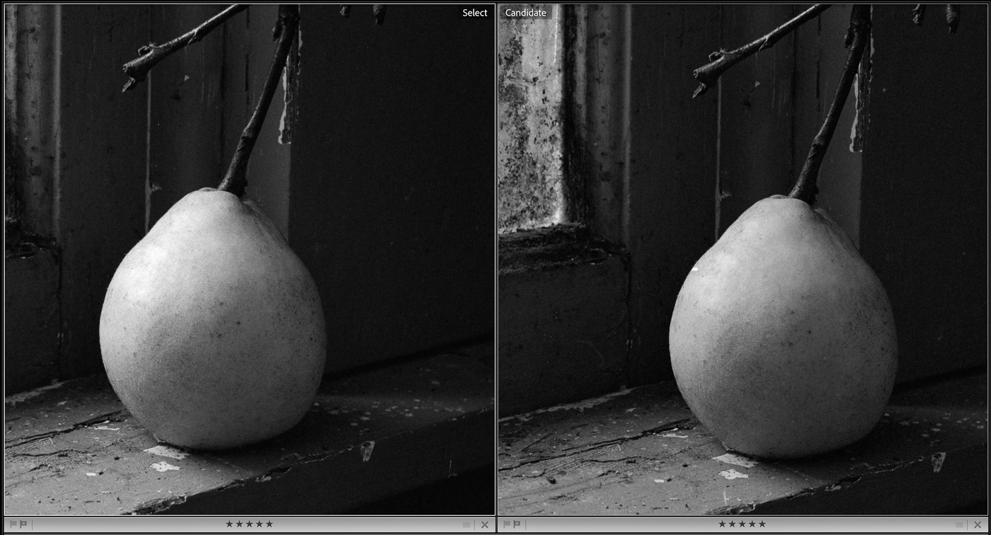

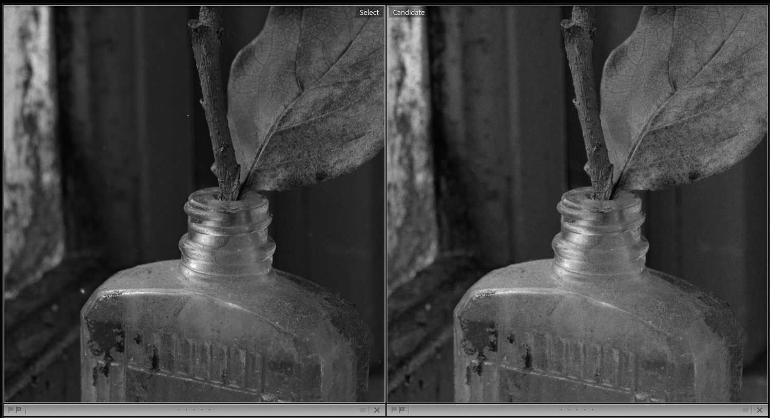

I did another test with a roll of Tri-X, rated at 250 ASA and bracketed plus and minus 1/2 stop, then cut the roll in half and developed one in 2B-1 for THREE minutes in A and B, and the other half developed in Thornton 2 Bath for FIVE minutes in A and B, as I normally do. Adjusting the times of each developer seemed appropriate, given the dramatic difference between the two results I got yesterday. As expected, this reduced the difference between the two negatives, but did not eliminate those differences.
In these screen shots from Lightroom, the 2B-1 negative scan is on the left and the Thornton 2 Bath negative scan is on the right.
Adjusting the times gave me negatives that were nearly identical in grain characteristics, with perhaps a slight exaggeration of grain in the 2B-1 negatives. The most notable difference was that I perceived an overdevelopment effect still in the 2B-1 negatives: the middle-to-high values had still reached a point of excess for my liking, though the handling of the very highest values wasn't as abrupt as the highlights in the negatives developed for 4 + 4 minutes. I still had difficulty scanning in the shadow information on the 2B-1 negative - it's as if that developer shifts the film's curve, making shadows drift further into inky blackness, and in spite of the highlights being held in place, the mid-to-upper values had an exaggerated separation going on. Acutance and sharpness was about equivalent in both negatives.
I can see 2B-1 being used in some scenarios where boosting tonal separation might be an asset, but for me, it created too much of a graphic contrast look to it. I'll stick to BTTB and PMK, I think.
That said, I'm very glad people like Karl are taking the time to craft interesting developers to explore!
