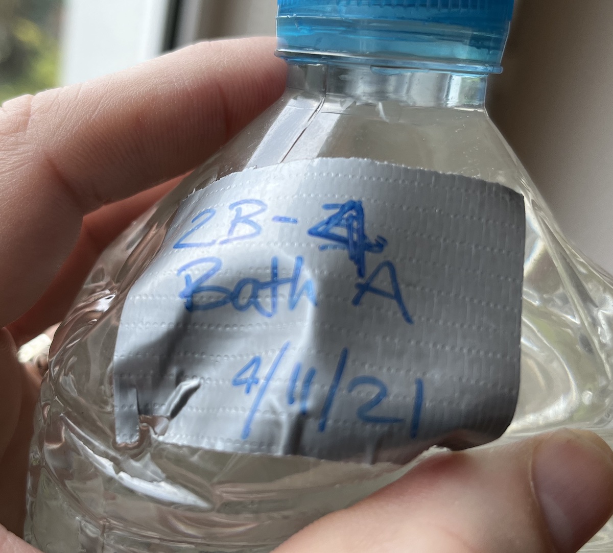

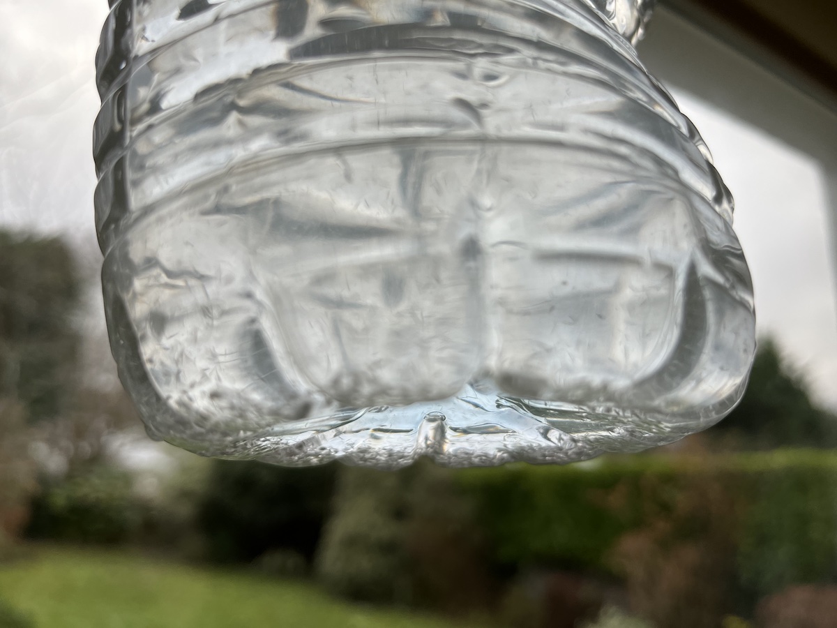

A small update here. I had a bottle of 2B-4 bath A that I mixed April 11, 2021 sitting on the shelf. It was stored in a PET bottle with almost no air in it, in a brown shopping bag, on a shelf where the room is lit by weak sunlight. pH was 6.8 when stored. My meter is broken now so can't tell now, but looks similar on paper test strip.
There were what appears to be crystals or mould spoors in the liquid. I thought at first it was phenidone crystals and I attempted to crush them, but they were mushy under the stirrer, and did not go back into solution, so guessing mould.
However, the developer was still able to darken down film, albeit more slowly. As you can see the bottle is still clear, not yellowed. It was more weakly able to develop film, so some loss definitely has occurred.
This is interesting, I am posting only because it might be interesting to attempt to preserve an ascorbic acid developer in acidic conditions, probably a little more acidic than 2B-4.
Repeating here the formula for this A bath for purposes of clarity about what was bottled.
2B-4 Bath A:
  • Water — 700ml
  • Sodium sulfite — 35g
  • Phenidone — 0.5g
  • Ascorbic acid — 12g
  • Potassium Bromide — 0.2g
  • HEDP/Etidronic Acid ("Fotoplex 2") — 5ml
  • Water to 1L
