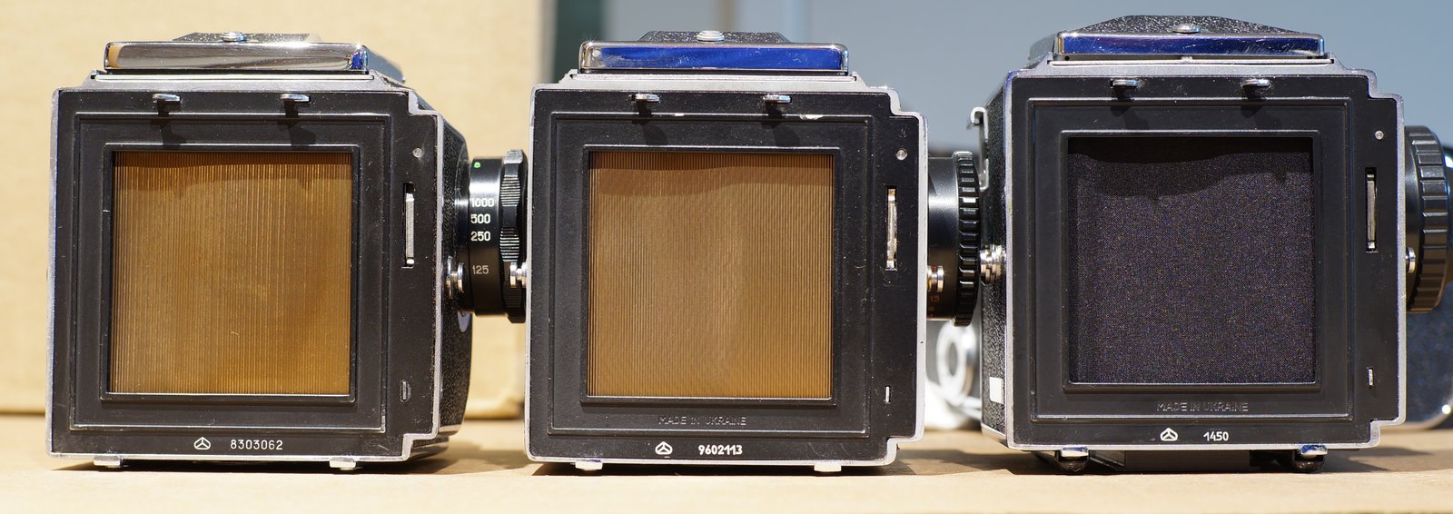

3 decades of Kiev 88's...
Soviet on the left, and 2 Ukraine versions.

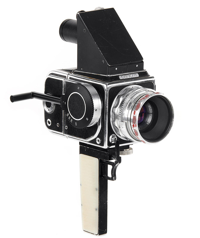

In space
Just like their swedish ancestors, the Salyut cameras went to space several times, in 1964, 1966, 1967, maybe other years.
Pictured is the Salyut-1B
