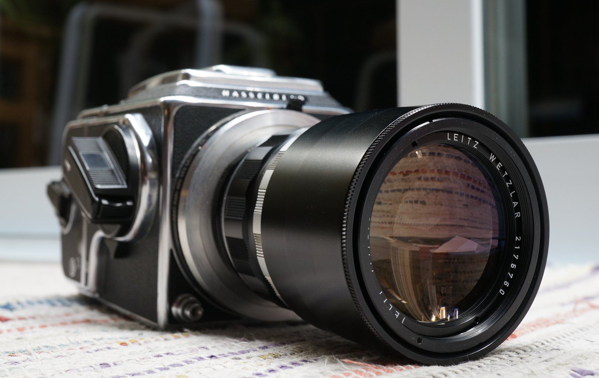

200mm f/4

200mm f/4

Looking at the size of that 200, i don't think the wide open performance at the corners would be as good as a real 6x6 200/4mm lens.
I have a 200/4.5 lens for the Bronica ETR system (6x4.5 format, smaller than 6x6). This is a lens for a smaller format and slower, yet it's bigger than the 200/4 Leitz pictured.
The fact that it covers 6x6 doesn't mean it would do it as well as a real 6x6 lens.

The Leitz 4/200 above has better image quality than the Volna’s I have, and is close to the Biometars. At the time the Leitz 4/200 was produced, there wasn’t much available for the Hasselblad (135 sonar), so it was a viable option.

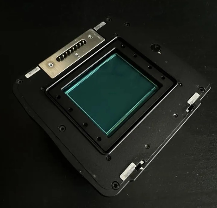

This is my 1983 KueB body with a Phase-One P30 digital back. It triggers off the FP shutter sync, which none of my later bodies have (they only have "X"), so I get full functionality. I had to widen the film gate a bit, as the original Hasselblads (1600f & 1000F) had a smaller film gate which was copied by Kiev - the Hasselblad backs fit all the bodies, but the P1 digital backs require the larger film gate.

I inherited a Kiev88 camera with an X-Fp switch, and I would like to know how you adapted it to work with the Phase One P30.
Do I need to modify the camera itself?
What kind of sync cable did you use?
There is a Phase One P30 digital back for sale in my city now, but I don't know if it will work with the Kiev88. Here is a photo from the seller:
I would be very grateful for any information or help.
Unfortunately no, that is a digital back for a Hasselblad-H camera, you need a back for the Hasselblad-V bodies, as the Kiev is a close copy of one of the early models.

The P30 pictures I have are in this thread.
But I'm guessing you are interested in the interface of the back, which can be seen on the internet by searching "Hasselblad V" and "Hasselblad H" digital backs. Here are 2 pictures off the internet:

The Hassleblad V digital backs are unique in that they have a mechanical wake-up sensor when the shutter button pin enters the back.
