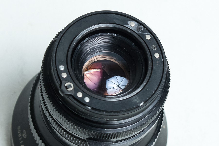

Lens mount
The semi-automatic lenses (a) cannot be mounted in the Kiev-88 unless the diaphragm actuator at the rear of the lens is removed.
That's interesting, I did not know that. I have a semi automatic Industar-29 that worked fine on all my Kiev88 variation - it did not look modified, and the semi automatic aperture function worked fine. But I have since removed it as the huge flat spring that closed the aperture when triggered created a great big "whack!"

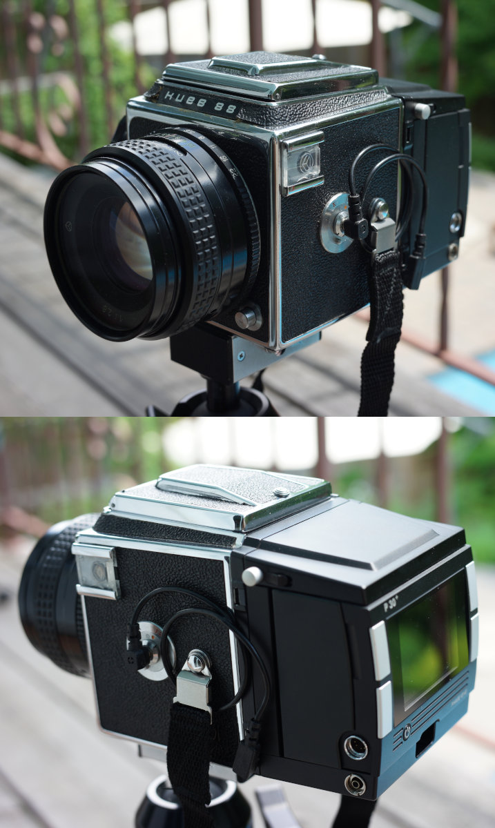

Here's a related "project" I've been working on...
This is my 1983 KueB body with a Phase-One P30 digital back. It triggers off the FP shutter sync, which none of my later bodies have (they only have "X"), so I get full functionality. I had to widen the film gate a bit, as the original Hasselblads (1600f & 1000F) had a smaller film gate which was copied by Kiev - the Hasselblad backs fit all the bodies, but the P1 digital backs require the larger film gate.
Eventually, I'll modify my 88cm to an FP sync, that way I can use the better Zeiss lenses. The above setup is let down by the optical quality of the original K88 lenses - which are good but not great.
Then I'll modify a Hasselblad 2000 series for FP shutter sync so I can use a 2/110 - and look for a P45/P65, and...

Thanks for replying! Lots of great information here. Some questions:
- Did you like the Industar-29?
- Amazing that the semi-automatic aperture system worked. I've been examining Salyut, Salyut-C and K88 bodies and what I saw so far is that only the first to have an additional notch on the mount, which I believe is required so the aperture actuator can pass through the mount. You'll see some people mention that you require to remove this actuator on the I-29 and other ancient lenses to make them fit the Kiev 88.

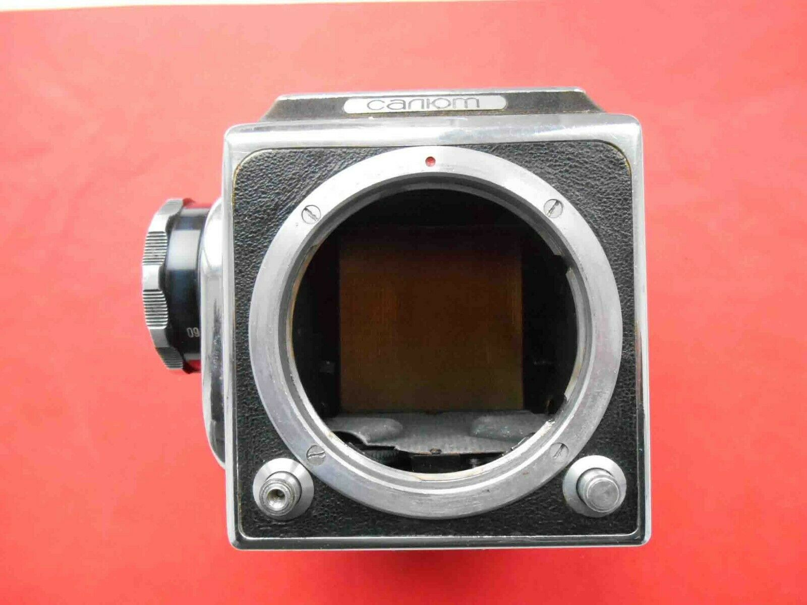

Kiev 88 from 1982 -- only one notch, at about 2pm:
Salyut camera: Two notches 2pm and 4pm.

Industar-29 - Optically, not a great lens, lots of spherical aberrations wide open, and never gets that sharp. Mechanically, it's great, better than the later lenses. None of the f/2.8 Tessar's for MF were that great, it was pushing the limits of that 4-element design. I also have the Tessar 2.8/80, and it is better, but it's also quite radioactive - it's one of the hottest lenses I've measured.
The notches on those mounts are for the lock pin. The pins on the Kiev lenses are taller than those on the Hasselblad version, so they interfere if you try to put them on a Hasselblad. The Kiev mount threads also start a little earlier in the mount, so the Hasselblad lenses have to turn past the lock pin latch to seat properly. I talked about using Kiev lenses on a Hasselblad 1000f on the other form:
I do not know what the second notch is for on the Salut, the only lens I have from that era is the Industar-29, and it only has one pin there.
The semi-automatic aperture pin is the same pin as the fully automatic aperture pin for the later lenses, which is on the back on the lens. There is a tendency for that pin to jam inside the Salut/Hasselblad body on the horizontal shelf inside the mount at the bottom. I think this is what you may be thinking of - the later automatic lenses with the aperture pins will jam on the original Salut unless you remove the pin. However, some of those lenses are designed that the pin self retracts when you open the aperture ring on the lens, so most of those lenses can be mounted on the original Salut, you just have to open the aperture to un-jam the pin, and you can remove the lens.

But there's only one lock pin, and the early bodies, as you can see, have two notches. The second one must be for the aperture actuator on semi-automatic lenses, I'd say. Please check picture:
You can see the angle between the two protrusions (aperture actuator and locking pin) is similar to the two notches on the Salyut and Salyut-S camera mount.
Ahh! It was you!! I did find your post days ago and wanted to find them again, so BIG THANKS.
I get really confused here. The automatic lenses have a pin on the back of the lens that has a natural tendency to push out (and close the iris). The camera body keeps the pin in, but at the moment of taking the picture it lets the pin pop out. Thus, the iris closes.
The semi-automatic lenses don't have such pin, please see pic above. Thus, i'm very confused.
Ah, this is great info. The Salyut manual, and the Salyut-S manual, talk about the conditions that must be met for the lens to mount and they mention this. In my experience very very few people bother to read manuals, this would explain everything.
The manuals also don't mention (so far) compatibility issues (or absence of issues) between the older semi-automatic lenses and the new bodies.

I dug out the semi-automatic aperture mechanism from my parts box, and it indeed resembles the mechanism above. But I clearly remember shooting with the lens on my Kiev-88's, with the mighty thwack of that mechanism when triggered, so I re-installed it. And... the lens still mounts on my bodies, which do not have the second notch in the mount. When mounting, you have to tilt the lens a bit to get that tab past the threads, but one past, it mounts normally. Not sure if that works on all variants of this camera.
The mechanism to activate the aperture mechanism is the same for both semi-auto and auto, the plate in the camera pushes the pin in to open the aperture. In the semi-auto mechanism, that plate pushes the rod (where the c-clip is) up against the back of the lens, which allows you to arm the spring. When the mirror goes up, the plate in the body allows the pin to extend out, and in the case of the semi-auto, that rod where the c-clip is pops out releasing the spring loaded aperture mechanism.

That's pretty ingenious. How much lead time do you need (5 msec?) and how do you modify it for FP shutter sync? Bending a mechanical contact so it closes earlier? I wonder if it would be possible to build the lead time into a cable release, so that the cable release closed an electrical contact shortly before firing the shutter. Ah, I just realized that is exactly the function of a Graflex solenoid.

Well, that would explain why it can mount: because you're carefully circunventing the limitation of the one-notch mount...
EUREKA
Thank you very much. This is new information not found elsewhere, at least not in english (and believe me i've been searching through some russian forums too).

He probably means putting the switch from the earlier Kiev 88s inside his Kiev. Earlier Kiev 88 cameras, as well as the Salyut-S and Salyut, have FP sync. This is achieved by an internal switch that has contacts for both FP and X. So it's just a matter of fitting the correct switch inside the camera and wiring it.
Moreover it's highly likely that the switch is already there, and only needs a lead to be connected.
<snip>... How much lead time do you need (5 msec?) and how do you modify it for FP shutter sync?
Hasselblad digital backs specs want a 40ms pre-trigger for the shutter. Basically the back needs a shutter trigger before the focal plane shutter starts to open, that way the system can detect an exposure.
That is why I was using my 1983 body, which has a X-FP sync selector - the FP was for flash bulbs. The FP & M syncs closed before the shutter starts to open, which allows the flash bulbs to come to full brightness before the film gets exposure. FP and M have slightly different delays, depending on the type of Flash Bulb and shutter (leaf vs focal plane).
My later Kiev88 bodies only have an X-sync, hence my thoughts of modifying them... Modification would require the connector to trigger before the shutter opened - much like the 1st curtain flash sync on digital for HSS flash.
Similarly, I can use this digital back with Hasselblad CF lenses on a 2000F body by using the Focal Plane shutter X-sync, and exposing with the leaf shutter. Some early 500c bodies also had a barn door shutter sync (for microscopy and astro work), but I don't have one of those to try (yet!). But that is off topic!
As you can see above, the FP delay is about 16mS as per the specs of the camera.
Often, the delay for FP is that short or even shorter, usually FP is triggered just before the mirror rises (or even after...)
The Kiev 88 service manual says 16mSec and i'm betting that that's the curtain travel time too. So this would mean that the FP contact is triggered before the first curtain opens, but after the mirror rises. Perhaps you can try fitting a new switch that closes before the mirror rises, and thus gain more delay.
40mS is a LOT of time... to put into perspecitve, M-type bulbs reach their peak after 20mSec. Cameras with variable delay, like the Zorki-4, doln't have that much time. The Zorki has 25mSec max.
The other option, and it's doable (pun intended), is to relax the curtain tension so the FP delay is longer too. You will lose the top speeds, and the X-sync speed will be lower (say, 1/15, 1/8), but it would work, and if the camera is well lubricated the camera should still work.
40ms is just the spec for digital backs on Hasselblads - which means the back is expecting to get triggered 40ms before the exposure. But you can use a shorter delay - it really just needs to trigger before exposure starts. This is only for Focal Plane shutters, when using leaf shutters, you can trigger off the X-sync.
The spec for M sync is 20ms, which is the flash bulb sync on Hasselblad leaf shutter lenses. S-sync is longer, and F-sync is shorter. FP stands for flat-peak, which is a flash bulb for shutter speed faster than the X-sync of focal plans shutters.
Saddly, I've used eash type of flash bulb! (You could get a box of them for pennies at swap-meets when I was a kid!) FP flash bulbs were actually useful - and is the same idea as HHS flash on current digital cameras.
40ms is 1/25 sec, which is about the time it takes for the mirror to go up. Some of the really old digital backs probably needed 40ms to trigger... 1/25th is also the X-sync shutter speed on old Kievs

I don't have sheets of flocking material because I usually service cameras that don't require additional flocking...
As for painting diaphragms, so far the methods i've found for chemical blackening are not easy. Painting would produce paint dust, yes, this is a minor problem (dust is of no consequence). The major problem is that the leaves would probably not work anymore, or work too slowly (they need to slide against themselves).
I've seen some people paint such blades with permanent markers, it works (and reduces reflections), no dust generated, no problems. But it looks a bit tacky.

I just received a Kiev 88 (Kueb 88). I'm pairing it to a Kodak Ektar 80mm preset lens from the 1600f/1000f era (1949). A 4/3 Tessar that's presumably better than the Zeiss that followed it. Had to relube the helicoid on the Ektar, it was very stiff.
Shot a roll despite the back having issues (sigh... at least the shutter is ok). The lens needs to go past the lock and focuses a bit passed infinity. Looks pretty good at infinity and need to test it further for portraits.
