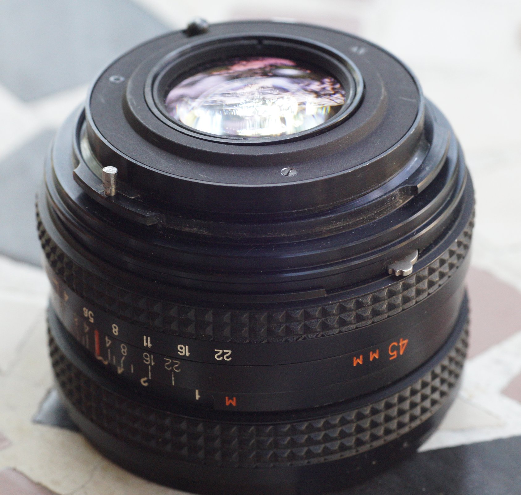

The K88 and P6 mounts are very close, the open aperture pin is in the same location (although not always the same travel). Since the K88 threads are a smaller diameter than the P6 breech mount, you can make an adapter to fit a K88 lens into a P6 breech mount. Here is my K88-P6 adapter.
Here it is mounted on the lens.
I've never had a K60, so no idea if you need a replacement lock ring.

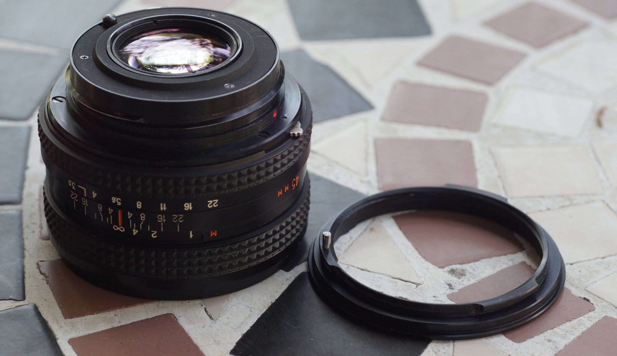

I changed the mounting ring and use the very thin adapter ring. Very simple modification that won’t affect the “normal” operation.

The mount itself is not replaced; only the mounting ring. Unscrew a small grub screw, unscrew the ring, replace it with a slightly thinner mounting ring and tighten the grub screw. Place the thin ring with a stud for the aperture actuator on the lens you wish to use and mount it.
