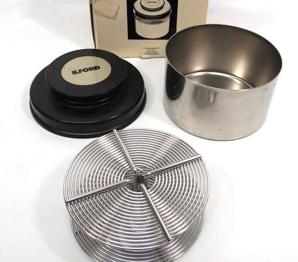

I recently picked up the Ilford Stainless Steel reel for 72 exposure loads.
Now just waiting for the film.
They are nice reels( Hewes) that can be used for 36 exposure rolls too.
I have one plus the plastic version.

If that's of interest, I purchased a 72 exposures reel and tank which is useless for me. I've put an Ebay ad.

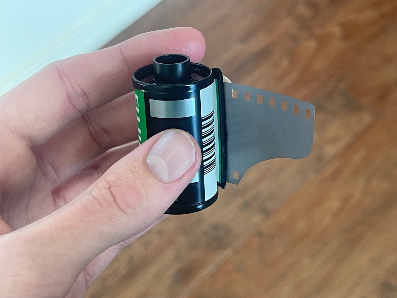

Well, I did it! I made the meme roll, lol. ≈72 exposures. Idk how many exactly because the film doesn’t play nicely with my bulk loader’s frame counting mechanism. But the can is basically full, I could feel it get slightly harder to turn when I made the last wind.

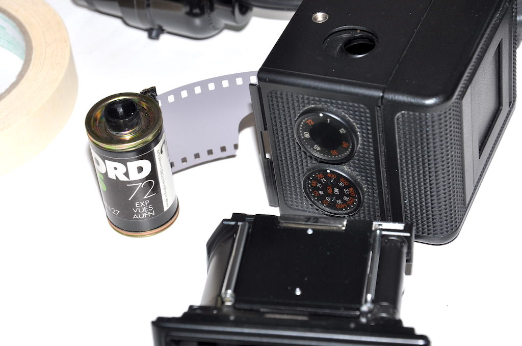

I wound 80 frames into this cassette. That should give about 72 exposures. Ready for testing. Notice this film back has a special pressureplate just for the thin 72 exposure film.

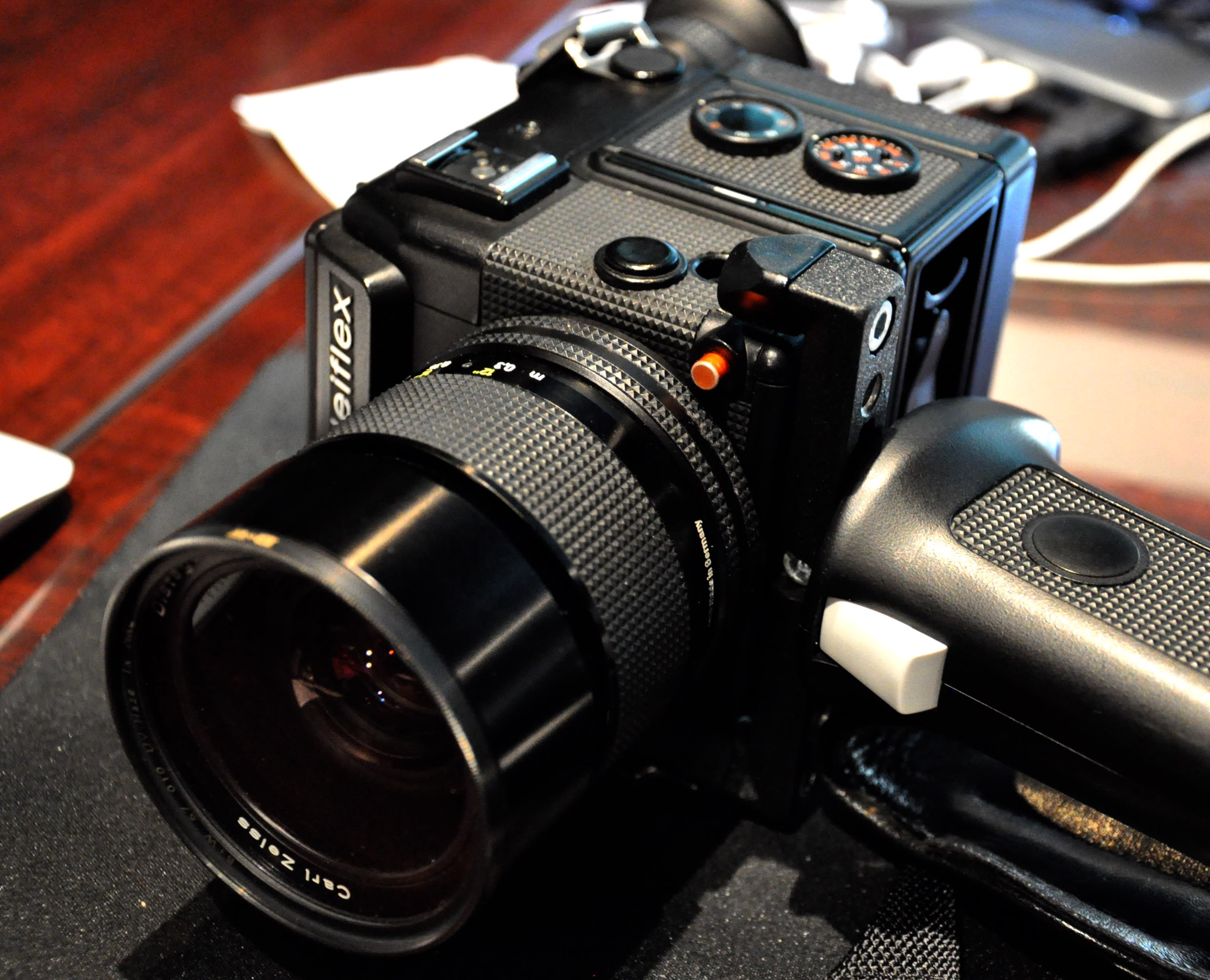

If indeed the film is fast, it should go well with this Carl Zeiss 35/1.4 lens.
