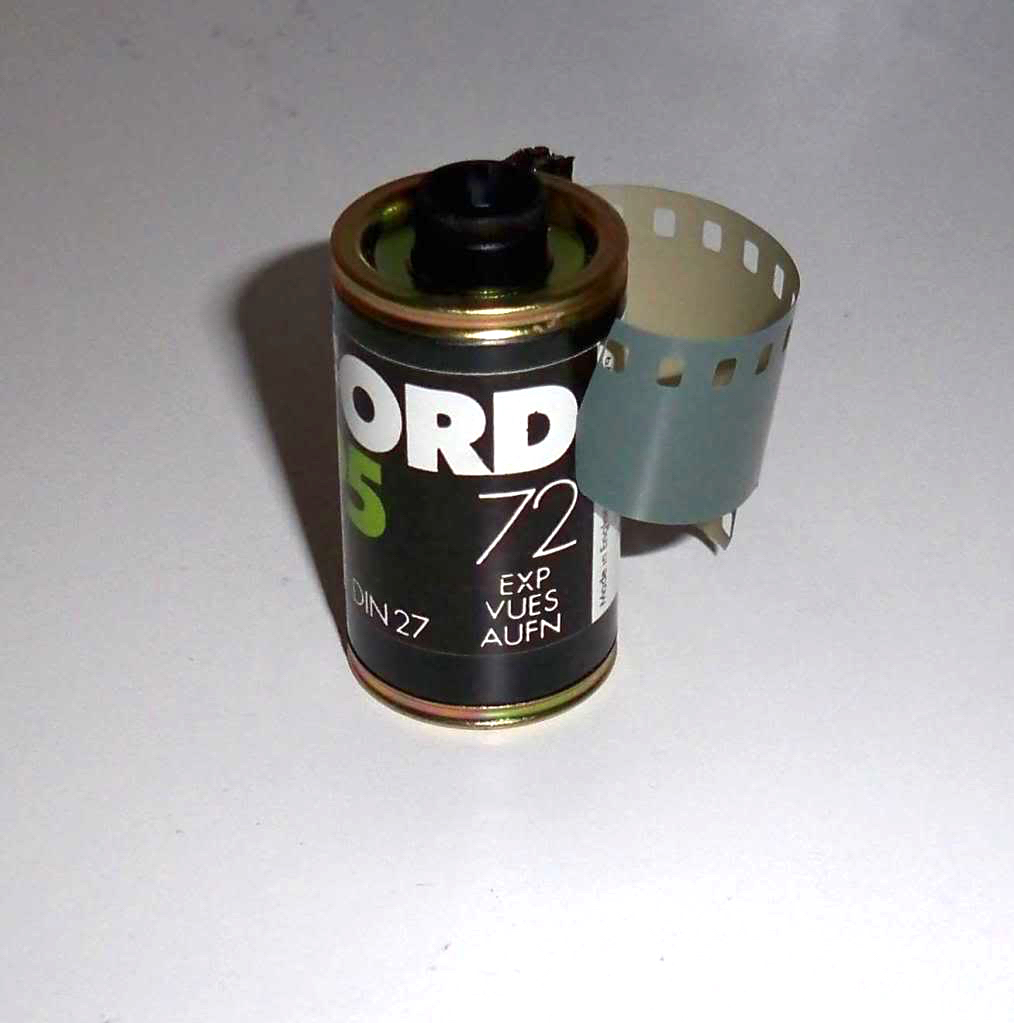

I have a few of the 72 exposure spirals, but they don't fit in my processor. What I used to do was load 36 and cut it in the dark. Yes, It would cut through a frame, but otherwise it fit fine divided into two spirals.
I can't use any of my existing rolls as they are too fogged; it would be nice to have some fresh film. All five of my Rollei film backs go to 72 exp.
How do they stuff a film strip of 72exp while even 36exp is tight in the canister?
Standard 36exp. film on classic tri-acetate base with 135 micron thickness is not very tight in the canister.
AFAIK Ilford used 100 micron thick PET base for their former 72exp. HP5+.
And I was told on a former Photokina fair in Cologne by a BW film manufacturer that 100 micron thick PET would be indeed fitting for a 72exp. film in a standard metal film canister.
