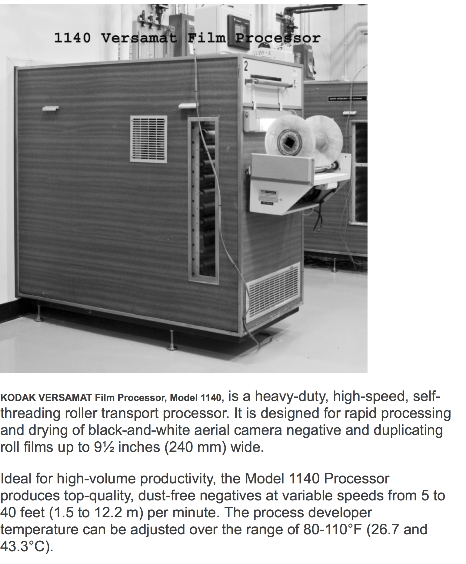

I wonder how people developed film from those giant 200+ exposure magazines!
Some used motion picture labs, that first spliced several such rolls on to a big reel, and then developed the entire reel. Much like was done with 16mm and Super 8 movie film.
Most of those who used 200+ exposure backs were in businesses where they needed several such rolls developed at a time.
ic-racer

I will offer an opinion from a film manufacturer and photoprocessing point of view:
Manufacturers will make what customer want as long as the customer can be successful using the product and there is enough volume.
Film manufacturers coat on very thin PET and spool it and 72 exposures can fit into 135 magazines. For satillite photography Kodak coated 1.2 mil (.0012-inch) on PET film in 9.5-inch by hundreds of feet rolls. Late 1980's satillites cared miles of film.
Cameras can handle 72-exposures but camera counters will not tally beyond 36 unless the counter is reset by opening the back without rewinding. There are stories of PET support stripping the gearing in cameras because if there is a jam the film will not tear.
In the lab it is difficult to overcome the PET core-set so it is very curly before and after processing. You may be able to ease the curl with drying heat but it will still be much curlier than acetate support. Light piping in PET is another problem. Cameras have to be uncompromised for light leaks.
Processing is a whole other complication. Making a stainless reel will accommadate 2x36 length (about 10 feet) that will fit a 8oz tank places the convolutions of film very close together. Obtaining required agitiation is unlikely. The roll could be haved by sacrificing one frame. Handling in a dip-and-dunk commercial process might work but I think the curl will make it nearly impossible to hang the film. It could go through a Kodak Versamat but few exist. Nearly all were made for governments to support aerial photography.
Getting PET film to lay flat in a scanner or enlarger gate may not be possible.
My bottom line is 135-72 is not a useful alternative. If more than 36 exposures are need between re-loads buy a long roll back, use multiple cameras, or some other alternative.
