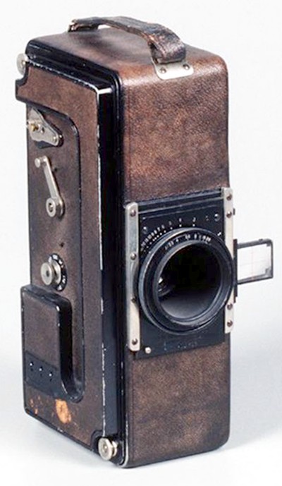

  • Tourist Multiple​
    (1913) The first commercially produced half-frame camera, it took movie film (35mm film) and used it in a still camera. The camera was vertically-styled and looked like a small movie camera. It took a 50 foot spool of film for about 750 exposures. Different lenses were produced from f2.5 to f3.5.

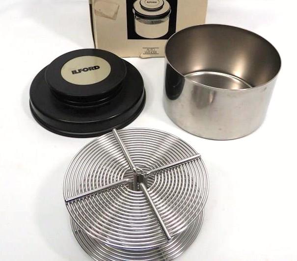

I recently picked up the Ilford Stainless Steel reel for 72 exposure loads.
Now just waiting for the film.

I recall that the 72 exp rolls came up when Simon Gally was still posting, and his remarks indicated that it was NOT a popular product. the blocxk Plastic reel fits in a Stainless tank, and I seem to recall it was loaded Like a SS reel, attch in the center and the film falls into the spiral. the Ilford SS reel had a special oversize SS tank.
the film was coated on a thin Polyester base. so it did like to curl up.
