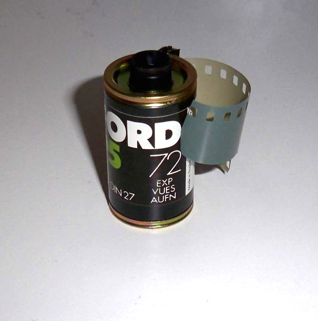

Long time ago, when Ilford marketed the Hp5 72 exp., I thought that a miracle happend and jumped on it as I always had to load the camera when the interesting things happend during a reportage.
Then I realised that I was actually wasting good film with motor driven cameras, as at the end only 5 to 6 photos were usable.

The film is about half as thick as regular 35mm films. Very thin, made specifically for squeezing as much film as possible onto a standard spool.
Standard 36exp. film on classic tri-acetate base with 135 micron thickness is not very tight in the canister.
AFAIK Ilford used 100 micron thick PET base for their former 72exp. HP5+.
And I was told on a former Photokina fair in Cologne by a BW film manufacturer that 100 micron thick PET would be indeed fitting for a 72exp. film in a standard metal film canister.
72exp. film would be perfect for users of the Lomokino camera, and sports and wildlife photographers who wants to use film for certain projects.
Close! Regular 35mm rolls are approximately 0.14mm thick. The 72 expose rolls are 0.06mm thick! While 0.1mm films exist (repacked areal surveillance films are often this thick), it isn’t enough to make 72 exposures fit.

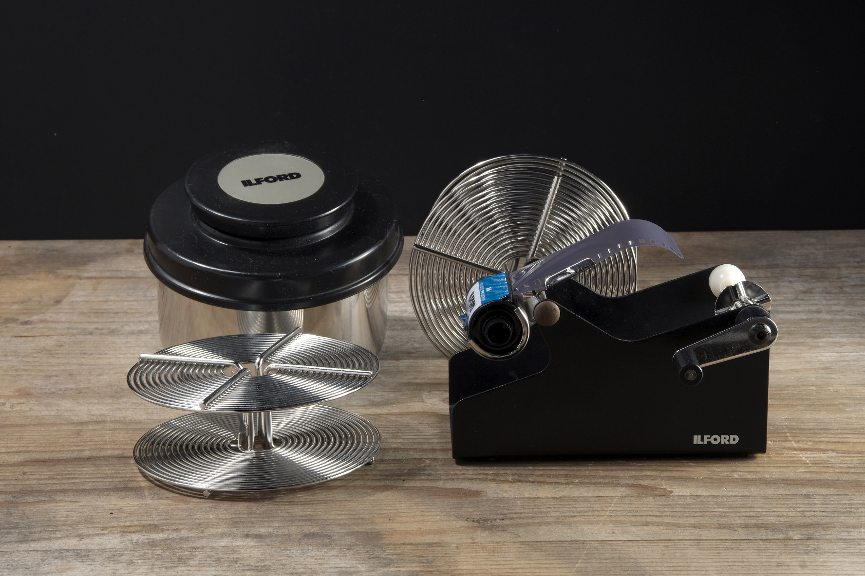

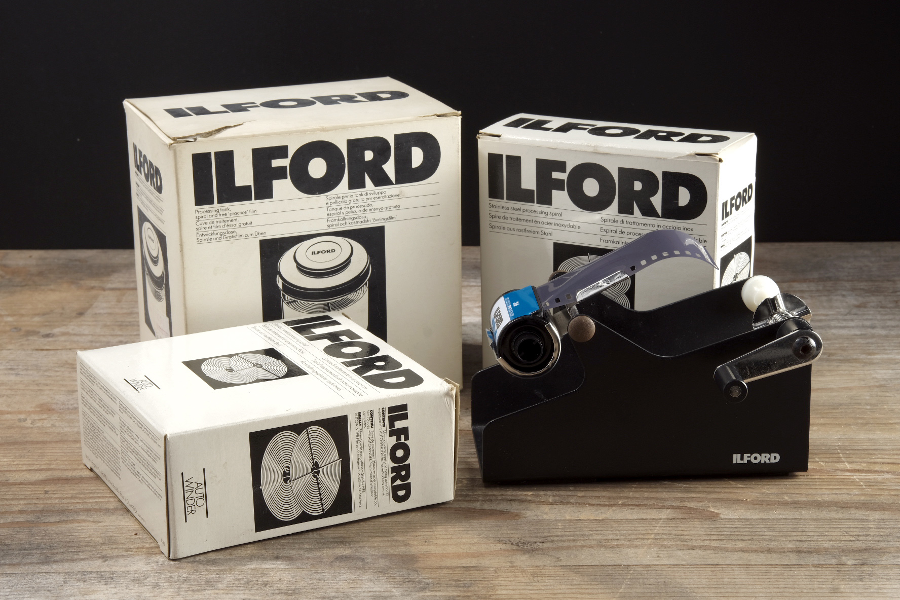

This is what it took to develop these 72 rolls (I sold it too).

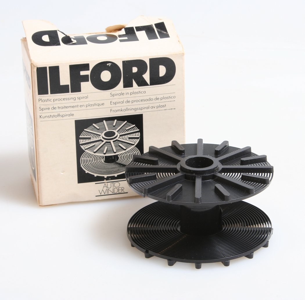

The Ilford plastic 72 exposure spirals are the same diameter as a conventional 36exposure reel. They fit in a 'standard' developing tank.
You mean this:
I wonder how hard that would be to design and 3D print… would just need to figure out how to reliably attatch the film to the center, that isn’t shown well here. I imagine something similar to a Hewes reel could be used?
Yes, I have two of those. But, since I am going to cut the film to hang it to dry, I wound up cutting it half-way during loading, and used two conventional reels.
