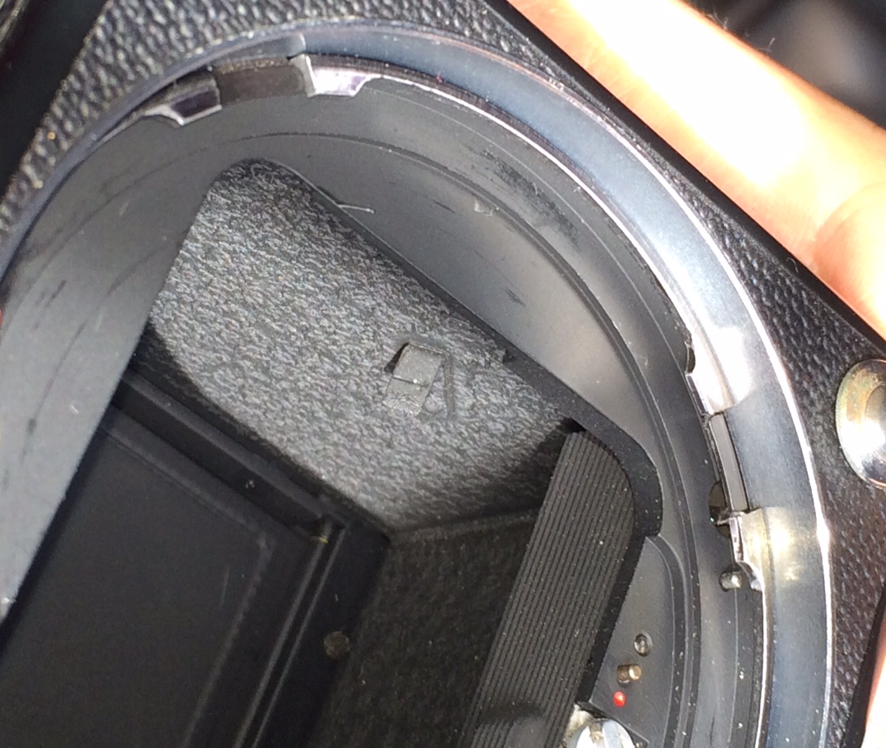

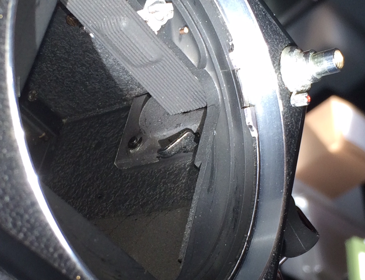

To this point - if I understand correctly, there is no flex. In fact, I don't believe there is any foam on the resting arms below the mirror, IF that is where the foam should be, I must have found the problem. These pictures show the arms when the mirror is up. Should these little rests have foam?
attachment.php
attachment.php
Can anyone tell if this foam is worn down?

How can I check for this? I assume mailing this back to KEH for service would be the best thing to do.
Yes, since it is under warranty.
On my 500C/M and my 501C there is no foam on the little tabs upon which the mirror rests. I didn't look at my 553ELX, but someone already said foam wasn't there either. Perhaps, when APUGuser19 mentioned foam, he was referring to the older 500C.
