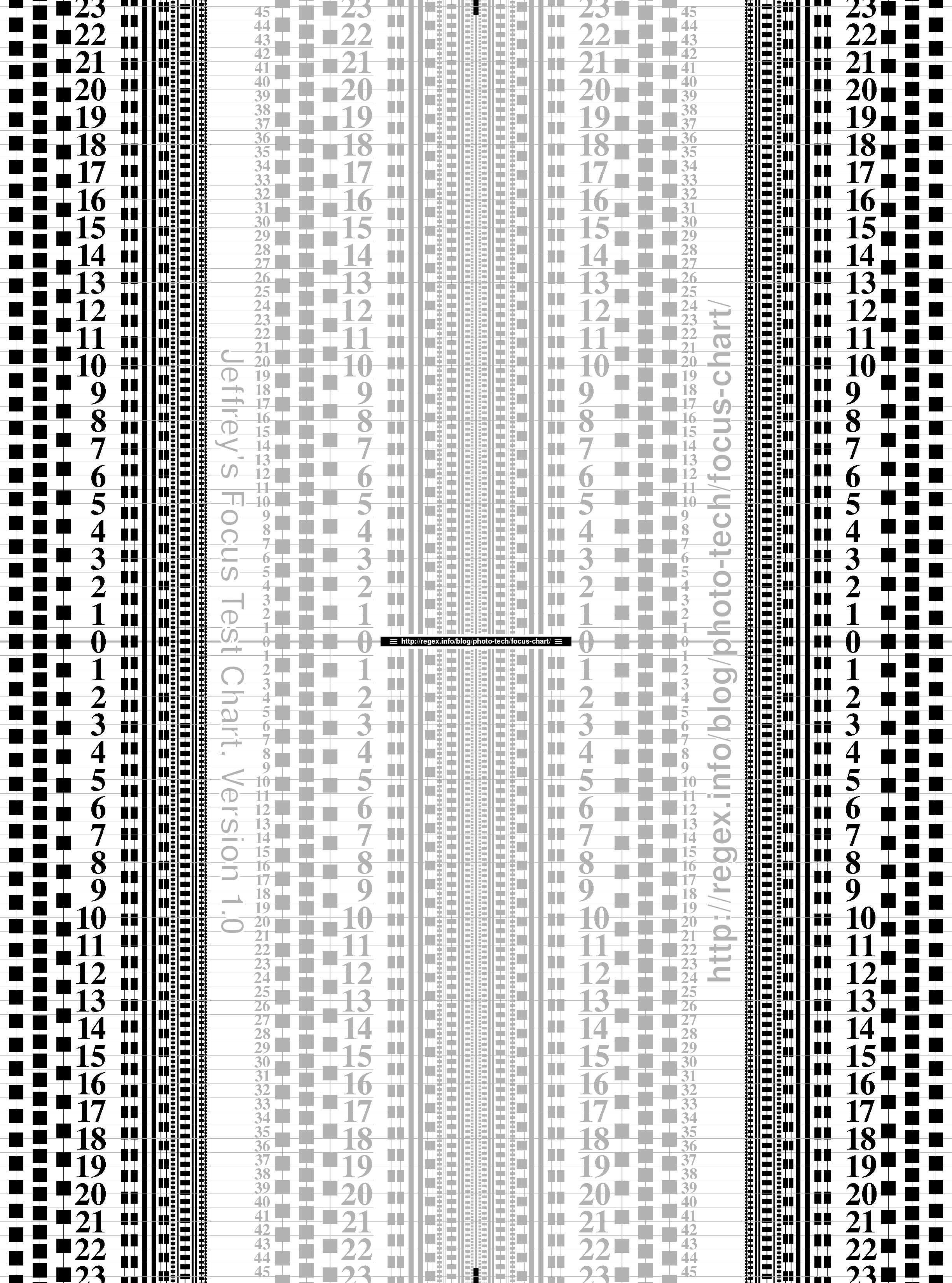

Have you printed out some focus scales and conducted full tests to rule out operator error first?
Try this. Lay it on a table, put your camera at 45 degrees, and focus on the "0".
