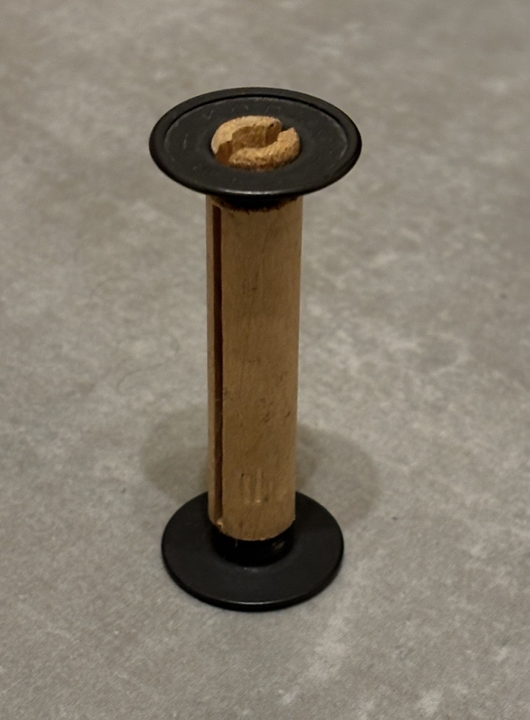

Anybody have an assortment of wood 120 spools they’d be willing to sell?
Thanks!

thank you for your offer! however, i am in need of the wooden dowel ones, because they have a slightly larger diameter compared to the plastic & metal ones. some of my older roll film holders work best with the wooden spool holders and they prevent frame overlap. but i never have enough of them lol

i’d also like to add, i’ve had a similar issue with the Singer Graflok backs…. i prefer to use the metal 120 spools for those. the new style plastic spool tends to cause overlap of frame 1-2-3, where exposure 2 is sandwiched in the middle of exposure 1 & 3.

A tricky thing about 3D printing, though, it is very, very difficult to get the flanges light tight. If you don’t mind not being able to load in daylight, and having to store the film in light tight containers, it works just fine, but that also defeats the purpose of roll film IMO…
I kinda loaded up the truck with Olde Wooden 120 Spools several years ago. Now I see a few, they are $10 each or more. I have zero interest in 3D Printed (in this case) or Olde All Metal Ones (which I have not tested). With tax and shipping you're nearing $20/spool. Antique Auction type stuff so priced thusly.
These Olde Plaubel Makina 120 Backs were made when film came on wooden spools. To me this is not a thinking outside the box situation. Original Spool seem to work pretty good. Less Overlap which can be bad with Plaubel. Test your backs well ahead of shooting anything important! The most important frames are the ones with overlap. LOL
Also I check the backs for overlap with dummy roll respooled and Sharpie Marker. This saves wasting film and shots. I only load backs that have been checked out this way.

That I haven't noticed, I do have a few more modern backs. When they switched to metal spools on roll film I do not know. It may also depend on how many rolls each back has been run through. Paul Ebel worked on some of my backs when I first got them.
