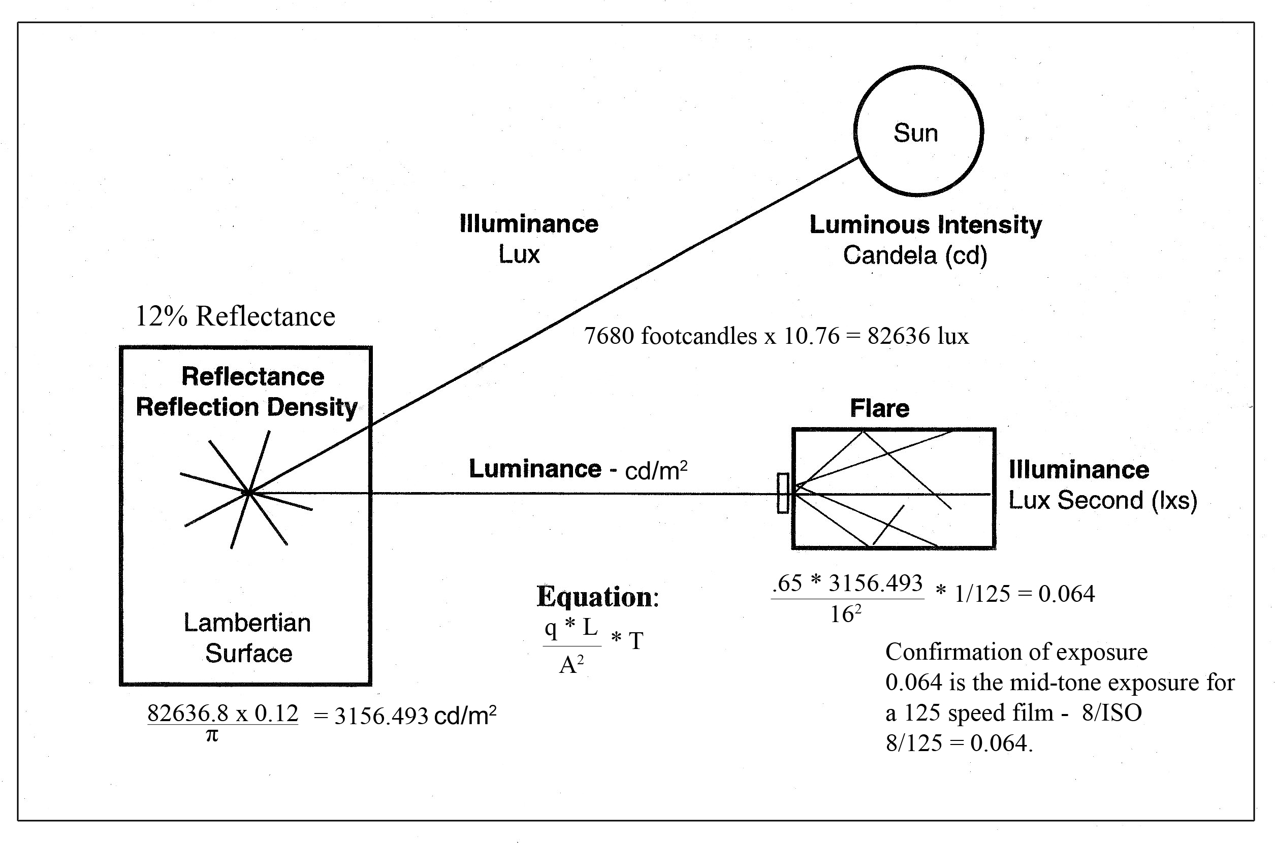

This is from Jack Holm's paper Exposure Speed Relations and Tone Reproduction.
MI = Exposure Meter Index.
<Hg> = statistically average film plane mean exposure (lux-seconds)
H18% = film plane midtone exposure (lux-seconds)
<Lg> = statistically average scene mean luminance (candelas per square meter)
r = Lambertian (perfectly diffusing) surface reflectance
E = Scene illuminance (lux)
Holms uses 128% for highlight reflectance for the paper. Most sources use 100% reflectance. "These values result in the mean luminance correlating with a Lambertian scene reflectance of 12% for 100% highlight reflectance or 14% for 128% highlight reflectance." So his one third stop lighter than average would be 1/2 stop if 100% reflectance was used for the highlight making the calibration average luminance 12%.

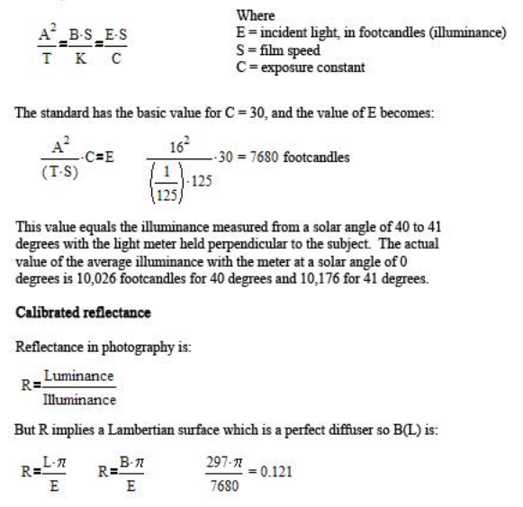

Equation 10:
t = shutter speed
A = lens f/ number
K = exposure meter equation constant (luminance or reflected metering)
EI = Exposure meter Index

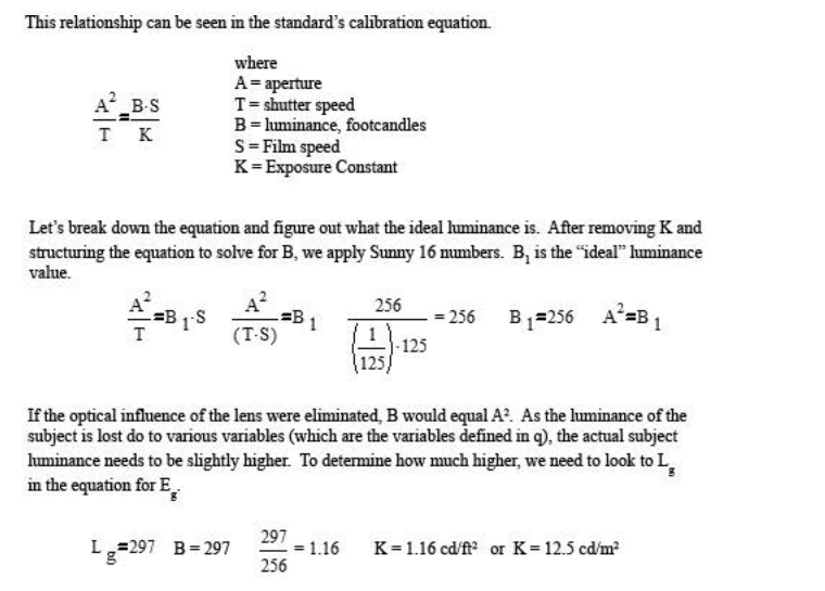

Equation 10:
t = shutter speed
A = lens f/ number

It's the explanation behind the use. Instead of just making a claim, I've included the proof. The diagram illustrates it. Conclusion, the exposure meter isn't calibrated to 18%, but you can use an 18% gray card to make an exposure.
Just how many commercial gray cards equate to a Lambertian surface anyway? Probably zero. That's why it's "Fuzzy Math".

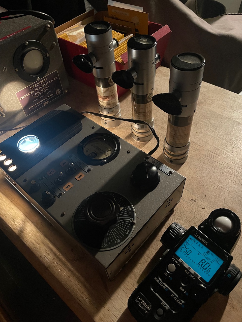

Tried to meter the moon the other day.
At first I thought it might be 250 candles per square foot so I went to test that assumption.
Setup this contraption, a tungsten light source with Kopp 5900 blue filter. Set the Sekonic L-758DR to ASA 100 and 1/250 and cranked up the light until it read f/10.
Dialed SEI photometers to match the light source. Then compared them to the moon.
The moon was less luminous by about two-third stops. About 160 candles per square foot.
-The moon is an object lit by the sun so it should be “Sunny 16”.
-Sunny 16 is 250 candles per square foot.
-But not at 18%, more like 12%.
-The moon has about 12% albedo.
-So the moon should be 250 candles per square foot.
Why is it closer to 160 candles per square foot?

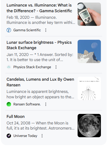

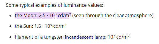

I just got the value off a Google search.
Encyclopedia RP Photonics
The Moon 2500 cd/m2 or 232 cd/ft2
Google AI
The luminance of the full Moon is approximately 232.25 cd/ft². The luminance can vary depending on atmospheric conditions.
Conversion to cd/ft²
The luminance of the full Moon is most often cited in candelas per square meter (cd/m²), the standard international unit of luminance.
  • Typical value: 2,500 cd/m².
  • Conversion factor: 1 cd/m² is equal to about 0.0929 cd/ft².
  • Calculation: 2,500 cd/m² × 0.0929 cd/ft² per cd/m² ≈ 232.25 cd/ft².

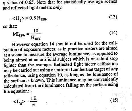

Meters are calibrated to Luminance not a Reflectance. However, depending on the what the highlight Reflectance is based, a Reflectance can be applied.
From Jack Holm, "That the mean log luminance of a statistically average scene is approximately 0.95 log units below the highlight log luminance (edge of detail in white) and 1.25 log units above the shadow log luminance (edge of detail in black), and that this mean luminance is assumed to be the luminance metered, directly or indirectly, for exposure determination. These values result in the mean luminance correlating with a Lambertian scene reflectance of 12% for 100% highlight reflectance or 14% for 128% highlight reflectance. Values ranging from 10 to 18% have resulted from various experimental determinations."

I think you're mixing foot candle and candela per square foot. As stated sunny 16 is an illuminance measurement in foot candle the refectance is not a factor. The brightness of the moon as seen from earth is a luminance meauserment in cadela per square foot and it does depends on the reflectance of the moon surface. The moon is said to have the reflectance of about 12%.
