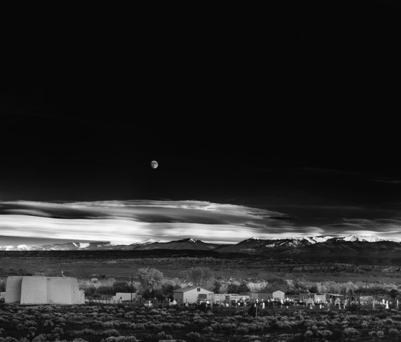

I agree with you. But the story is how Adams used his knowledge of the moon's light to calculate in his head an approximate best exposure for the shot. If he didn't want to clip the moon and overexpose, using a form of the Sunny 16 could get him in the ballpark.
What calculation did Adams actually make to determine his exposure?

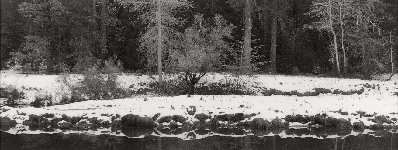

Selectively selenium toned, actually (so half of the neg was exposed 'properly', I suppose). I shamelessly stole the idea from him for the below image (top half of 4x10 negaitive toned.)

Informed, skilled opinions vary greatly on the quality of Adams' works and his methodology, many works of which have been exhibited here in Australia over the decades.
Moonrise over Hernandez, NM (c.) 1941 never struck me as a fine art print or a photograph that had been effectively printed to speak to the viewer; notwithstanding Adams' skill of elaborate estimation of the absence of a meter and the stand-in mental gymnastics, and then the printing procedure, Moonrise' is not a print that particularly enthralled me, or many other practitioners in LF colour or monochrome practice. My chief gripe is the extreme contrast and what some people assert is the wrong lens for the job — that is to say, could the scene have been improved by by a longer lens, compression and elimination of floss? Adams' admission that he has, over the years, intensified the look of the image does not do the photograph or the photographer any great favour — essentially, the image is very stark and confronting, a turn-off if you will. Many examples of his work are high to very high in contrast and realistically, suited to that entrenched oeuvre, but others just do not resonate well. Moonrise' is one of them.
First of all, "Sunny 16" would have been a disaster with that image. Regardless of what people like or dislike about Moonrise Hernandez, it remains the most famous image by the most famous photographer ever. Ironically, the older version prints prior to intensification sell for the highest prices because there are far less of them, and they're also more "vintage".
But the intensification wasn't just for sake of a more dramatic composition with a blacker sky. The fact is, the original water bath development of the neg produced a rather blotchy unevenly developed sky very difficult to print and touch up. But by selenium intensifying the foreground where it was needed, more overall contrast could be applied to the entire scene; and with the low values in the sky going nearly black, most of its inconsistencies weren't evident anymore.
There are other famous images of his where that black sky or even black hillside strategy was employed to disguise flawed areas of the negative. And many people do gravitate toward that more theatrical Wagnerian mode of presentation. But that style is actually represented by just a minority of images in his overall career. The dramatic black sky ones make better selling postcards, I guess.
I took a quite analogous shot with the moon rising above spectacular clouds over the Great Salt Lake pan, with wonderful reflections in the water alongside gleaming white foreground salt deposits, yet in low value evening light. And I had to shoot it just as quickly because the position and even appearance of the moon was unexpected and quite brief. What a tremendous difference our modern superb VC papers make, simplifying these kinds of problems! And as far as exposure, my Pentax spotmeter made all of that simple and fast too. I printed it on MGWT; and it was an inherently dramatic scene.
But I didn't want to overprint that, and wanted to leave a little flexibility in it for sake of some subtle split toning effect using both gold chloride cold toner and a hint of highlight apricot from sulfide Kodak Brown Toner.

Hernandez was dodged and burned to death in the darkroom 🙃 What is seen by public is pretty much NOT what negative looked like.

Had nothing to do with the Sunny 16 rule. That whole Hernandez picture was a Hail Mary pass based upon a reasonable guesstimate, and then consigned to water bath development, which doesn't work with current thin emulsion films, and worked only so-so back then. The resultant negative was a mess, but salvageable.
