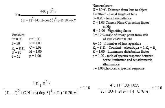

Adams couldn't have been more wrong. That is not what the K factor is or does.
This is K. It's a constant that combines certain variables associated with the meter and the camera constant of q, which is the variable representing the light loss of the camera system. Through the lens metering doesn't need q, it just reads the actual illuminance, but still requires a value of K for the metering system.
1.16 cd/ft2 or 12.5 cd/m2

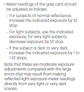

Kodak's instructions (link in post #47) illustrate the complications involved when using a gray card. The first complication is trying to estimate an angle that is 1/3 of the total angle between the subject and the primary light source. Some people have "perfect pitch" -- the ability to accurately identify certain audio frequencies. What I do not have is "perfect protractor" -- the ability to accurately visualize angles in 3D space. (Probably why I am no good with a pool cue.)
And then there are the rules for when to adjust the gray card reading.
The first adjustment rule is: "For subjects of normal reflectance, increase the indicated exposure by 1⁄2 stop." I've never really understood the rationale behind this suggestion. I assume the 1/2-stop additional exposure is necessary because 18% is not the correct reflectance to represent the average reflectance of a normal scene?
Due to the high cost of Kodak brand gray cards, I was tempted into buying some Delta brand gray cards at a much lower cost. Delta advertises the same specifications as Kodak, 18% gray, plus or minus 1%. However the Delta instructions are slightly different. Delta says the correct angle is "halfway between the main light and the camera." And Delta does not suggest adding 1/2 stop exposure to normal subjects.
I still carry a Kodak gray card, but I rarely use it. For most subjects and conditions, my built-in camera meters are adequate - if used with good judgement. If I want a second opinion in difficult lighting, then an incident meter does pretty much the same thing as a gray card, and it is less fussy to use.

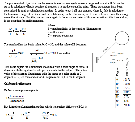

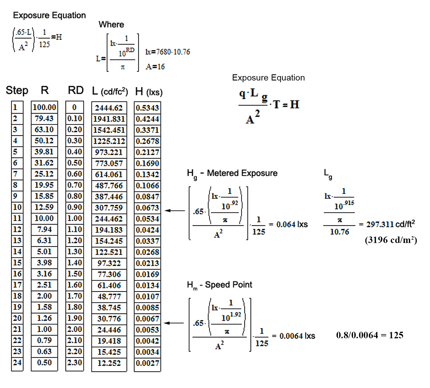

There was a discussion many years ago on K. I was writing my tone reproduction program at the time and steeped in theory, so I did a series of posts and later put them together as Defining K. Available Here.
Here is an excerpt that addresses your query. Sorry about the use of older nomenclature.
Here is the camera exposure based on the values defined above for a statistically average luminance range of 2.20. Flare is not included. Notice the Reflectance for Hg, metered exposure (12%). 18% is 1/2 stop above that point.
So your meter is calibrated for K=12.5. Ansel was wrong but his argument is that his EV0 is 1cd/ft^2 which is the same as K10.7. But he said since his stuff is based on 1Cd/ft^2 he used no K factor. Doing so his meter read about 0.4 stop low which is about the same as the Weston meter. By the way he was also wrong in calling it foot candle which is an illumiance measurement (which by the way he didn't care for) he only cared for the luminance.
