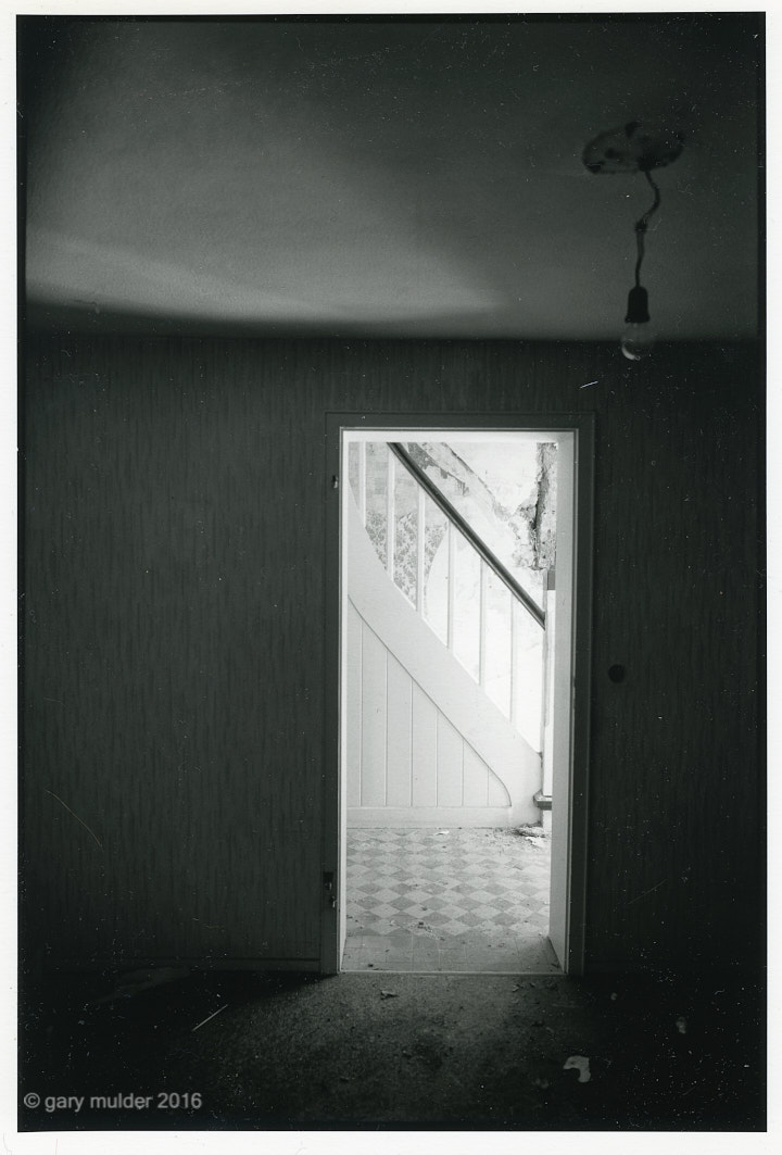

from my experience, the Nikon matrix metering is extremely accurate. I doubt that the use of a gray card, in your case, will improve the technical quality of your images. I'd trust Nikon matrix metering in almost all cases.
This shot was taken with Nikon matrix metering in Program mode. Scan from FB print. Camera Nikon F6 , Film T-max 100, developed in FX-37.

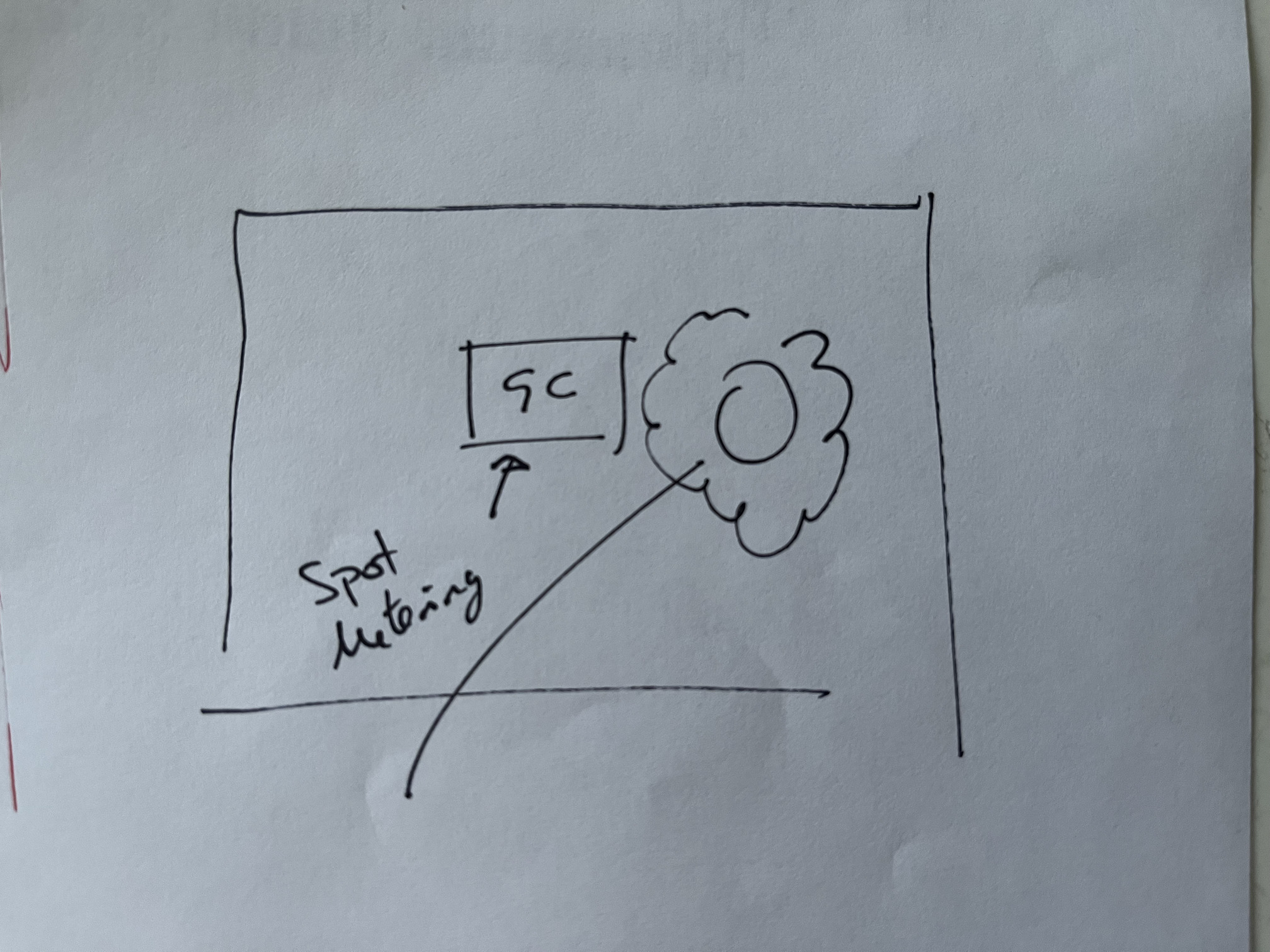

Nikon F100 with spot metering selected. A gray card right next to a flower. The center is where the camera meters spot also where the grey card is. For the example, the photo uploaded.
Not shown:
* light source(s), nature and directionality
* angle between greycard and line of camera/sight
* information on surface of greycard; i.e. how shiny/matte is it?
If you put a grey card somewhere in a scene and angle the camera in different ways at it, it's perfectly easy to end up with meter readings that are all over the place, depending on how the scene is illuminated.

Light source: The sun (sunny day), left corner up. The sun iluminates the flower from the left.
Angle between graycard and camera sight. Both parallel. The light incides a little from the left.
Surface, matte.
@koraks about: "If you put a grey card somewhere in a scene and angle the camera in different ways at it, it's perfectly easy to end up with meter readings that are all over the place, depending on how the scene is illuminated" It is a heache, not practical. I will have to use the matrix mode of the camera and do bracketing.
This post is not for a particular scene. I wanted to know the experience from people, what was the use and if really matter today with "new"color negative films.
That is fine except that as someone said if you angle the card you get different readings. The gray card when use straight on to the camera then it's good for flat object. For 3 dimensional object you need to angle it toward the light source to simulate the effect of the dome on an incident meter.
koraks
Nov 29, 2018
27,855
Europe
OK, in that case - I just use whatever metering system the camera has, use it sensibly and generally don't have any problems with exposure. If I use a camera without inbuilt meter, I use a handheld meter, either incident or spot. I never carry a grey card and I've never felt the need to do so. I don't think doing so would somehow improve the photos I make.
