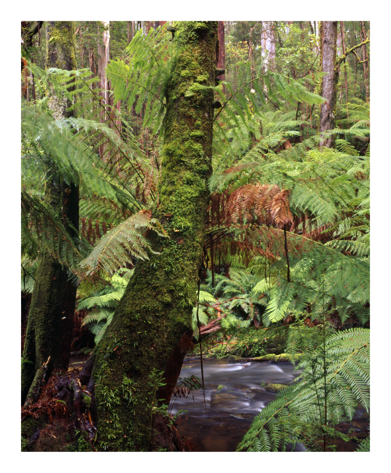

I am patient enough to take notes of what the scene presented to me if the lighting is not right, and plan to return when the lighting is right. To that end, I enjoy, very much, shooting in diffuse/overcast/flat light (even rain is pleasant) — I leave the crappy shots in bright light to playing with my vintage Olympus XA loaded with Provia 100F. It is not impossible to photograph a high contrast scene and lose either highlights or shadows,. but it requires a lot of judgement, care and experience, and even when all the crumbs of the cookie line up, sh!t happens. Duplex metering of several areas of highlights and shadows and then balancing against a grey card has worked for me many times. Next April I will be on an artist-in-resident in western Tasmania, in the famed Takanya/Tarkine Rainforest, SW of Waratah, shooting-to-exhibit (with a group). I expect in April to get days of bright sunshine that will pose a challenge, days more of rain and cold, and a couple of days when everything works out just so! I'm probably the fastest and most fluent with a multispot meter over my other large format comrades using incident meters (shudder).
This scene below is one that on two occasions in high summer was bathed in the hot white glare of the sun bursting through the forest crown. The creek behind was barely running, so no problem with spectrals, but there were deep, dark shadows and rapidly changing light. Amazing what happens when you come back in winter and are presented with an entirely more favourable subject and a resultant exposure!

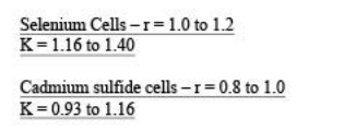

I should have been more clear. What I was referring to was Adams mistakenly thinking the K factor was an adjustment to exposure. It's not. It's an internal calibration of the exposure meter to adjust for among other things:
R = Luminance distribution factor
p = ratio of spectra distribution between scene Luminance and sensitometric Illuminance
r = photocell's spectral response
Example:
Example:

Well, it was only an example of how the spectral sensitivity of the photocell can affect the value of K and evidence how K is a meter calibration constant and not an exposure adjustment. It wasn't intended to be a comprehensive review of all meters. In The Negative, Adams makes K sound like a conspiracy by the manufacturers.
