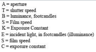

The equation below is the reflected and incident exposure meter calibration equation. On the left is the camera setting, the middle is the calibration equation for the reflective exposure meter that is concerned with the Luminance of a subject and film speed, and the right equation is the calibration equation for the incident exposure meter with the scene Illuminance and the film speed.
By using the Sunny 16 rule where f/16 at 1/film speed is the exposure, it’s easy to determine the Luminance and Illuminance values, since under the Sunny 16 rule, the shutter speed and film speed cancel each other out, we are only left with a few variables. The variables K and C are known for their base value of 1.16 cd/ft2 and 30 footcandles. To convert to meters, just multiply by 10.76.
What we get is the Luminance value for f/16 at 1/film speed is:

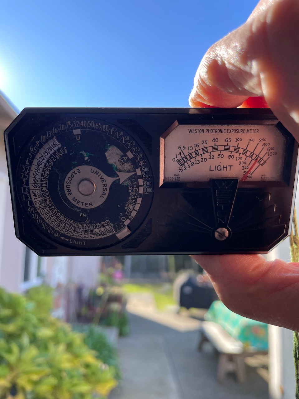

If you were looking at my photo, that’s f/10. I got f/8.6 where the decimal unit of the Sekonic is tenths of a whole stop, (f/8.3 = f/9 and f/8.6 = f/10).

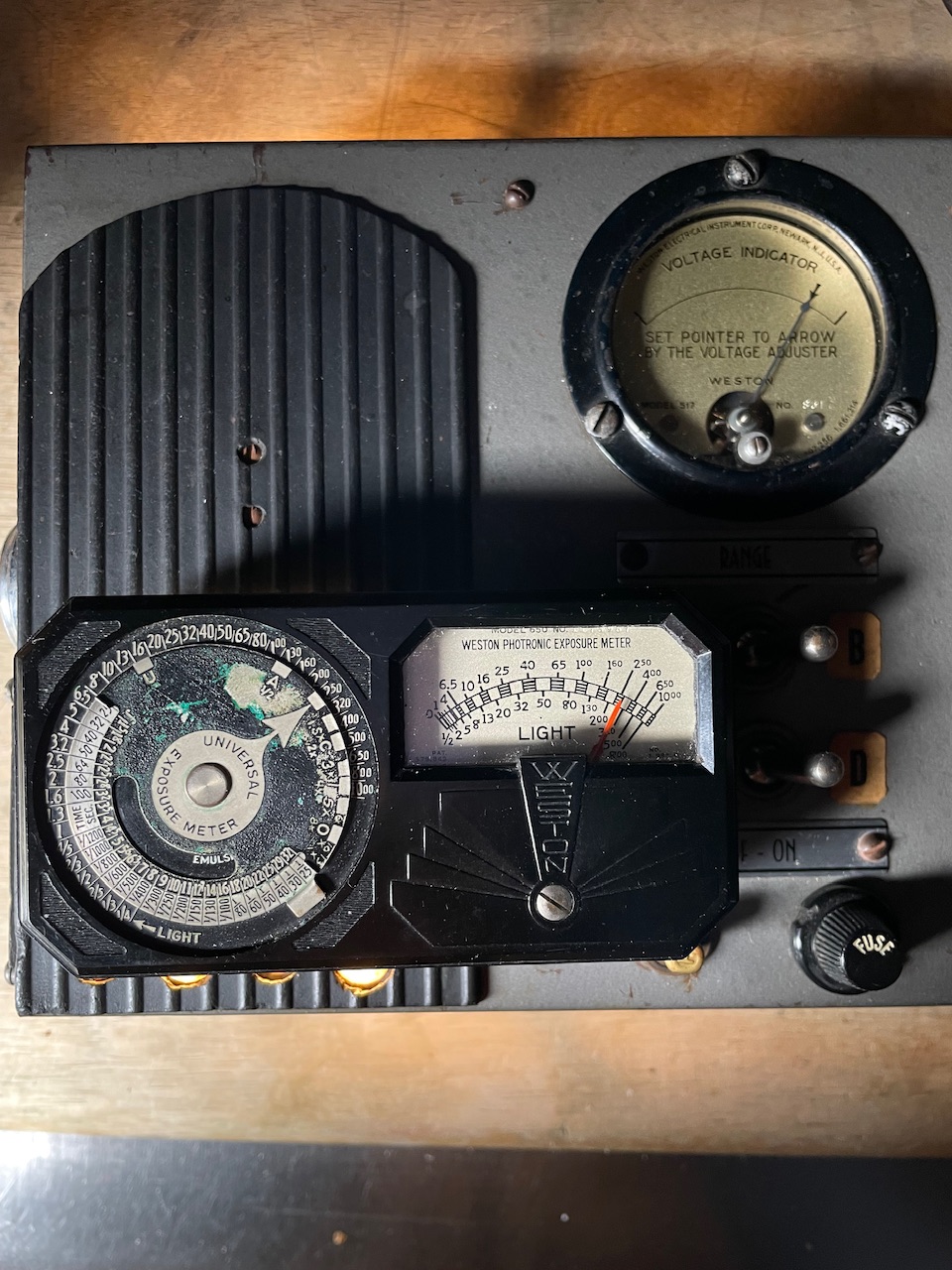

Hi Bill. Forgive my ignorance, but how are you measuring the moon with a Weston meter?

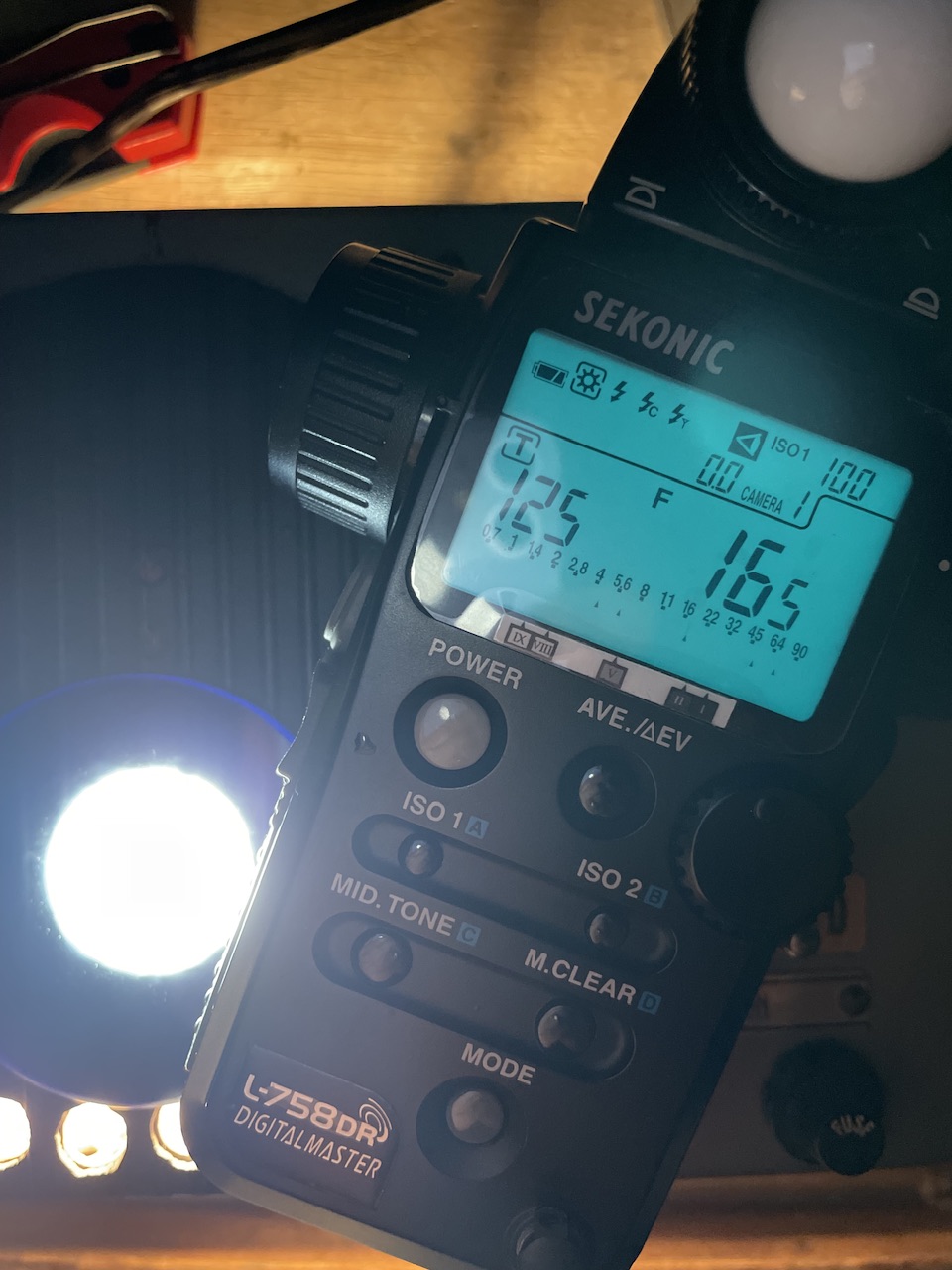

By transferring SEI photometer readings to a variable light source and then reading the light source.
Really I use the Sekonic L-758DR for the readings. (This Weston isn’t yet calibrated, I just cheated and dialed it to 250 for purpose of illustration).

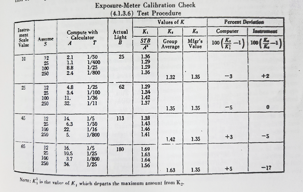

Bill, you might find these two sources useful. They are from around the time the meter was manufactured.
The copy of Joint Army-Navy Specifications, JAN-N-58, 15 September 1944, Meters, Photographic (Reflected-Light, Photoelectric Type) Standard, Army Number 75-388, Navy Number 18M12 shows the calibration as:
The ASA Z38.236-1948 General Purpose Photographic Exposure Meters (Photoelectric Type) has the calibration as:
K being between 1 and 1.35 inclusively. And the Exposure-Meter Calibration Check table.

Last night’s [04-DEC-2025] moon was more luminous than I expected. Used SEI photometer to dial in a match to the moon. Added Kopp 5900 blue filter to variable light source and dialed the light to match the SEI (not using SEI scales, just using it to match), then read the light with Sekonic L-758DR spotmeter.
Transferred the reading to Weston Photronic by dialing in 1/130 and f/19 and to use a higher K, I moved the Emulsion Speed to a half-position between 64 and 80.
Looks like 500 candles per square foot.
