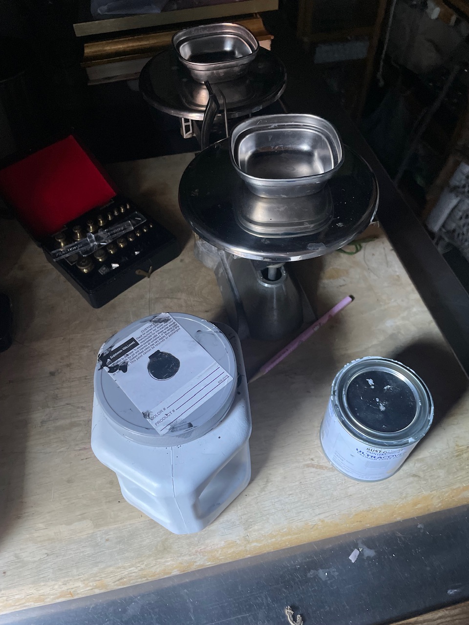

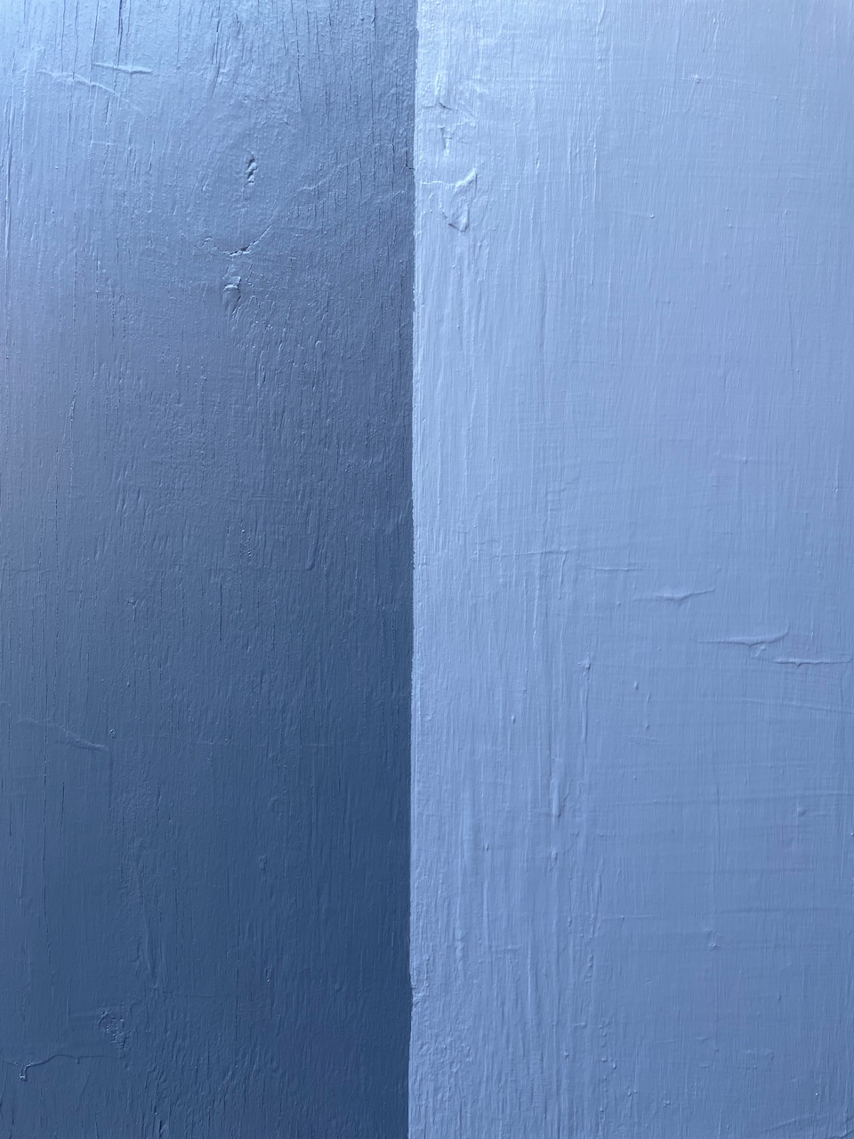

I’ve had a two-tone “Minor White” target for years and it was faded badly, so I repainted it.
The two tones are meant to read on an exposure meter as one stop apart.

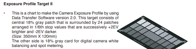

The two tones could be anything as long as they read out a stop difference. Copied from a Sekonic test target that has seven patches around 18% in sixth stop differences. The tones I picked are 25.5% and 12.7% reflectance. This is a half stop below and above 18%. In terms of density I was shooting for 0.90 and 0.60 which is obviously 0.30 apart and should meet the requirements.
When the densitometer said I met the specifications the exposure meters disagreed. So I held the 0.90 and increased the reflectance of the lighter side of the target taking half milligrams of black out of the mix, painting, waiting fir it to dry and trying again until the meters showed a full stop.
I had to go down to 0.56 on the light side.
Still, to see a full stop difference I need to aim down to minimize sheen. When I do that the Sekonic L-758DR will show between 0.9 to 1.1 stop difference. Not reliably a full stop.
Anecdotally we’ve said that an incident meter would agree with a spotmeter reading from a 12.7% reflectance target.
Even with this target I cannot replicate that story. It’s not agreeing.

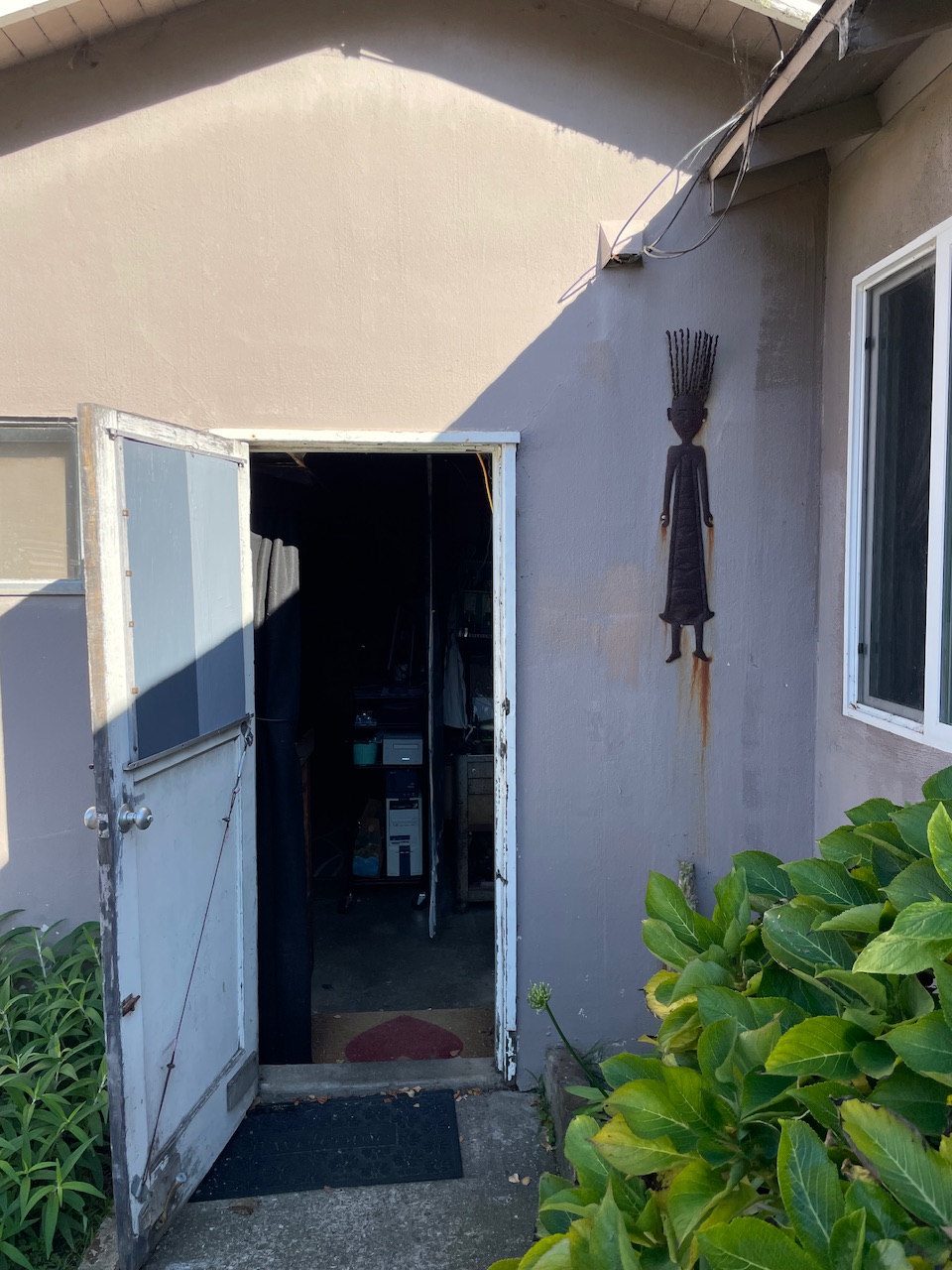

With Sekonic L-758DR in my garage door test location at the northwest side of the house target lit by the sun wall in the shade…
In the shade, spotmeter reading of the light 25.5% target matches the incident reading with dome (3D) which sees more sky when it’s up and 12.7% reflectance matches with dome retracted (flat) because the sky is shaded. Incident reading changes by a full stop depending on on whether the dome is up or retracted.
In the sun, the dome and flat readings are both the same and match the dark 12.7% reflectance target.

You might be thinking of the calibration constants, which are not the same thing. From the Sekonic's L758D/DR users manual.
The manual did have an interesting feature.
