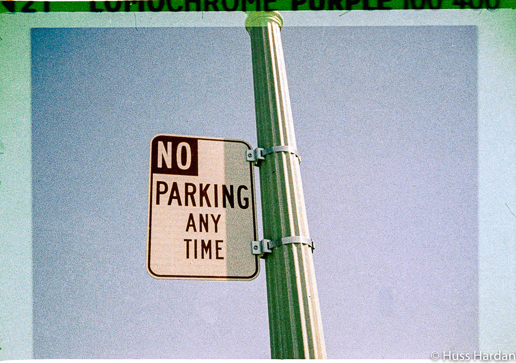

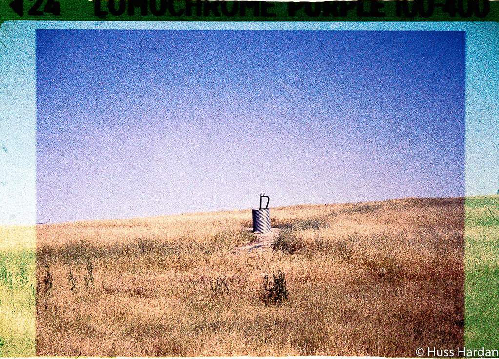

The greenish border with detail is actually the picture 'bleeding' over - apparently 110 can cover more area than what is allotted.
Correct -- though it varies between cameras, most can cover at least 13x18, while the pre-exposed frame on commercial film is 12x17mm. I don't know what the reason was behind the pre-exposed frame; it originated on 126 (828 had the same perf setup that carried over to 126, but didn't have the frames exposed on the film).

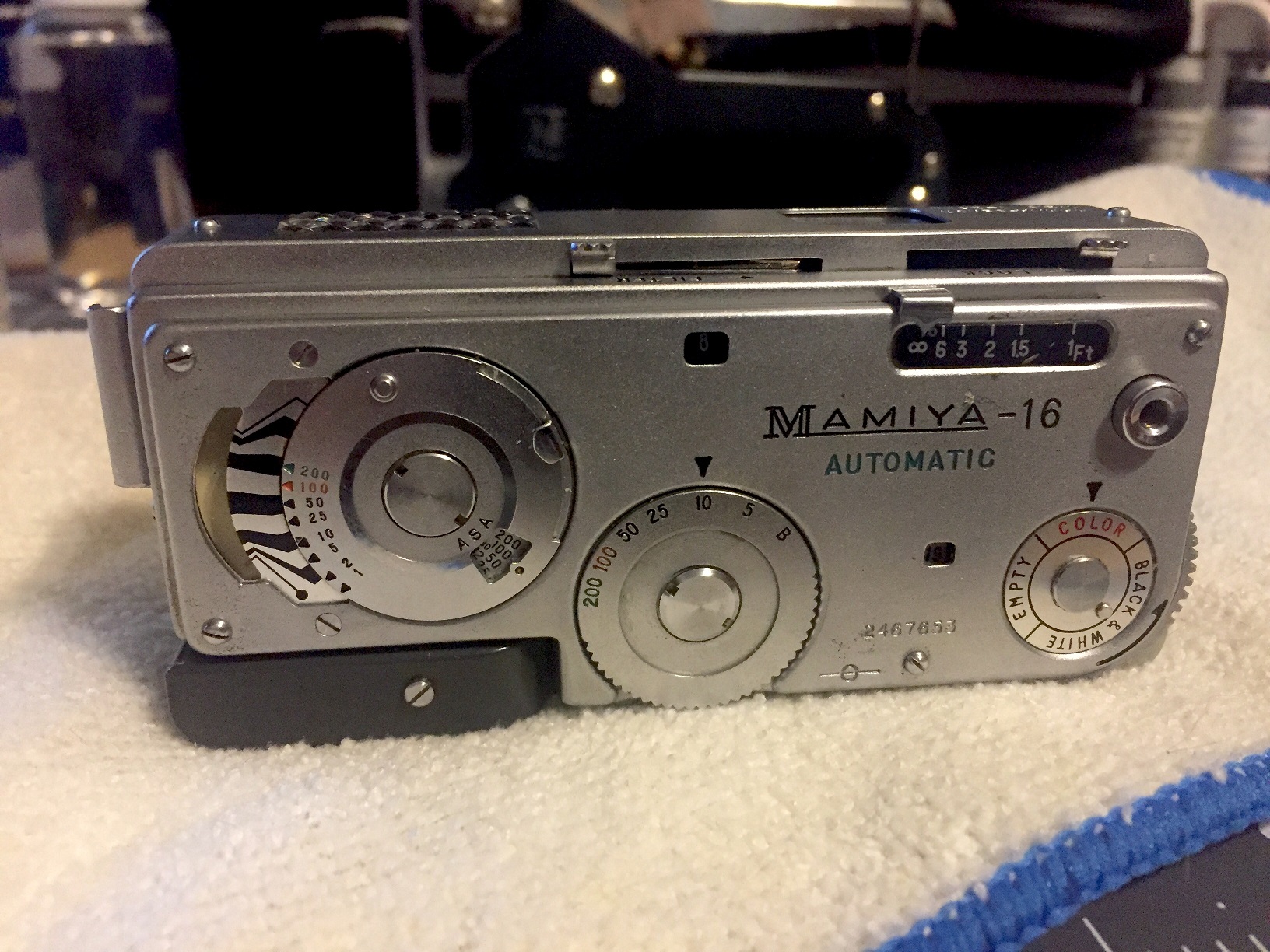

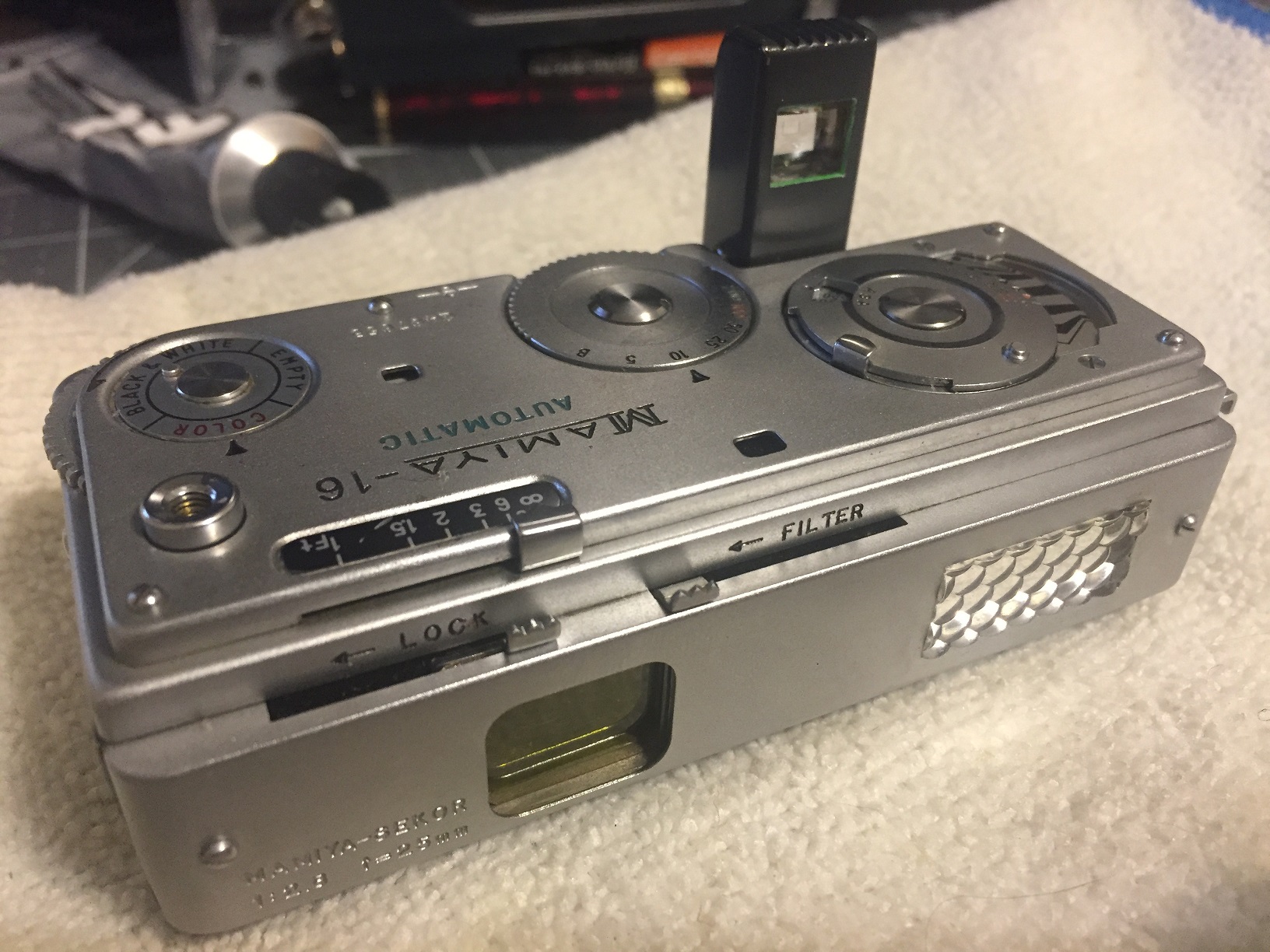

Found a nice Mamiya 16 Automatic camera today at a junk shop. It cleaned up nicely but the meter is dead. No real problem, as it has fully manual controls. Now I have to scrounge a couple of film magazines. I have a TON of Agfa and Ilford 16mm out of date stock I can use and might invest in a slitter later.
View attachment 273066 View attachment 273067
Great find! I've been hunting for one of these. I'm curious how the lens resolves.
That thing is so sweet looking! Post pics taken with it ASAP!!

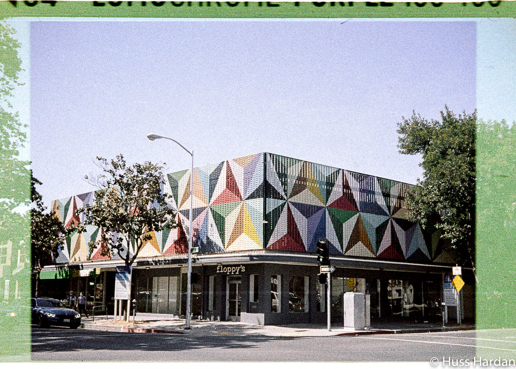

I like to use this building as a test subject, to see how different films treat it as it has multiple colours on it.
Rollei A110, Lomo Mistaken Identity (Metropolis)
