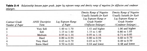

4. Please see the chart above and the table I've uploaded. While matching the NDR to the Paper LER helps match the film to the paper, it doesn't account for the local contrast and how the print tones relate to the original values.

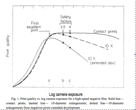

For example my premise is supported in the Nelson paper Safety Factors in Camera Exposure, 1960. There is a graphic indication of the adverse effects of extended development of enlarged rollfilms.
Illustrative curves for two hypothetical films (zero B+F density) with the same ISO speed but different toe shapes.

Well, first, lets leave out contact printing. It does not address flare. All enlarging papers have to address this issue in gauging contrast for normal negatives.
That said, an average grade 2 paper has a mid scale contrast of 2.5 measured using the straight line and centered between a density of 0.8 and 1.0. A paper of 3.0 however, is suggested as being best used as a normal contrast paper if one has a diffusion enlarger. This comes from some of the earliest texts I have.

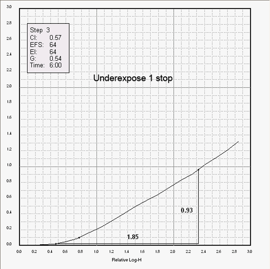

This is how it works. The first example has a CI of 0.56 and the shadow exposure is placed on 0.10 above Fb+f. The NDR is 1.05.
The next example has the same curve but with one stop underexposure which is the same as rating the film at twice the indicated speed. The exposure shifting 0.30 to the left leaves a NDR of 0.93. Underexposure basically reduces the effective log-H range. Instead of a log-H of 1.85 like the normal exposure, the effective log-H range is 1.55.
Extending the development to create a film with a CI 0.61 shifts 0.10 slightly to the left and increased the gradient of the film, so while the shadows remain thinner than a normally exposure negative, the density range is more or less the same but with a log-H range still effectively shorter than with the normal exposure. This is what is known as "pushing for speed."
Some might have noticed that the CI change is not as much as a +1 when compensating for a scene with a stop shorter subject Luminance range. When I was working in a lab, I tried to make a distinction between pushing for speed or contrast, but the customers didn't understand the concept, became suspicious, and refused to cooperate.
I don't think there's any thing special about Grade 2 except it's in the middle.
You will notice in the graph how the degree of enlargement plays a large factor in how quickly image quality falls off with exposure. That is one of the main reasons why the 1960 standard dropped the safety factor effectively increasing film speed, and consequently reducing negative density. Image quality with large format isn't as affected by exposure increases, but the use of smaller formats was on the increase, so film speed was adjusted accordingly.

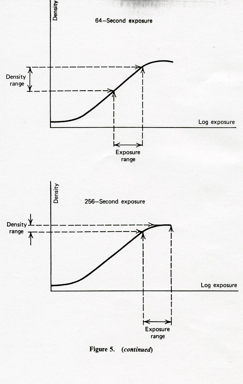

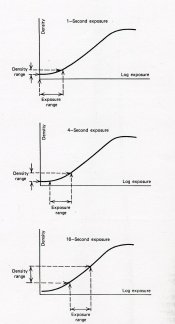

Here's the dilemma or paradox BetterSense is talking about.

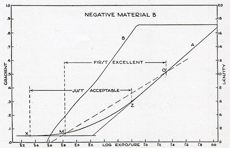

Ron, you misrepresented the conclusions from the "first excellent print." Your statement was about a specific test. It was by Jones. It was psychophysical. It lead to the fractional gradient that places the speed point in the toe. It did not conclude negative exposure needed to avoid the toe. Subsequent tests by other people isn't what your statement was about. My response was only about your statement concerning the first excellent print and nothing else.
Jones' test was called the FIRST excellent print, not the Absolute best excellent print. Quality increased a little with increased exposure and then leveled out. We all make misstatements from time to time. It's only natural with the speed in which these posts are created. I said something about transparencies earlier that wasn't what I meant to say. It's no biggie.
No, I did not. I know what "first excellent print" means and in fact delineate this and related latitude in portions of my book. The first figure shows the first excellent print, but the majority of excellent prints are further up the curve or slightly over exposed from one POV. The second two figures from Haist show the effects of exposure on latitude or the effects on getting an acceptable print. These three figures are all that one needs to understand more fully, neg-pos systems.
PE
Ron, The first graph comes directly from one of the Jones papers connected with the first excellent print test. It shouldn't take me too long to track down the paper and page. Haist must have reprinted it. The other two are familiar but I'm not sure where they are from.
The first of those I cite comes from the work of J. L. Tupper and was published in the '40s IIRC. Both Mees and Haist published variations on the second two from their work in the '40s and '50s. The work published by Mees was also originally done by Tupper and others on Mees staff.
PE
In your diagram, M of "First Excellent"... That's the famous 0.3 times gradient point, right? So "a little bit" on the toe.
